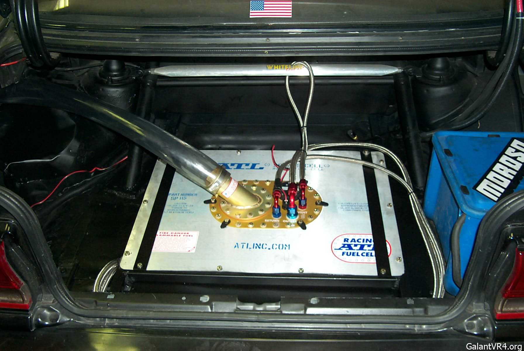

ATL 15 Gallon Fuel Cell w/surge tank and internally mounted Walbro Supra Turbo FP
Aeromotive FPR/Filter with Earls Lines and fittings

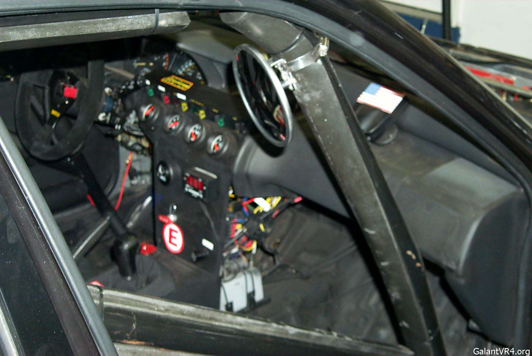

Painless Wiring switch panel w/ keyless ignition
Autometer Racing Tach with Shift light
A-pillar Dual Gauge pod w/
Greddy 60mm Peak & Hold EGT Gauge
Greddy 52mm Boost Gauge
Dawes Multi-colored LED A/F Meter
Autometer Z-series Oil Pressure/Temperature, Fuel Pressure and Water Temp Gauges
ATL Fuel Level Gauge
HKS Turbo Timer
