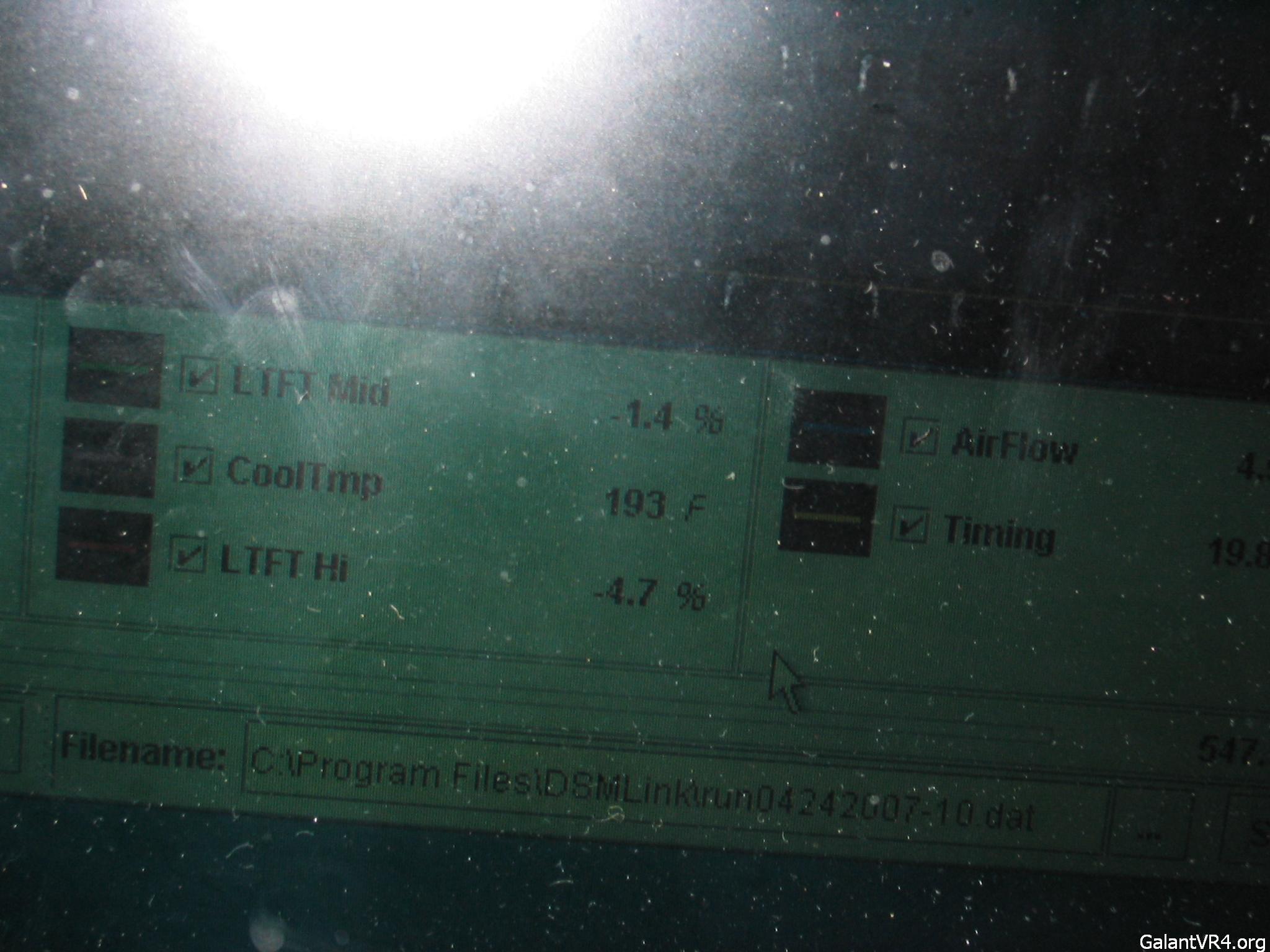

According to DSMLink the car actually runs cooler now.
Temperatures at idle before the civic swap were around 197*-205* and now around 187*-193*.
Cruising before was 190*-193* and now around 179*-183*.

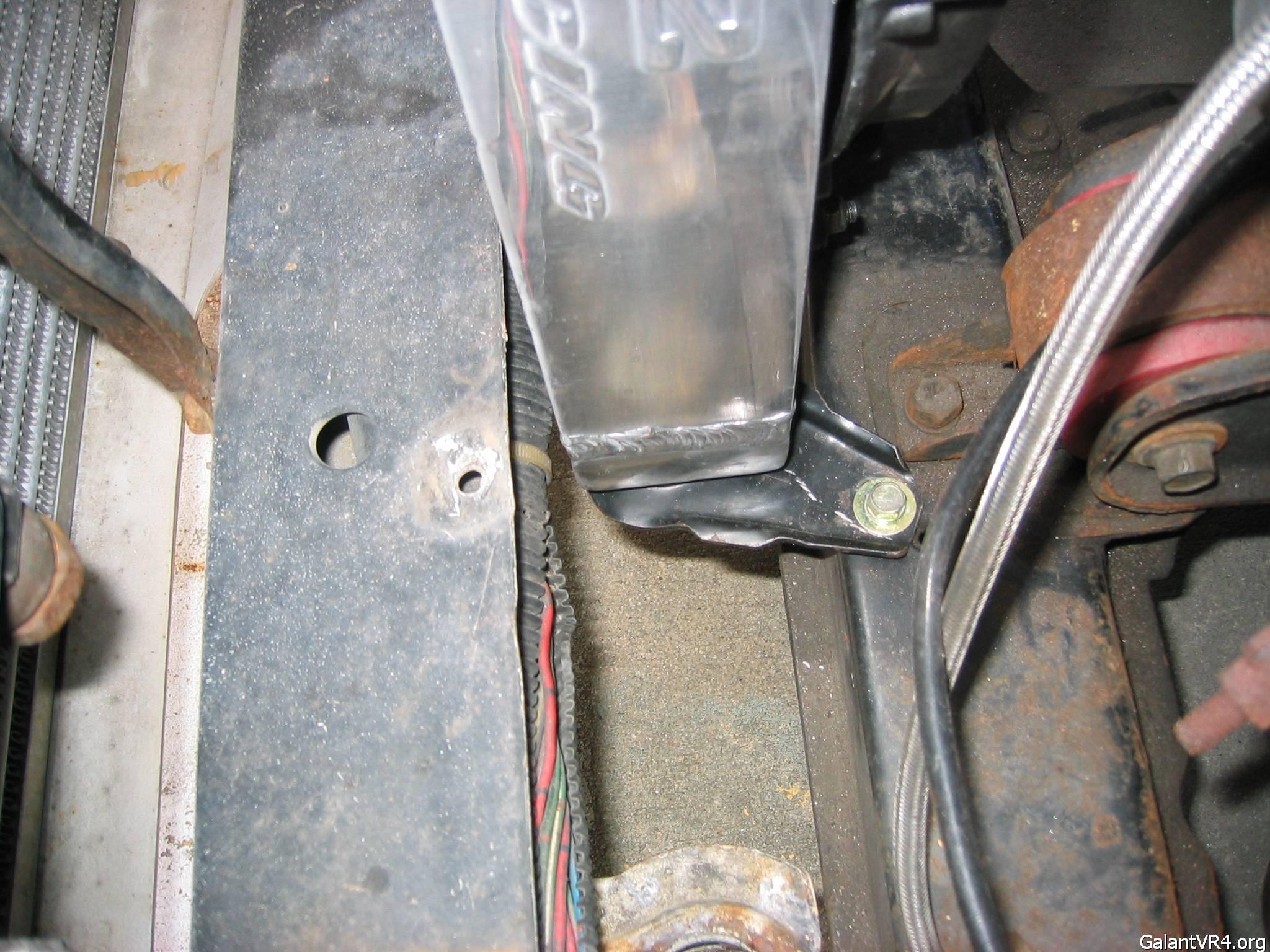

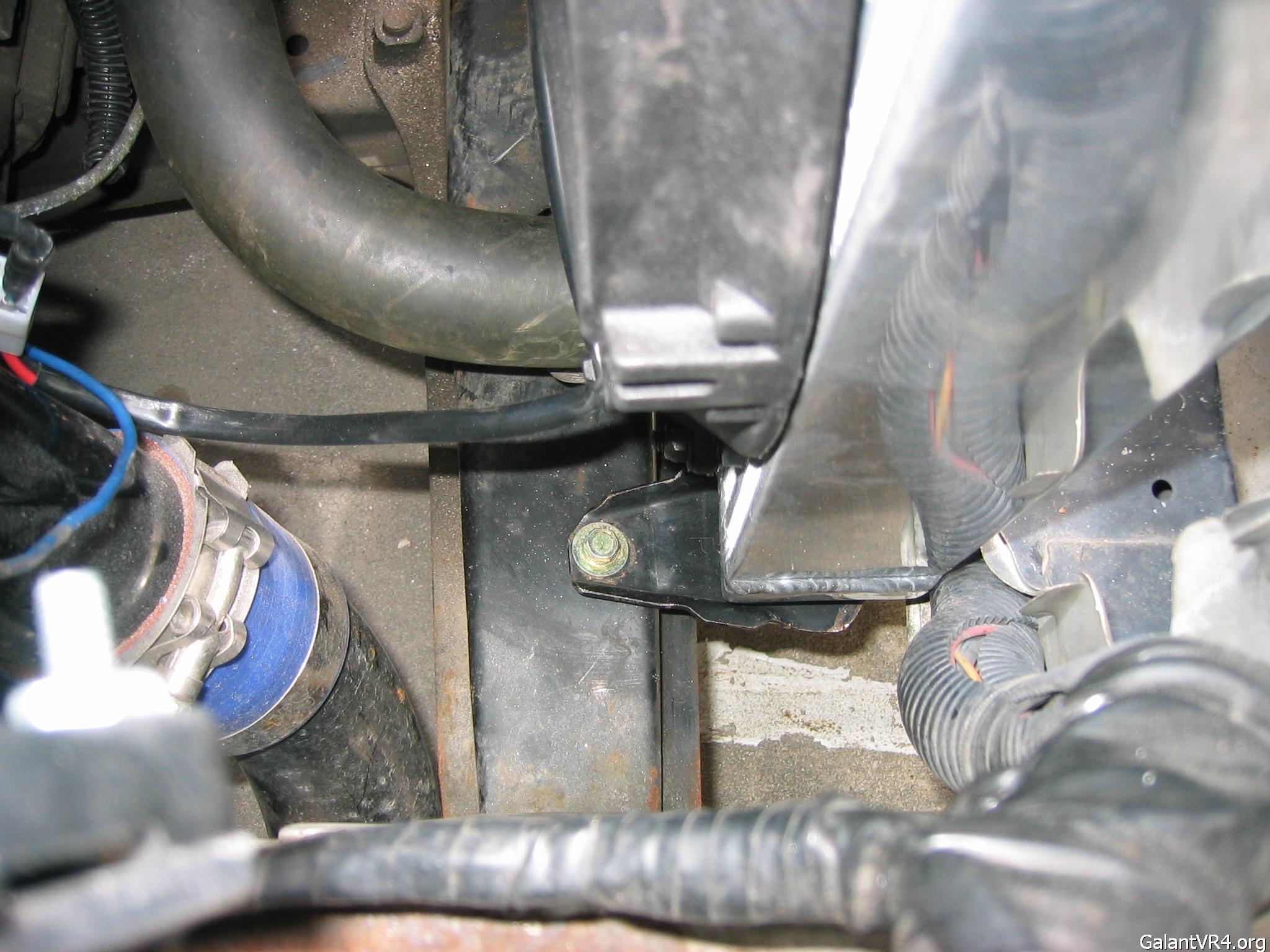

For the bottom mounts I used a set of dsm radiator brackets which I cut in half. then I drilled and tapped the front cross member and bolted them in. for the top I just reused a bracket that I had on the stock radiator.

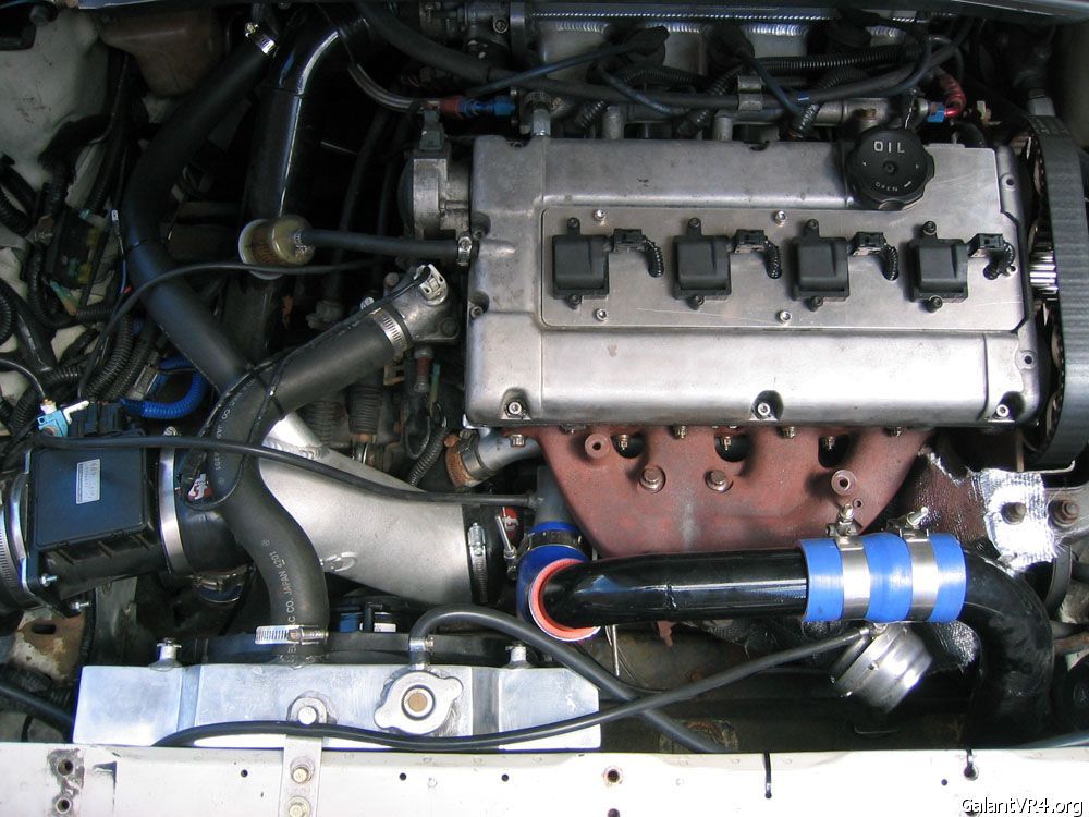

the top radiator hose had to be trimmed about 1" or so to clear the fan. The bottom hose also had to be be cut about 1.5"

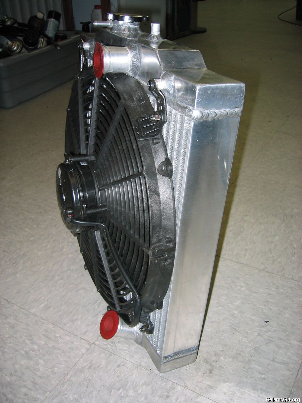

radiator with the fan mounted on it.
side shot.

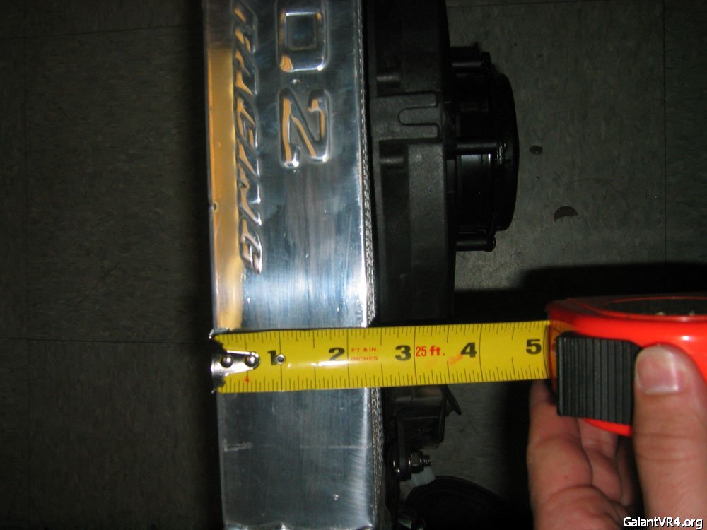

2.5" thick .
right bottom mount.
left bottom mount.

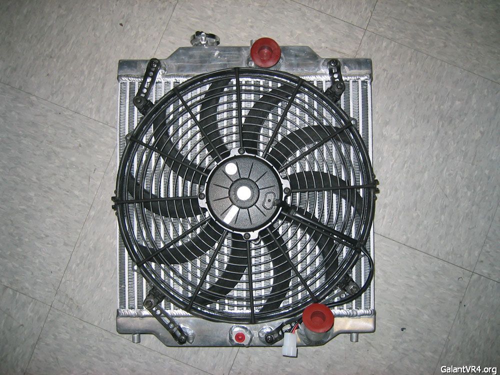

top view.
coolant temperature after letting it idle for almost 2 hours in my garage. outside temperature was about 86*
side shot.
2.5" thick .
right bottom mount.
left bottom mount.
top view.
