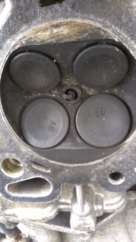

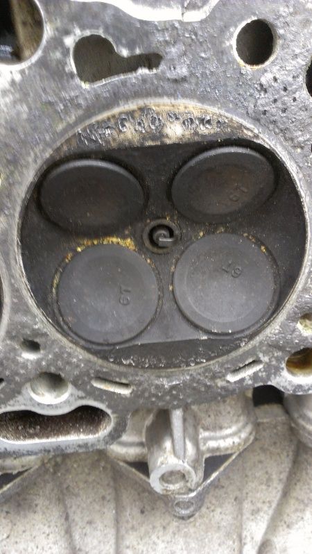

The guy found the pistons that the head came from, the block was redone with new internals. Its only 1 piston that is beat up it looks like someone just started chopping at it with a knife. But the other three are fine and no damage at all and the valves have no damage to them. I will try and get pics up this weekend the head is at my mother's house.

Here are 2cylinder pics for some reason photobucket will not upload the other 2 but the valves look identical there is like a gold powder around them it's not any sort of metal it's very very fine and soft

That would be surface rust on the valve seat. Head has been sitting a while. The valve seats are pressed into the head and made from steel. Just surface rust......
It may just be the angle, but the valves look like they are open. Are the cams still in the head? If not I would say by looking at the pictures that the valves are bent. Even if the cams are in it, it appears that both sets of exhaust valves are open which would indicate to me that they are bent as the cams would never have more than two exhaust valves open at a time!

never mind the valves look at the damage to the combustion chamber on the first pic! That's almost certainly caused by detonation. That head requires skimming at the very least.
