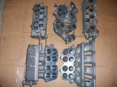

Hey guys,
I'm building the AMG at the moment and have something cool to show you guys.
It'll be bolted onto a VR4 motor with a GT3082 (2.3L stroker)
No wonder my strut brace didn't fit on the AMG but cleared the VR4.

WHOA!!! I never realized they had such large IM's! And now I'm jealous again /ubbthreads/images/graemlins/smile.gif

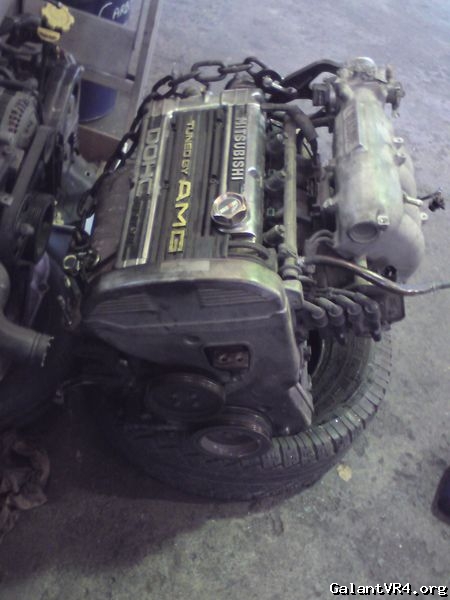

Also had it on the dyno before pulling it apart.
It made 87 kw's at the front wheels.
180,000km's on the clock.
Everything stock.

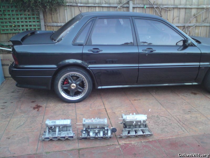

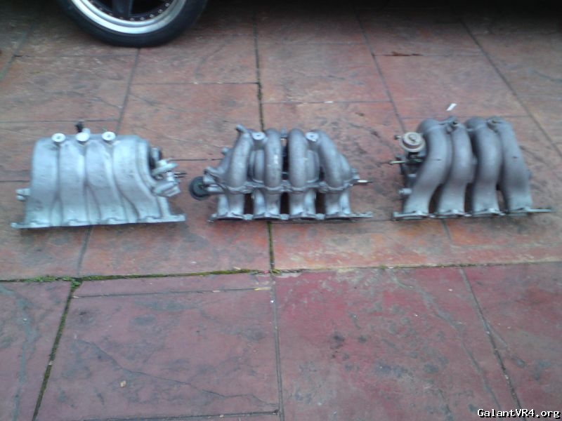

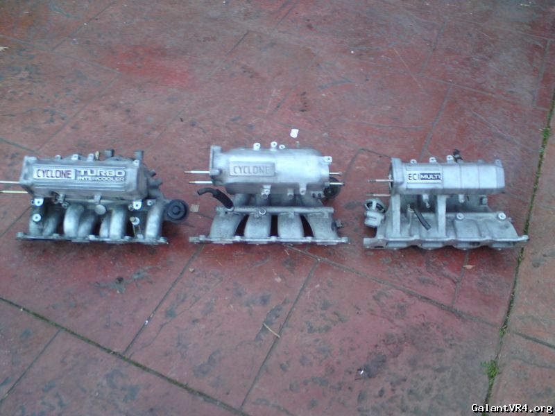

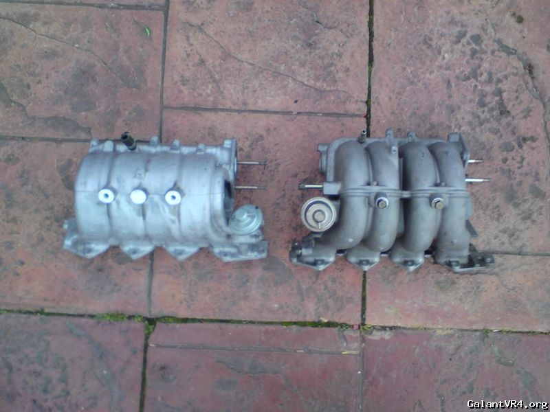

I'll add something as well for the ones that didn't notice. The turbo cyclone manifold has the runners staggered where these are inline top to bottom with each other as well as much larger runners and plenum to help support HP in an NA car. Hard to believe that they cast an intake for such a small run but you have proof they did.
I found the same situation on another NA manifold out of the junkyard. Want work on ours but will on the EVO's with the TB facing the center of the car. The evo manifolds have runners that come off the head curve down and then radius back up and around to a plenum the size of a 16oz bottle this one has the runners coming straight out then 90 degrees up with larger runners and a plenum about 3 times larger.....this probably has the evo guys wondering which car....99-01 hyundai sonata. I just looked on ebay and no one has a picture but there are some on there as cheap as 100 shipped. This maybe on the newer ones as well. Super easy to remove I only had a pair of wire cutters and a few wrenches and had it off in less than 20 minutes.

Spot on Curtis,
I noticed that today and was wondering if it would make a difference.
The merge point in the AMG manifold is about 3/4 down the runner. Whereas the cyclone merges at the port of the head..

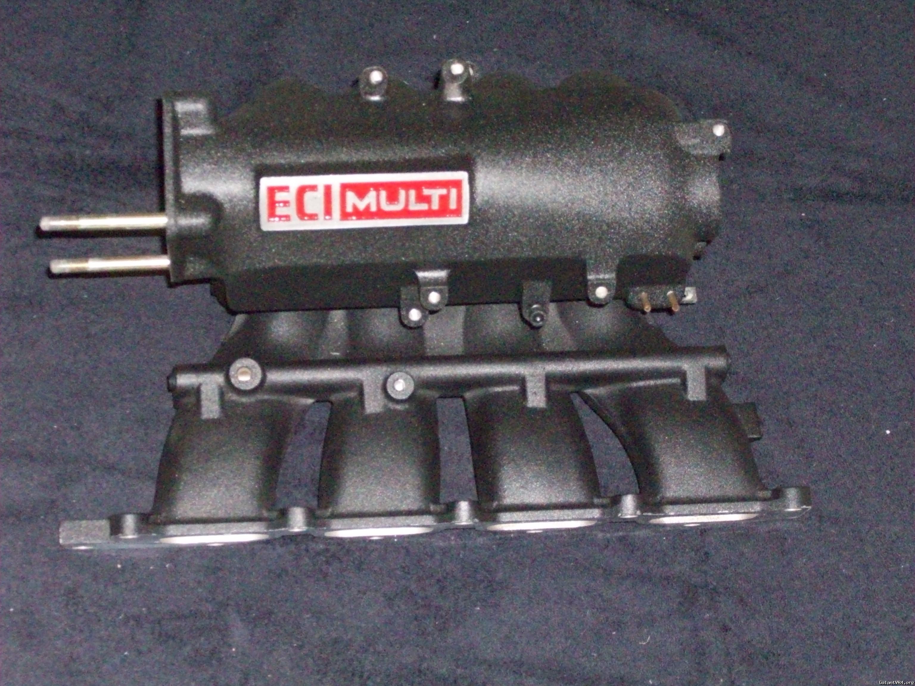

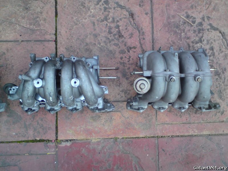

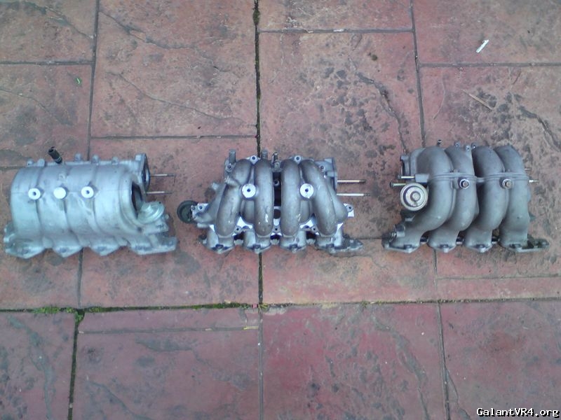

The AMG has bigger primary runners (43.5MM) than the Cyclone ,the secondary runners are the same size as all 8 of the Cyclone runners, 38MM if I remember correctly. Here it is beside of a Cyclone. The AMG is the 2 piece one.
After Rick and I Powder coated it.

I have a Cyclone on a talon that came with a jdm motor. Im debating to use it or not. And damn the AMG intake looks nice once its cleaned up.
