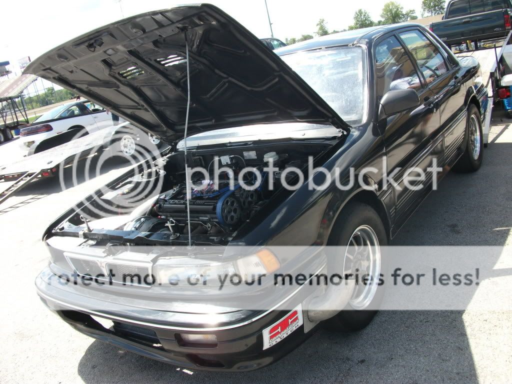

Hey Rolo. Good to see you here. I'd seen your GVR-4 bust down times pretty frequent down in the Orlando tracks, so when I saw you guys pull in at the track, I knew the weekend was going to be badass. The sound of the crowd when you made your passes were priceless and in case some of you didn't see the other thread, here's a few pictures I took of his car.
Good luck and look forward to see it run more in the future!
