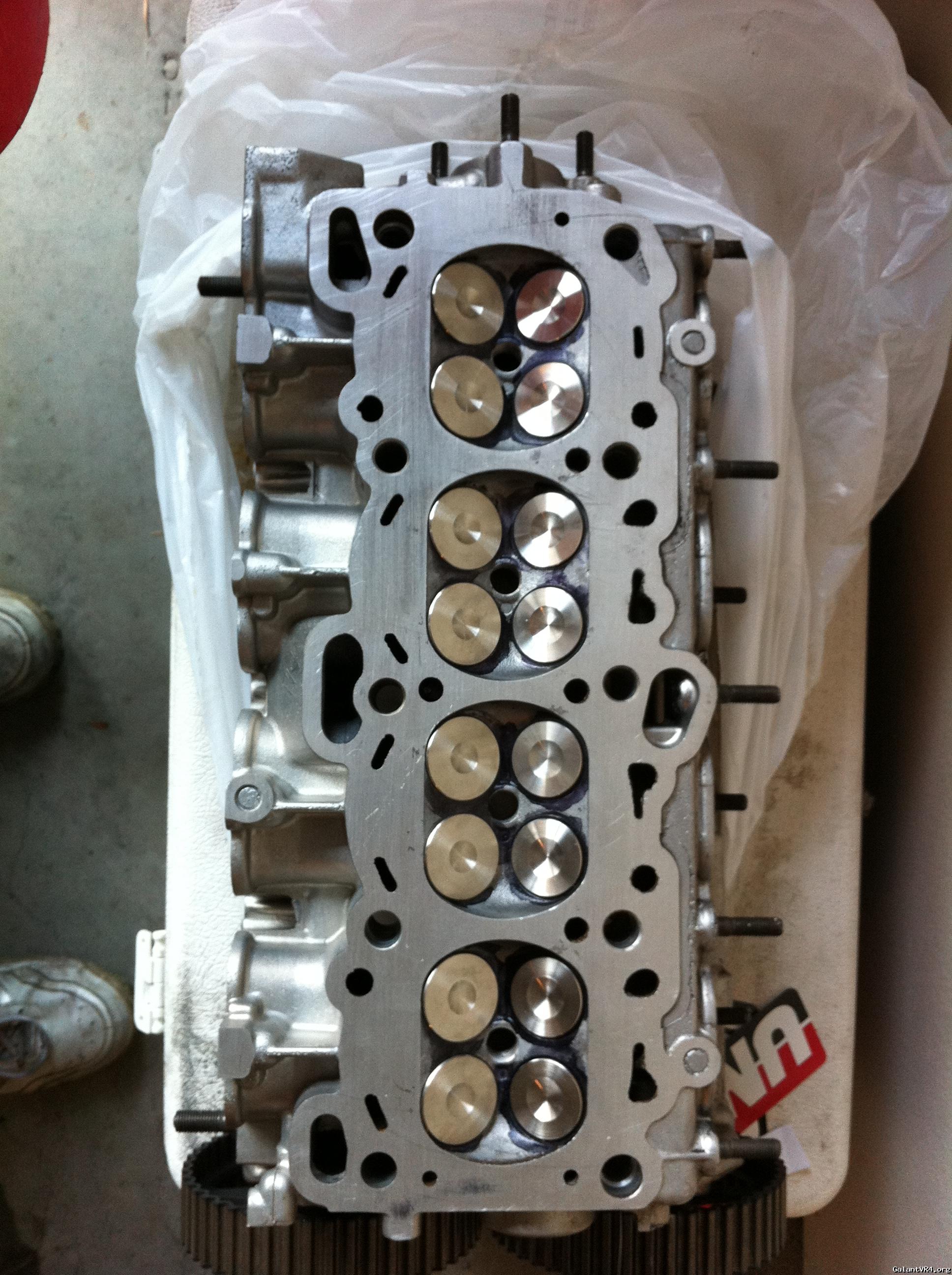

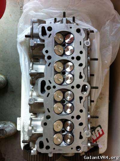

Heres a picture hopefully you can zoom in and get a gander of how it should look like with the regular M8 X 1.25 stud in place. I dont know how you got a M12 X 1.75 in there but I gues anything is possible. The oil is still gonna get back to the pan even if your stud is bottomed out.
Run it.
Thanks very much for the pic. Yeah the M12 stud was a tight fit but it worked lol.
