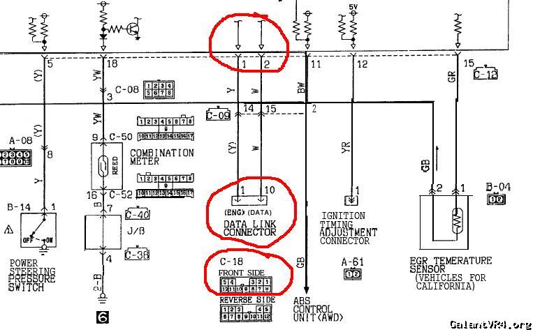

yes the light is on and the ignition is on. can you plug the leads into the ecu directly insteads of the port next to the fuse box? im thinkin maybe the port isnt working?
Pin #1 of the diagnostic port is connected to pin #1 of the ECU. Just connect the other lead of the buzzer to a good ground.
