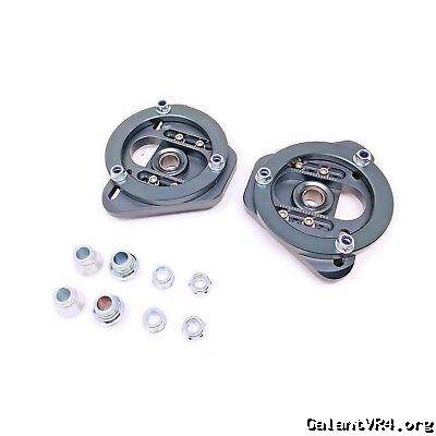

Something like this
Would be awesome.

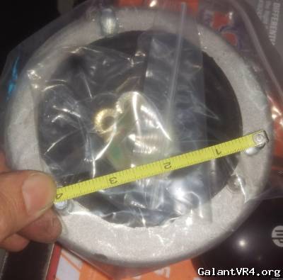

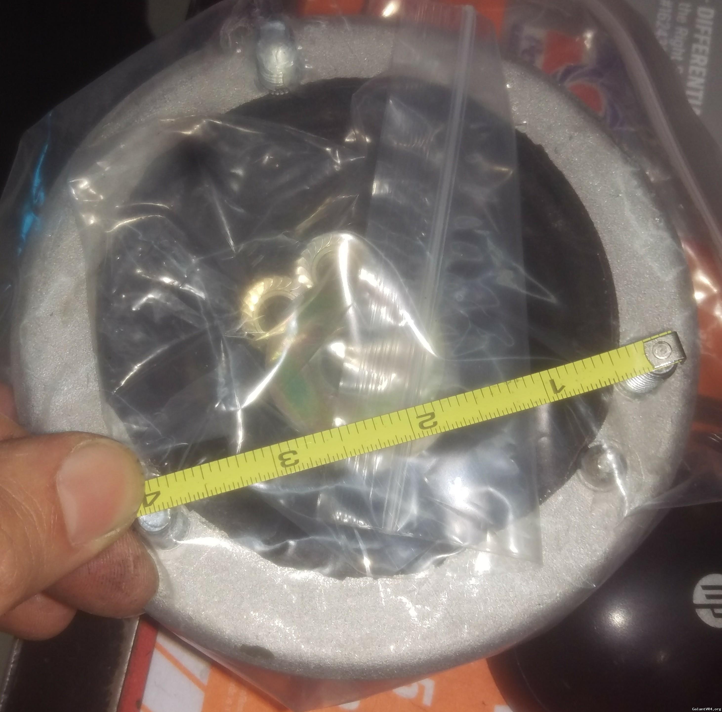

This is the BMW strut mount I measured.

Finally got around to do more measuring and turns out these bolts are too close together for our chassis. Will be looking at other options.
