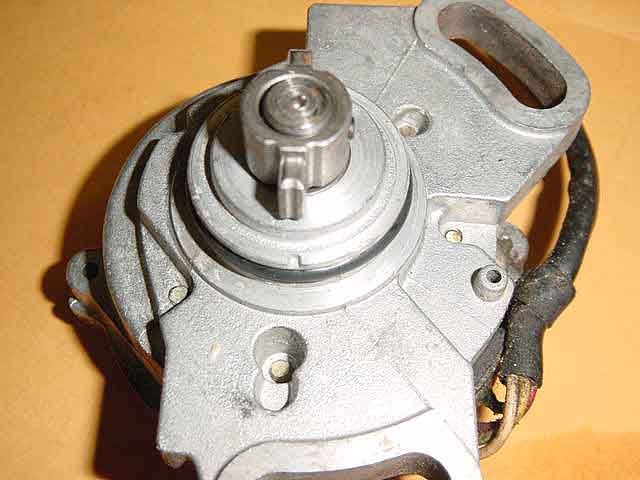

I spent some time tonight rotating my CAS 180 just to make sure. I changed a spare one out, took the head out, and just wanted to make sure.
Anyway, my car seems to run the exact same way, no matter what way it is. This goes against everything I've read.
My car seems to run fine standing still, but bogs under any type of load and when first started.

I guess I can double check. The balance shafts have been omitted and I only have three marks to get right. I haven't gotten them wrong before, but I guess anything is possible.
The thing is, it ran like this out of the blue before I dug in to anything. One day it ran perfect and the next it didn't. No changes.

The BOV is a Greddy. I've never heard a stock one sound like that. The fuel system has been checked. New filter, injectors cleaned and matched. Iceman even helped with spares to get a better matching pair. I've tested power to the injectors with a noid light. If anything, the car seems to run rich. Turbo didn't have any shaft play, seems to be fine. I haven't checked the pump, but according to the fuel pressure gauge, it's correct and I can hear the pump going.
What I don't understand and part of the original question. The car seems to run exactly the same no matter how the CAS is set. How is this possible? I can set the ignition timing "grounding following the VFAQ instructions" and the car runs the same.

I'll try wording this a different way. I don't know if the CAS is set right or 180 degrees off because I no matter how I have it, the car runs the EXACT same way after I've set the base timing. One way should work, and the other shouldn't, but everything I've read, it shouldn't run the same way.

That's simple! TDC the engine (cam dowels facing up), then insert the CAS with the marks lined up. There is a notch on one side of the paddle, and a hotch in the CAS housing.
