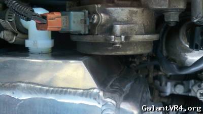

So with my new AWIC install the clearance between the intercooler, the strut tower, and the CAS is tight.
Now, officially I can't change engine parts for my class but I can alter anything related to engine control. That means that the CAS - which is ultimately a component of the EFI system - is a little bit of a gray area. I'm thinking of exploiting this to see if I can get a bit more clearance. The question is, based on the above image, might I get a little more wiggle room by switching to a black_top? I know they have a domed top which may help since the interference is only over about a third of the current CAS. But, does anybody have one of each to compare the overall mounting depth? Or would somebody with a black_top be willing to take a careful measurement of it's thickness from flange to dome peak? If the black top is not only domed but also lower in overall profile then that'd be a double win...

I'm just thinking that if a black-top is a little lower in profile it might give me an extra few mm so that the tank isn't so tight in there. It sits without an issue now but I'd just like a little more clearance so that it doesn't heat soak right next to that hot steel plate. To that end, even if the black-top doesn't improve the clearance, given that it's plastic it'd probably have less thermal emission. Hm... maybe I'll just go ahead and try it out...

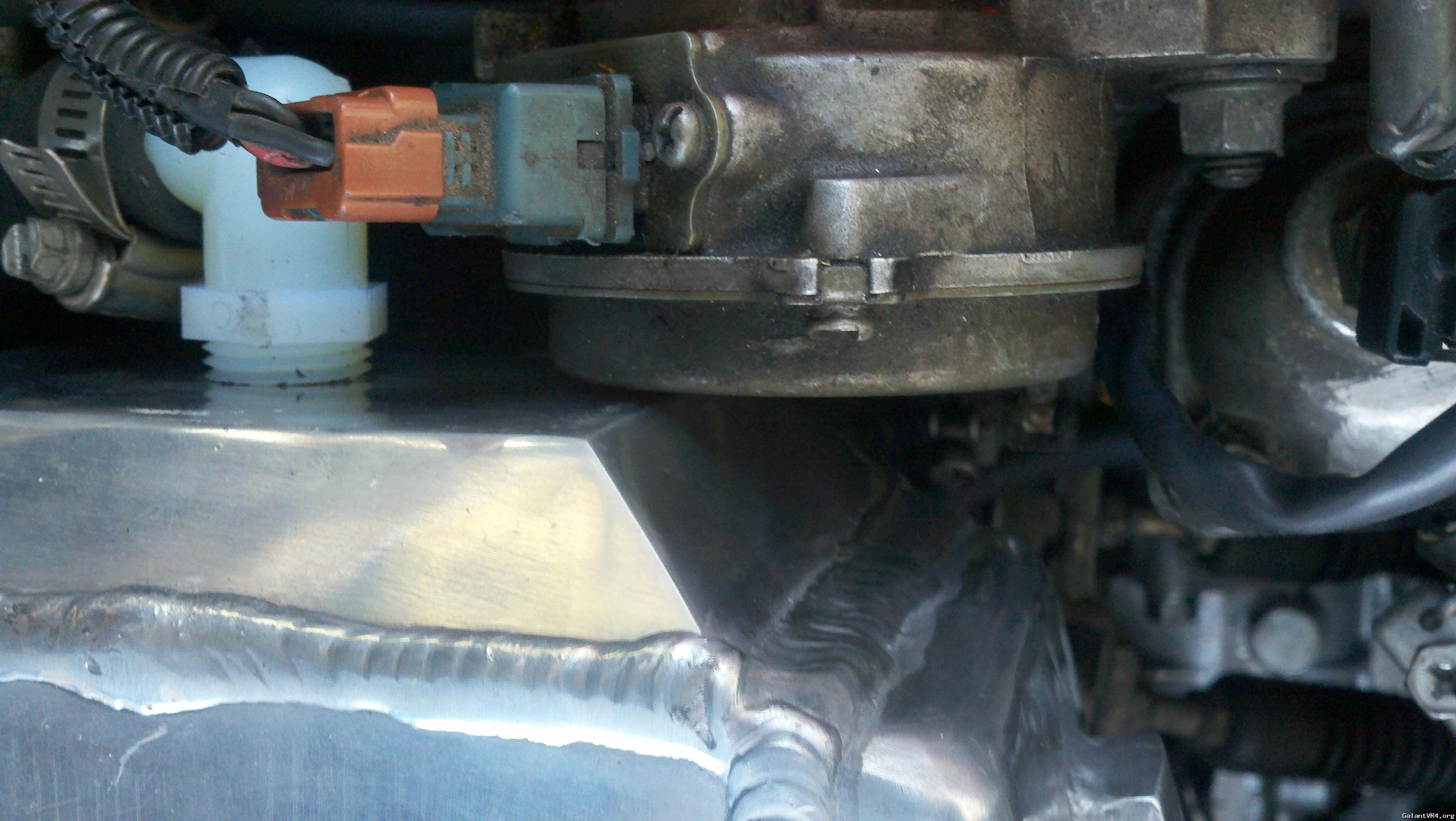

So I understand Curtis, does that make the total thickness 51mm or 61.12mm? Either way, I make the total thickness of the green at 45mm so I'm not gaining anything. I found a picture to help illustrate the point...

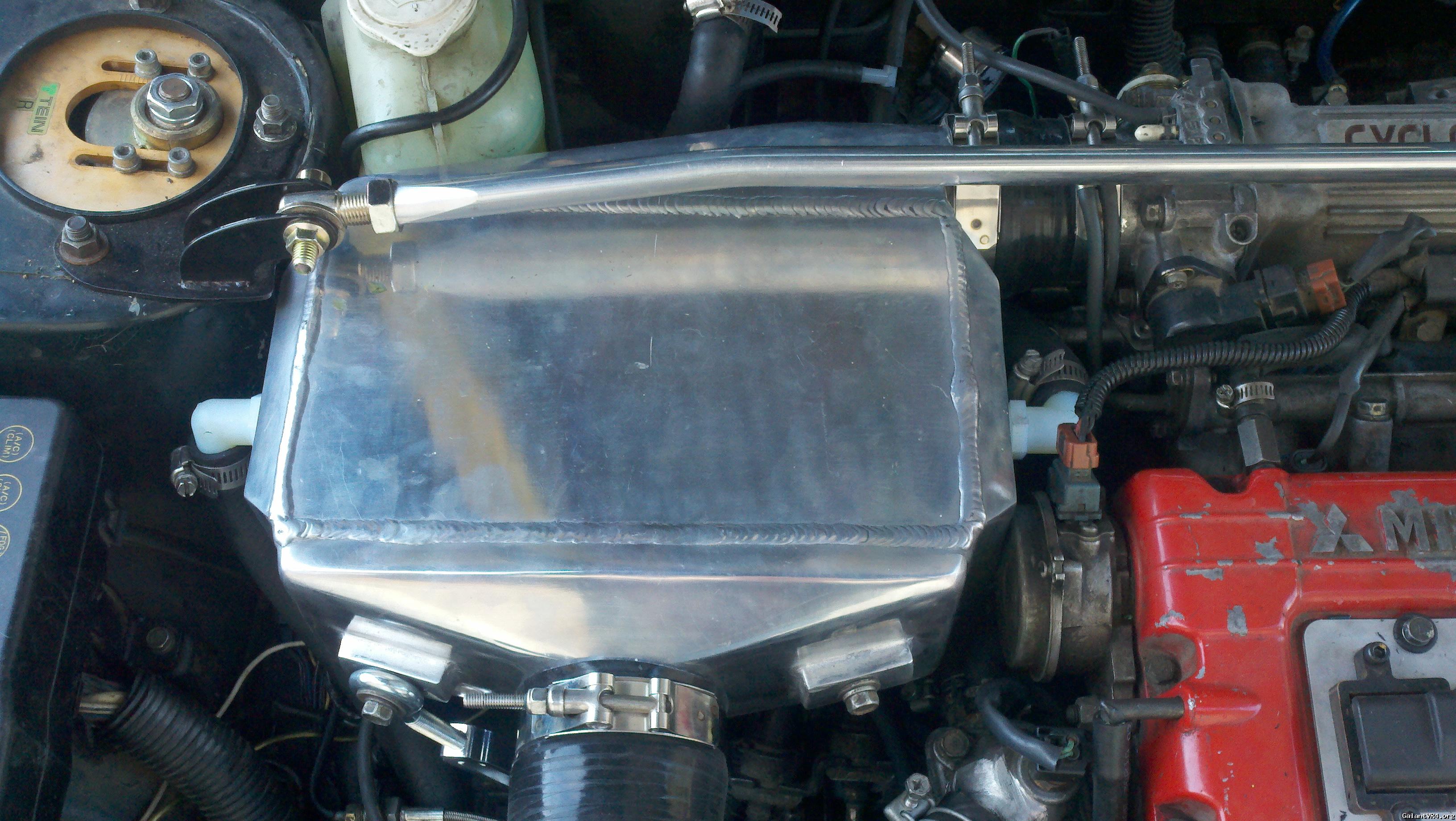

Looks like a tight fit is gonna be as good as it gets unless I want to modify the end tanks to move the core farther forward in the bay. Here's a zoomed out pic so you can see what I'm talking about. It's a good thing the washer reservoir is plastic and a little bendy...
My other option is to try to use one of these offset silicon couplers... click which would shift the whole business forward and out about an inch. They come in 2.4x3 and 3x3. I've had 2.5" silicon over my 2.75" n/t throttle-body but 2.4" might be pushing it. Also, the guys at AP implied that they're actually more like 2.2" (not sure about that). If I went 3x3 I'd need a sleeve over the tb or else a different tb... hm.

There is plenty different things to do but all requires a tig welder which I have and if you want some chopping done yell.
One you could cut off the rear end tank and slide the IC forward a few inches over a couple and box back in.
Another is rotate the IC 90 degrees weld on an elbow to the rear one now and a 90 on the bottom and mount standing up.
Use the rear end tank as the hot side and weld on a couple of 90's

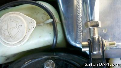

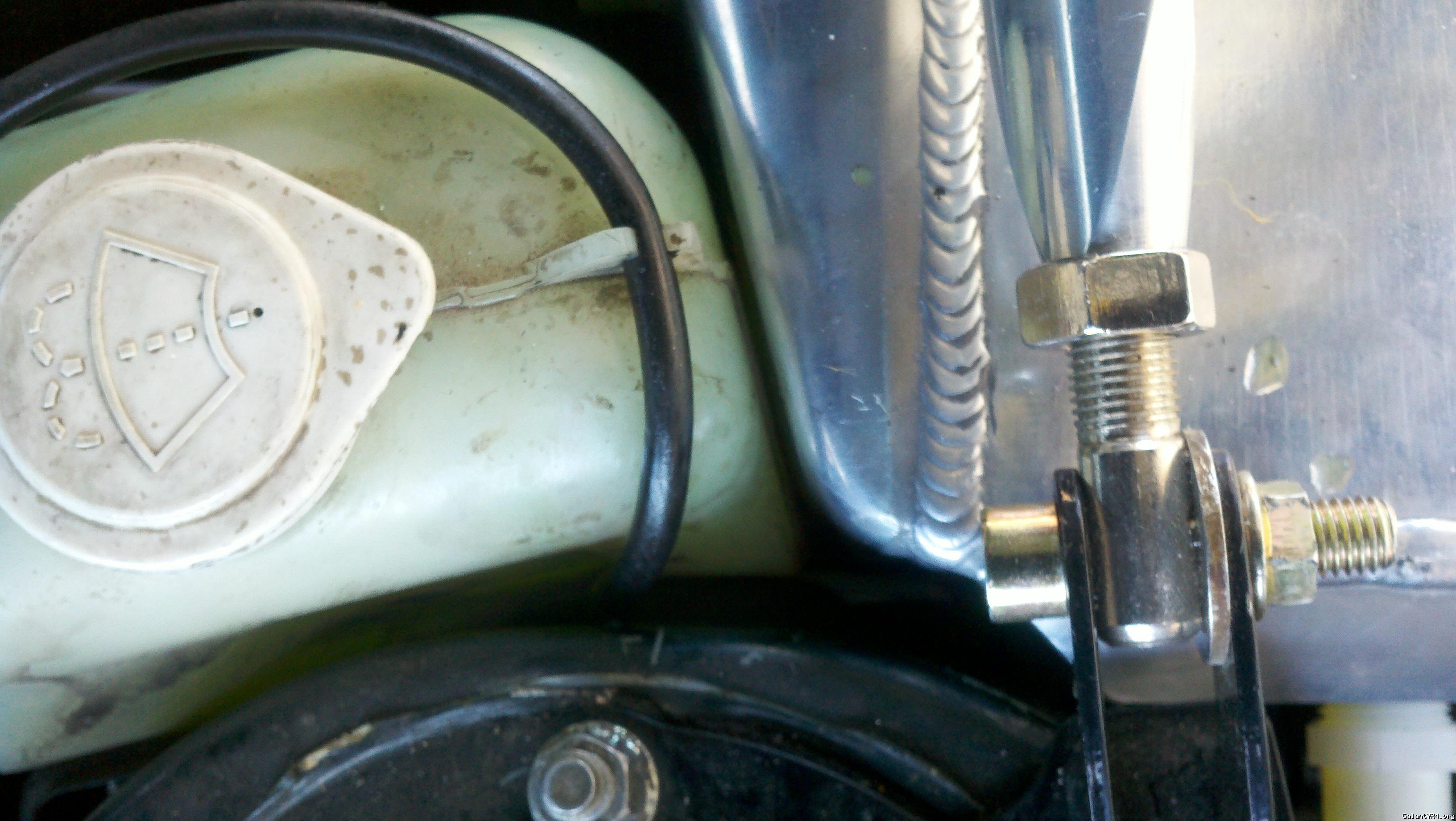

Bozeman, MT
f*** it. I'm just gonna slot the holes in the washer reservoir and slide it back half an inch. It's not legal but nobody will ever notice and it'll save me a huge headache messing around with end-tanks and wiring and all that. Then I'll radius the edge of the water jacket so that there's a little more room at the strut tower and call it a day.
