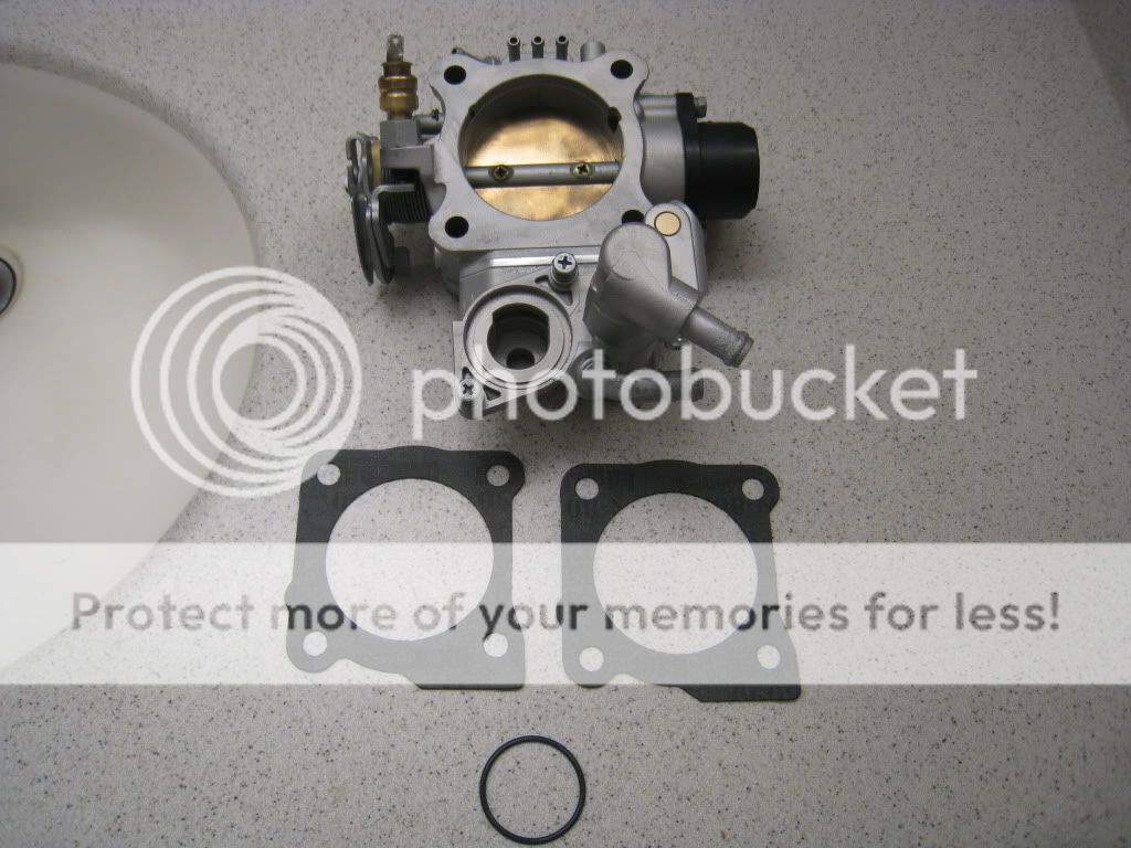

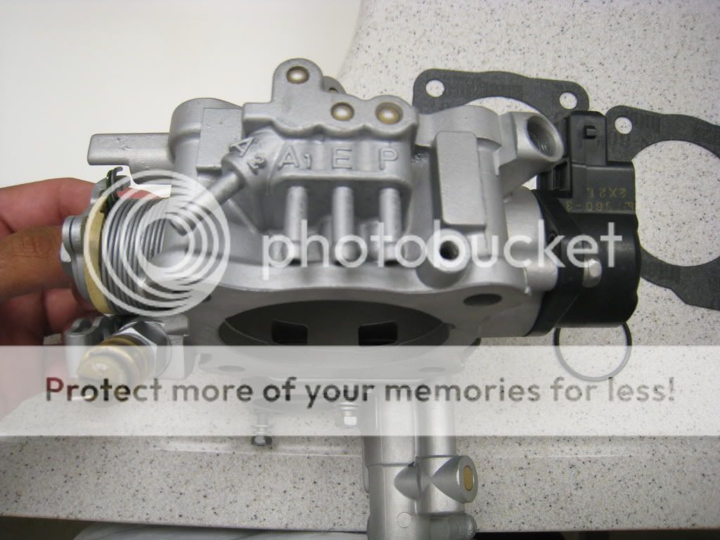

i did that same free mod on mine, but didnt fix the problem man. I just sent my throttle body to Steve Monroe at Throttlebodys.com and he rebuilt it with new everything and cleaned it up all nice and everything. all for only 150 bucks shipped. I HIGHLY recommend him to you. best 150 bucks i ever spent and now my idle is rock solid and never just dies anymore while sitting there like it always used to.
