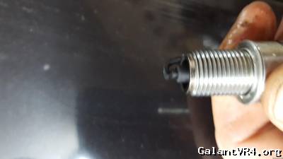

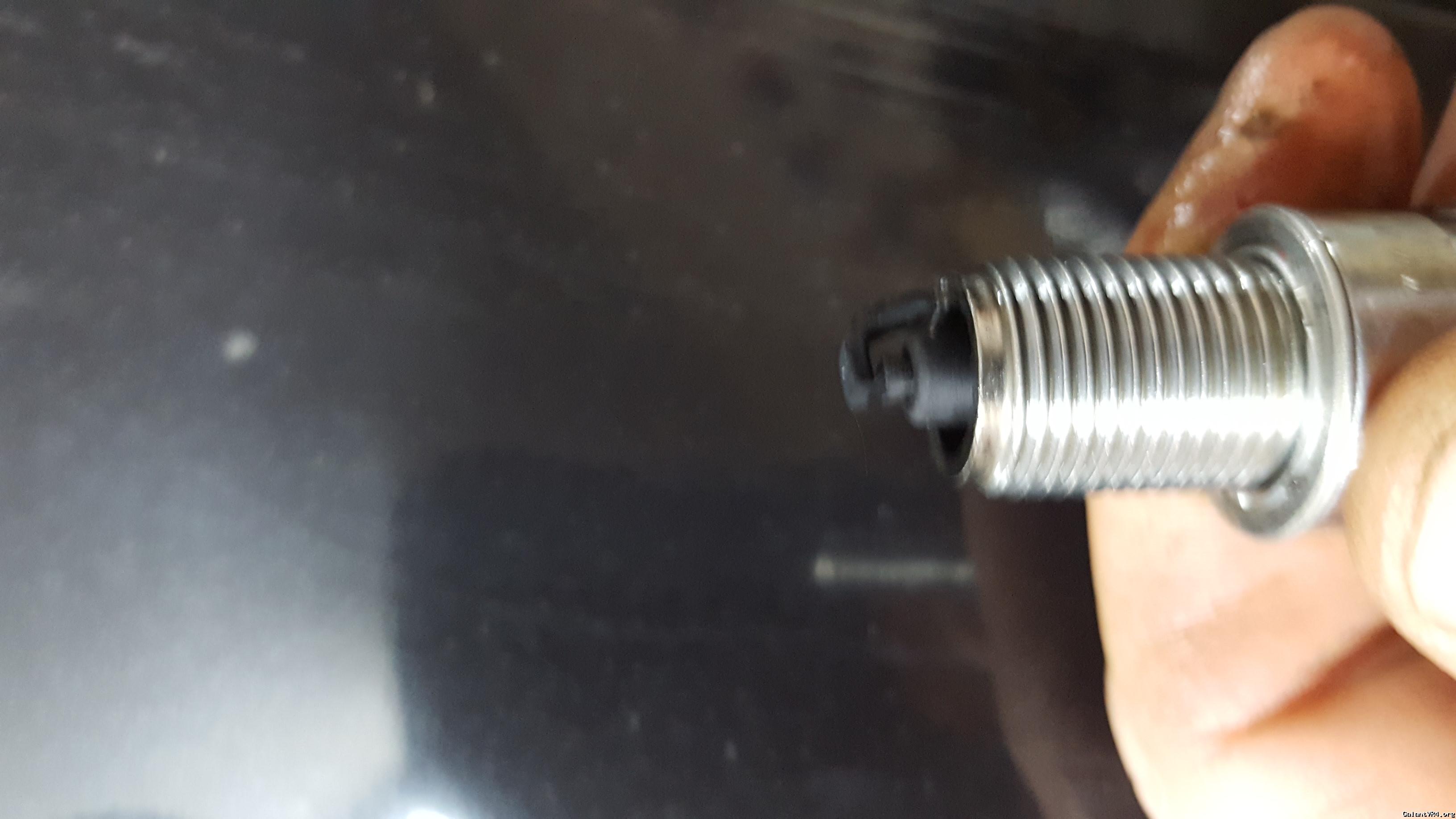

you can see that the spark plug seems to be quite black which I see as a sign of running rich(correct?). That being said I do not know what kind of O2 sensor is installed on the car whether it be wideband or other, but there is no gauge for it so that I could see what the AFR is. I could switch from the current ECU to the ECM link to monitor that I am guessing? I have never tuned anything before but done some research into it.
Other changes are that fuel pressure was checked and at around 42-44 psi but I was unable to get consistent readings off of the fuel pressure test kit. fyi: the kit was attached at the fuel filter banjo bolt on the firewall.
Since I assumed this supposed rich condition was caused by a stock tune with 1000cc injectors I pulled the fuel rail and replaced with a known good factory set with no change in running characteristics. I am going to do some small things tonight like make sure that there is plenty of fuel in the tank since I do not know if the sending unit is working or not. any other suggestions?

DSMLink will give you an "estimated AFR" from the stock o2 sensor. Although, you can also install a wide-band and run it without the gauge, but that would still need to be wired in and calibrated for it to read correctly in link.
