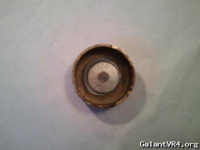

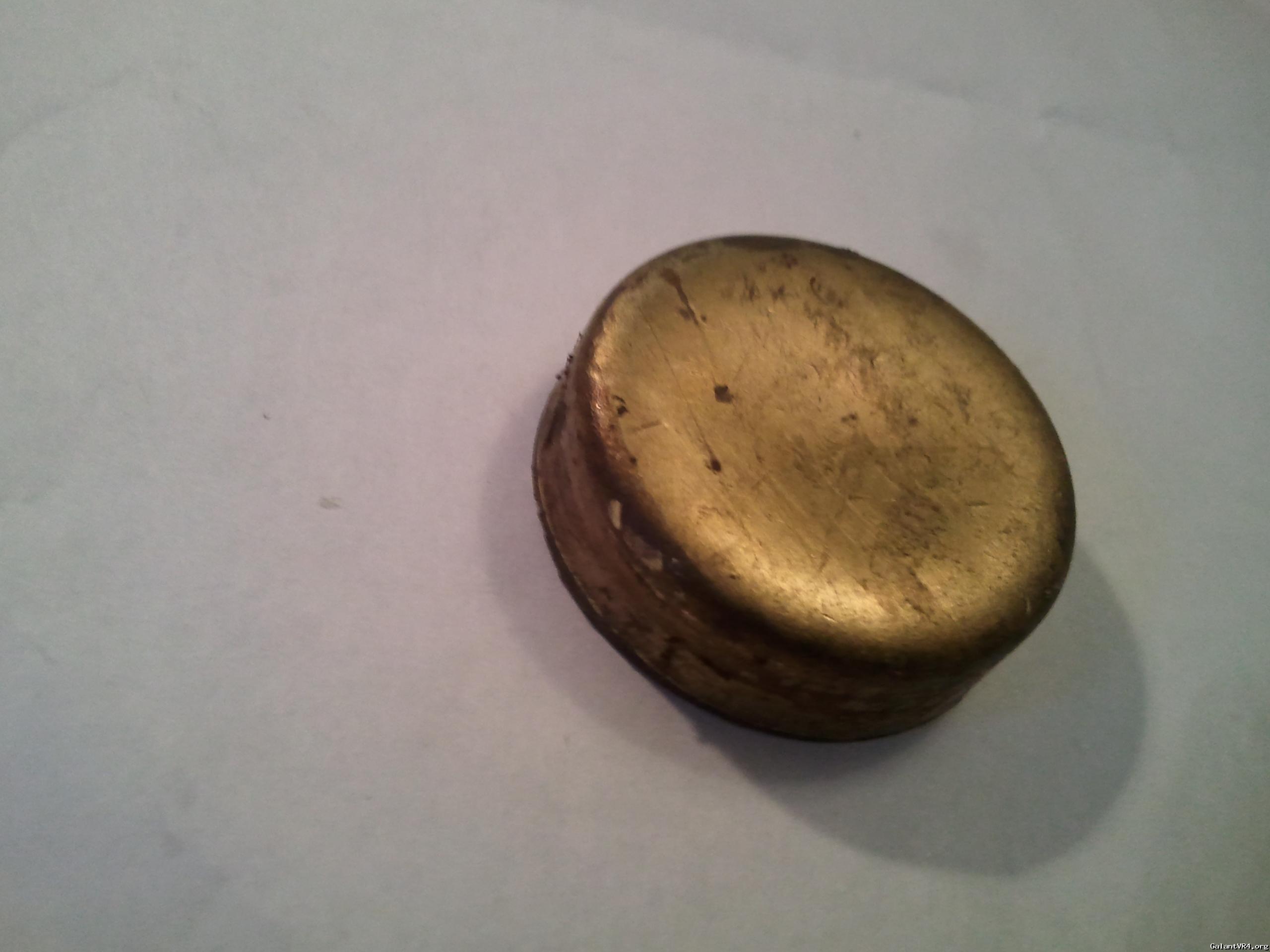

Just reconfigure my EBC (HKS EVC EZ) to what the factory stated. 1 line goes to external wastegate actuator, 1 line t'd with BOV and Intake Mani, and the final line t'd with the secondary wastegate actuator and turbo compressor housing on the intercooler piping. Took the car out for a spin and got it up to 10psi which came on really quick then I heard a series of backfires (stutterbox like) and the car began smoking and started pissing out coolant. Heard some metal clanging (always nice) and found this on the road...

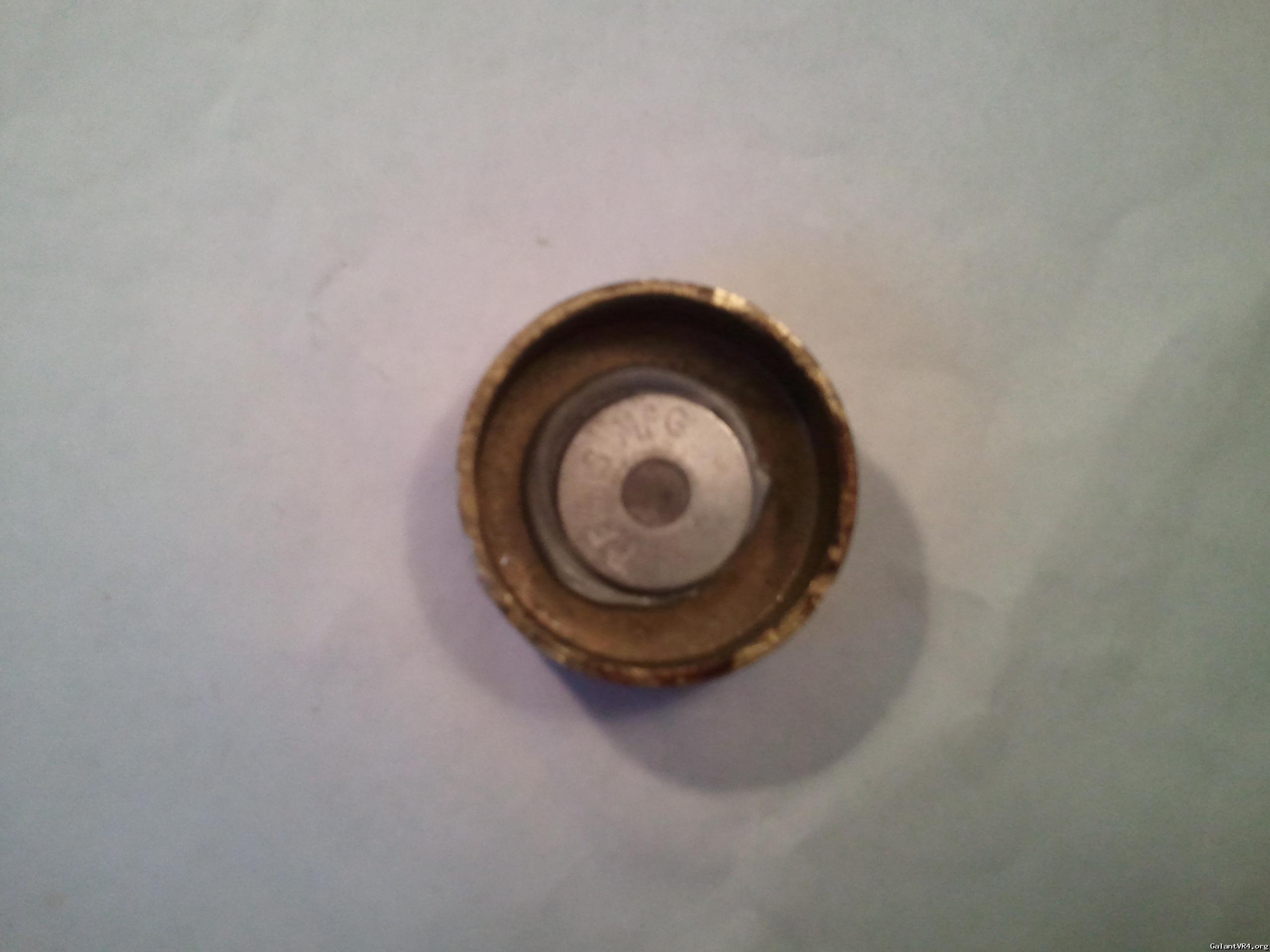

On the interior shot it reads "Regis MFG" and it looks like there's gray RTV. I'm at a loss at what this is...any ideas on its identity or how this happened?
its a freeze plug from a used engine or rebuilt engine. that silver button glued on melts if it overheated. did your car have staight water in it or proper coolant mix when it was cold outside?

Always had a proper coolant mixture in it. I have only run this rebuilt engine 3500 miles. What would cause the freeze plug to fall out? Also how do I go about fixing it?

I would suggest a compression test.... Bet you blew a head gasket and the pressure on the coolant system pushed the plug out.

Haha...no joke. Intake manifold off...found another freeze plug just hanging out...now I have to pull the exhaust manifold. So...pulling the whole engine for overhaul. JSB for real. /ubbthreads/images/graemlins/cool.gif

Just a little know fact, the correct term is core plug. Core plugs were never designed to POP out in the event that someone puts water in their coolant system and it freezes. Their true design is to plug the holes cast into the block that allows the sand used in the casting process to drain out of the cooling jackets. Haveing them pop out when your block freezes is only coincidence.

^^^The actual correct name is "Welch Plug" it fills the hole left in the creation of the block. But for parts ordering...you really need to use "freeze plug" or no one knows what you're talking about, as evident at my local Mitsu dealership. Needless to say there are 9 in total, and I will be replacing each and every one of them.
