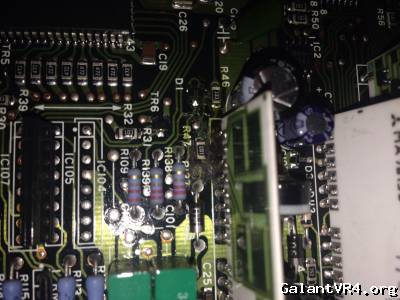

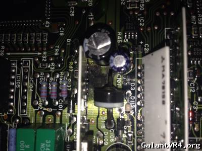

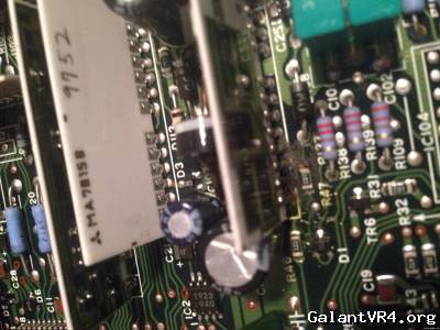

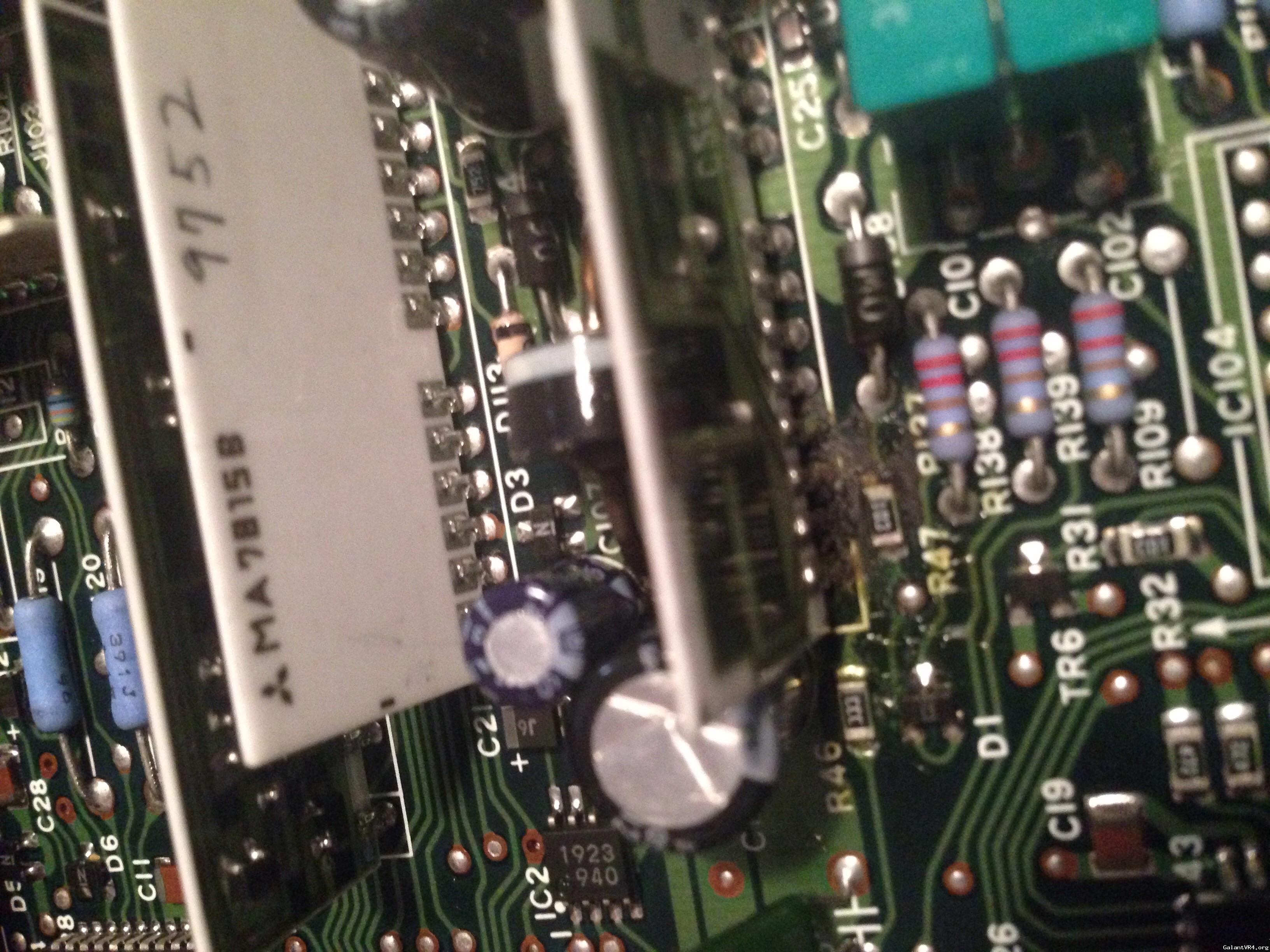

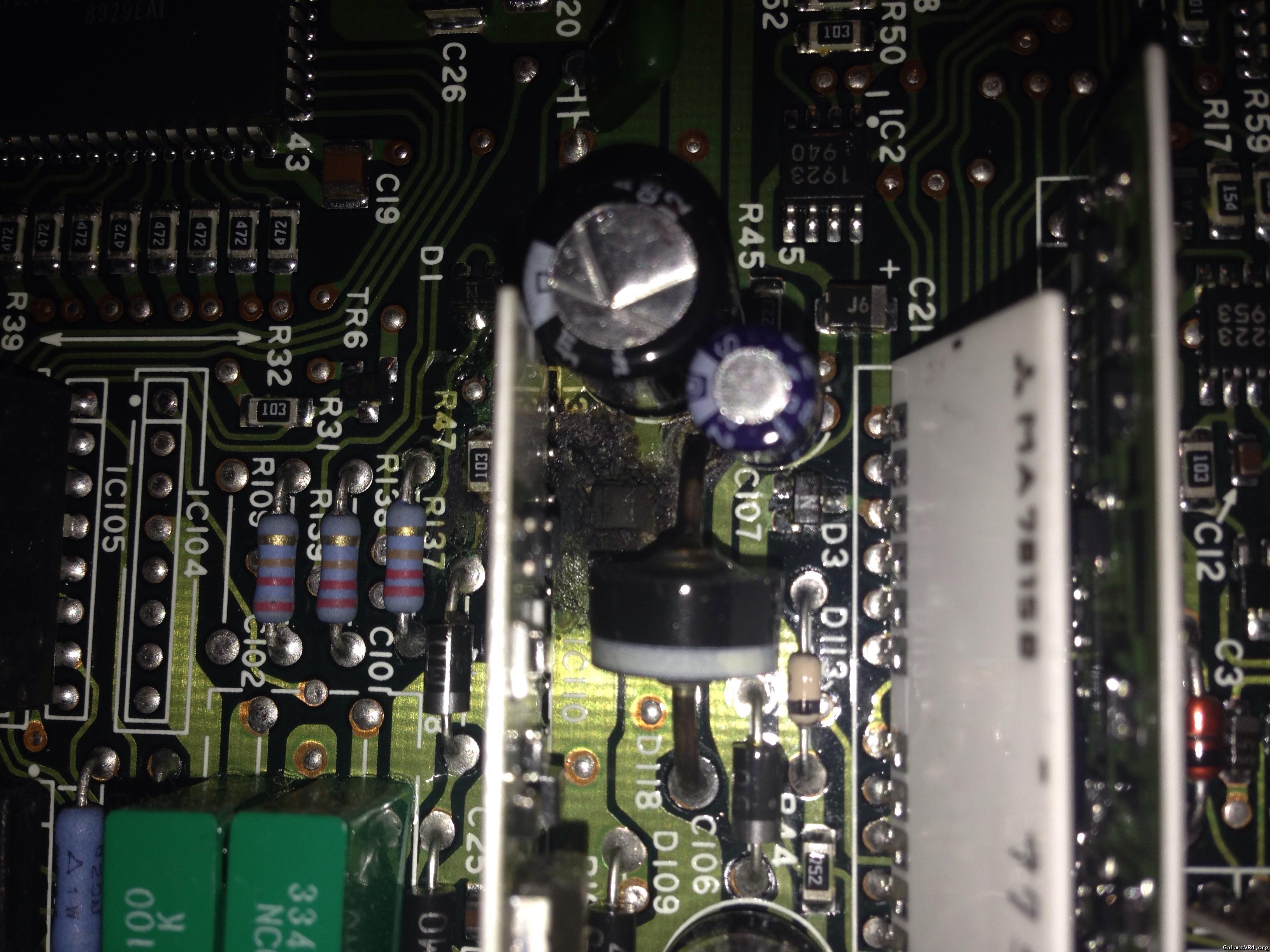

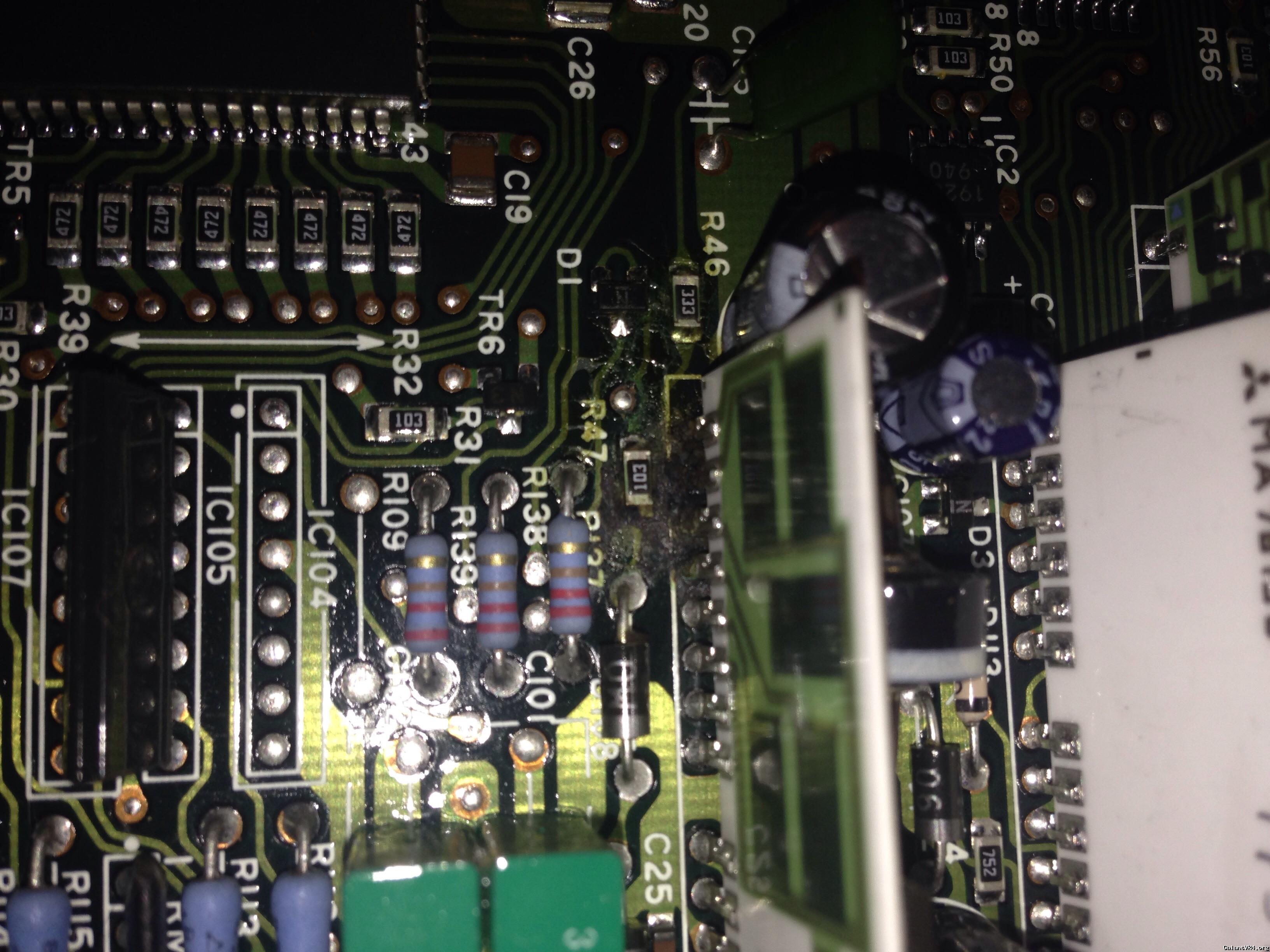

So I took out my ECU and as you can see the caps have started leaking. Now this could be causing my issue. But could there still be an underlying cause?
How legit is ECMTuning? That's what I have seen on here that most people send their ECUs to get fixed.

Sent my ECU to ECMTuning, and I am getting the capacitors replaced. They said my ECU is fine other than the leaking capacitors, also the the ISC drivers are working properly as well as the fuel pump relay. Thus ruling out the ECU being the culprit of the car not running. Any other suggestions?
