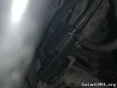

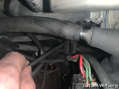

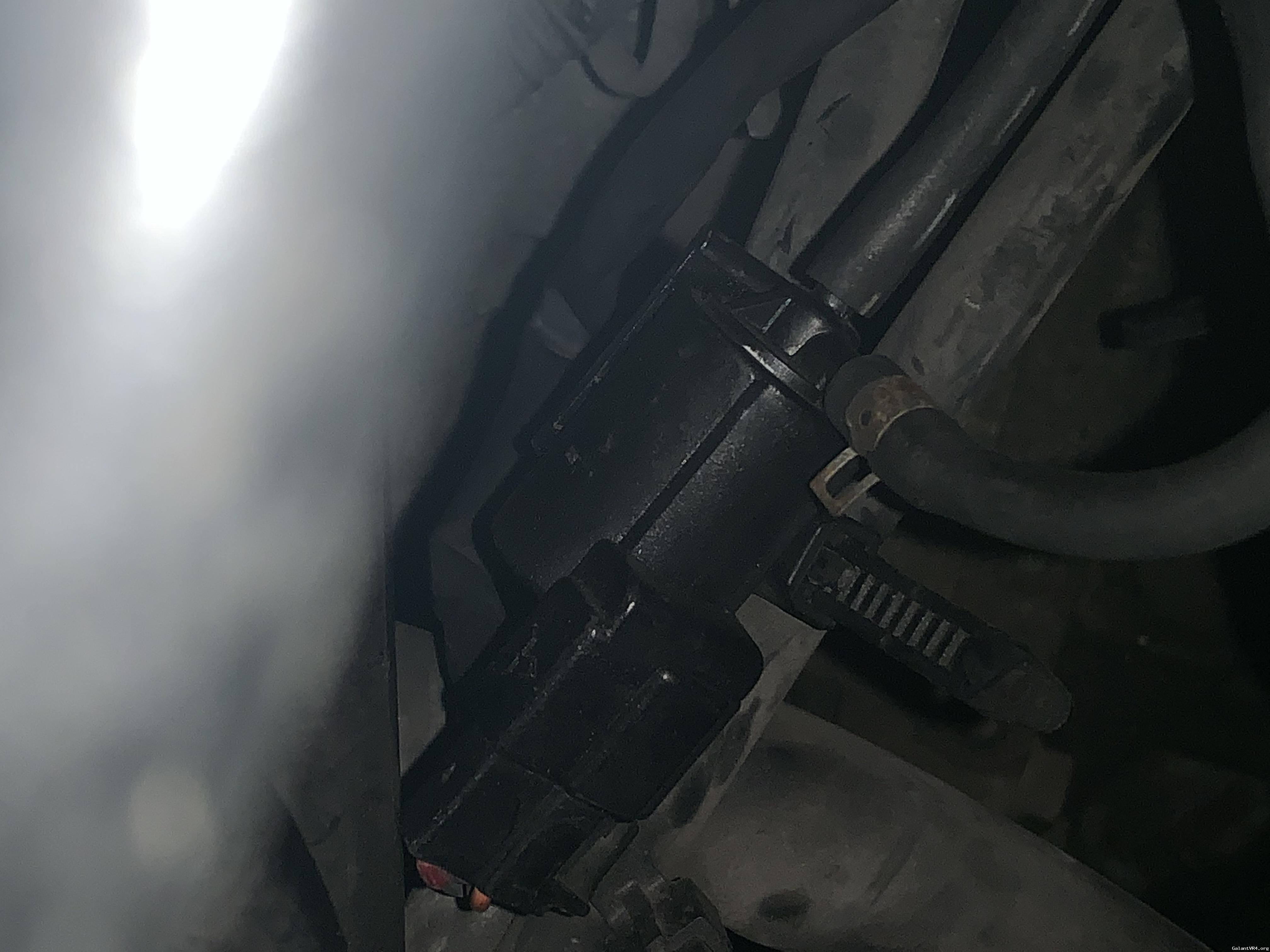

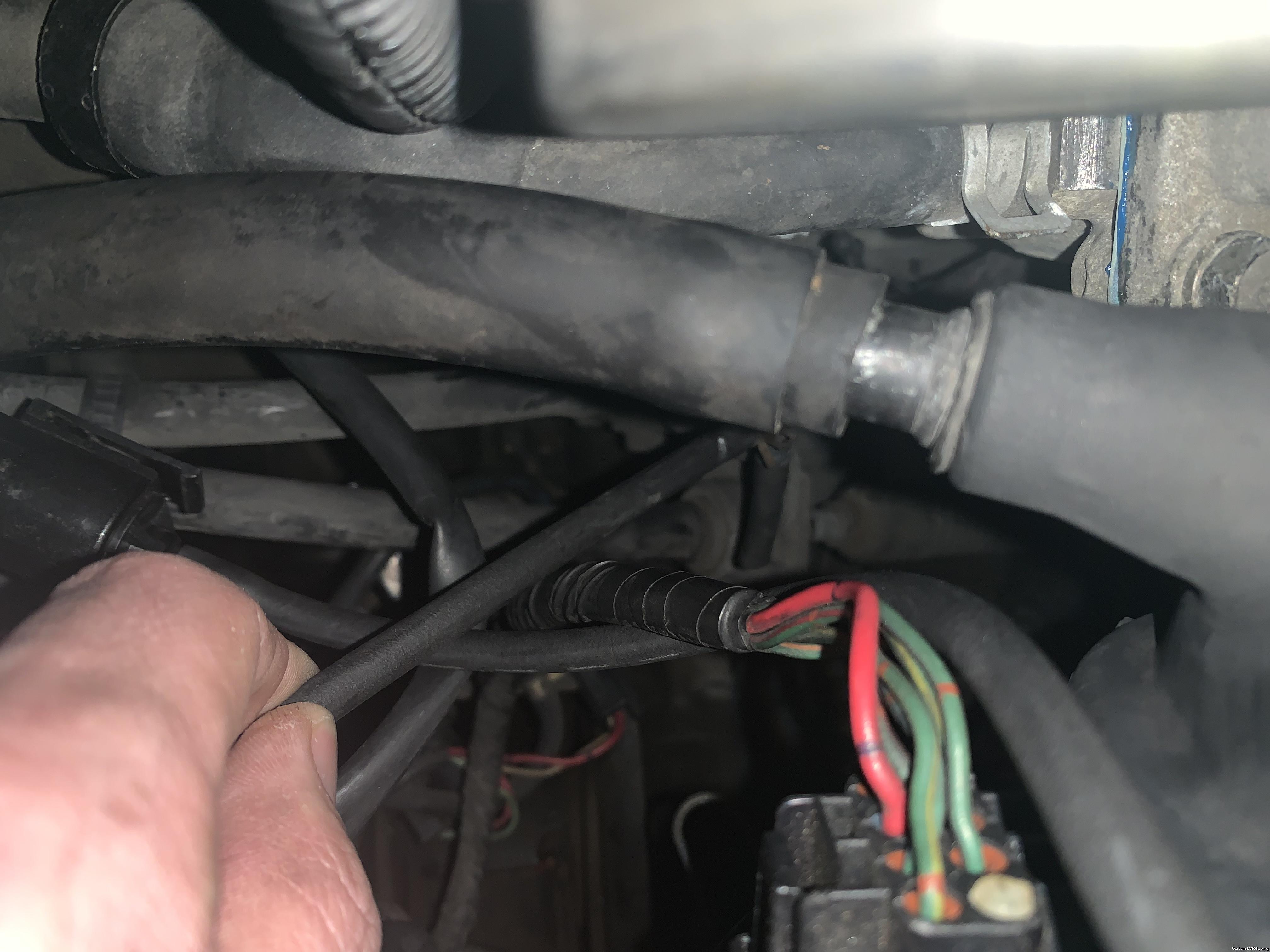

I think it this is boost related, I may have found the issue, but I’m not sure the best way to fix it yet.
The line that ran from the boost solenoid/actuator and T’d off to the LICP on the stock setup...there wasn’t any spot on the new setup to plug it in, so I just cut it and didn’t think much of it. If this is the issue should I just plug it, or tap into the LICP like the stock setup?
