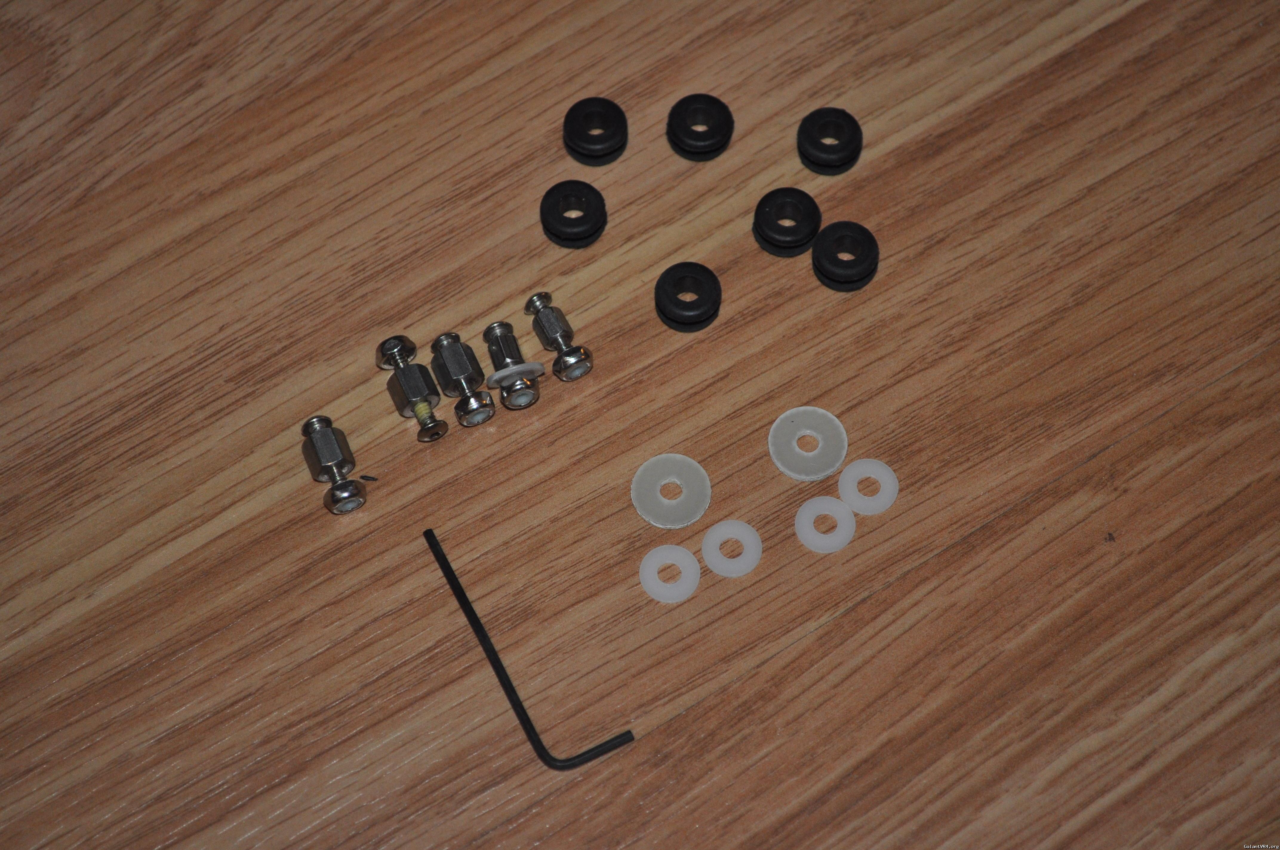

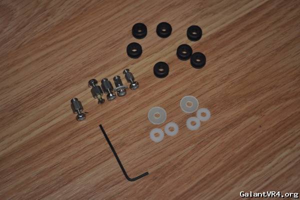

The SS unit I got from DSG used plastic grommets and a short nut/bolt combo. So long as you have a FULLY insulated insert/sleeve through the sender top, you can use whatever you can find.
This is what came with the unit: (Thanks Alex for the replacement bits!!!!)
(Click on the little pic guy, No I dea why it's doing that to me still...)
Nylon washers, rubber grommets, and a hex section with a threaded end and tapped end and some lock nuts. /ubbthreads/images/graemlins/smile.gif
