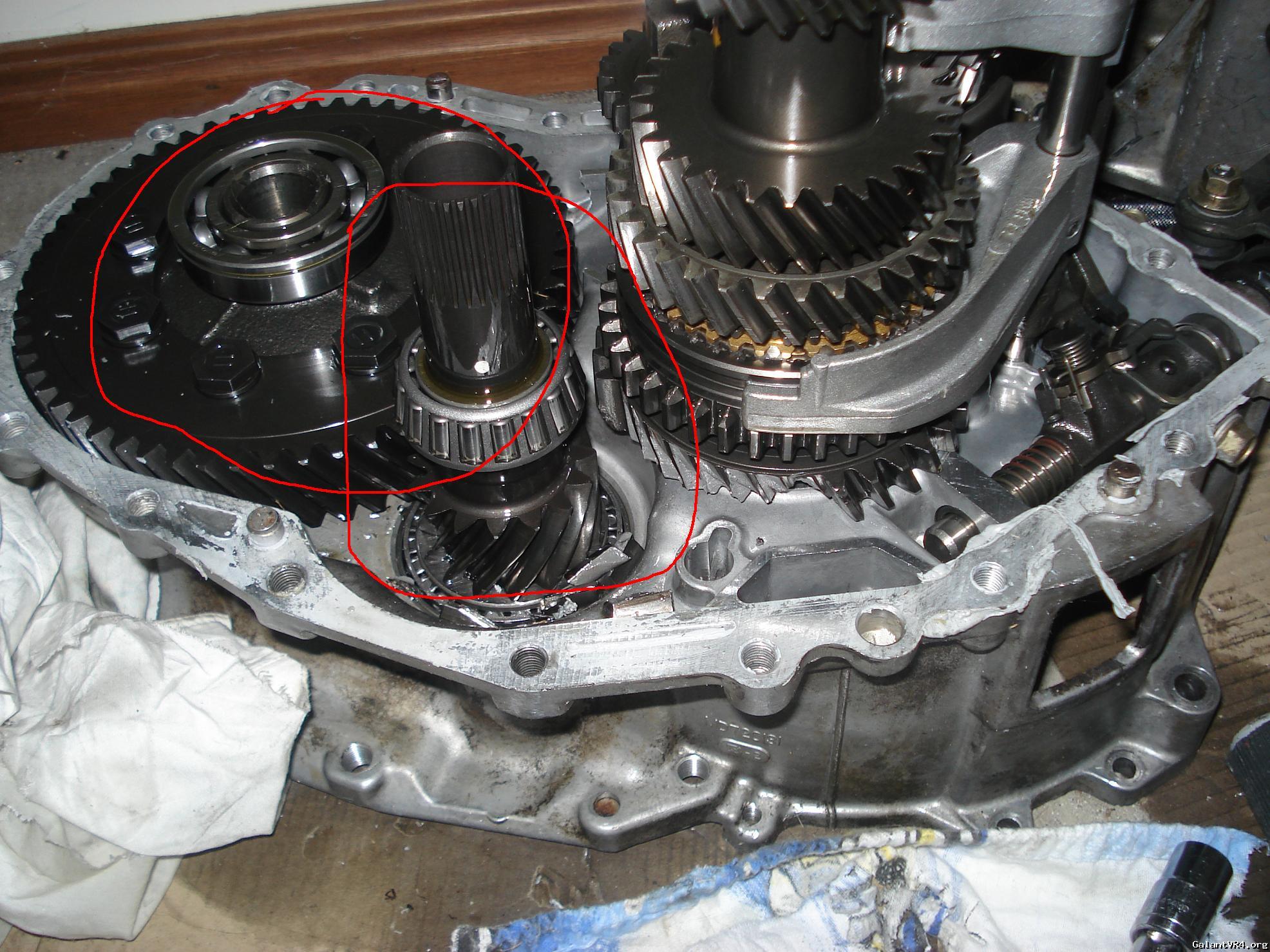

Curtis, that is why I suggested Paul should run a matched pair ( output gear and crown wheel ) The centre diff slides down on to the output gear and as there is no actual meshing of teeth between them there shouldn't be a problem as long as the connection is straight.
I case I have described it differently because I'm on the bottom of the planet here's a picture ( disregard the mess in the bottom of the box ) /ubbthreads/images/graemlins/rofl.gif
