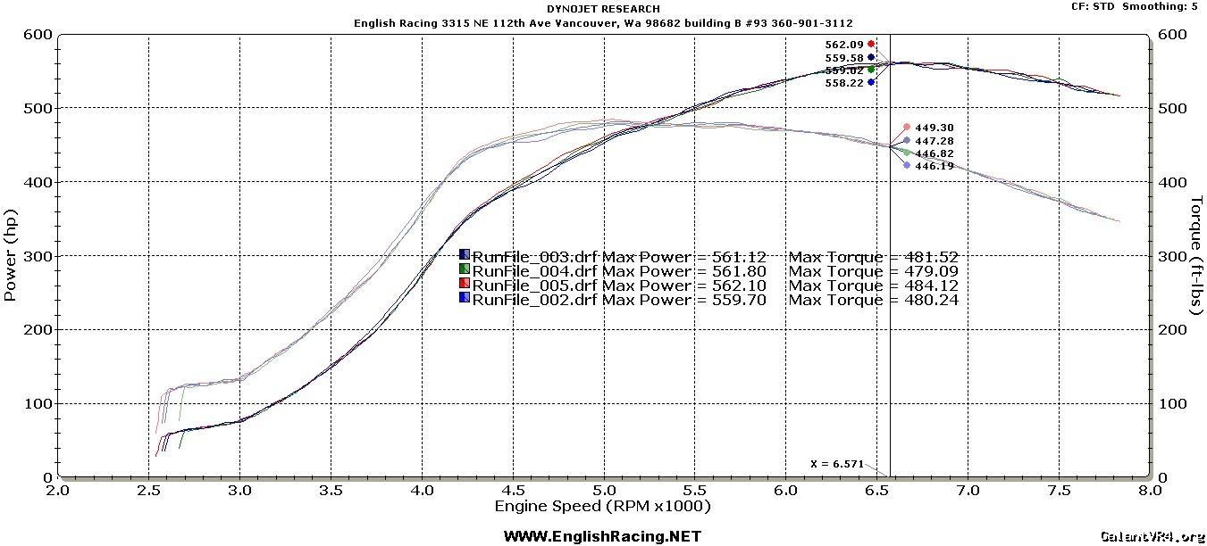

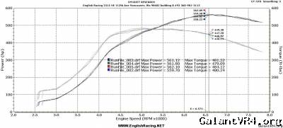

Here is the dyno sheet from my 2.0 3052/HKS272/9.0:1/e85 motor. This motor is now in slugs car
Dyno slows spool done. On the street with dsmlink logs showed full boost 30psi at 3600-3700rpms
