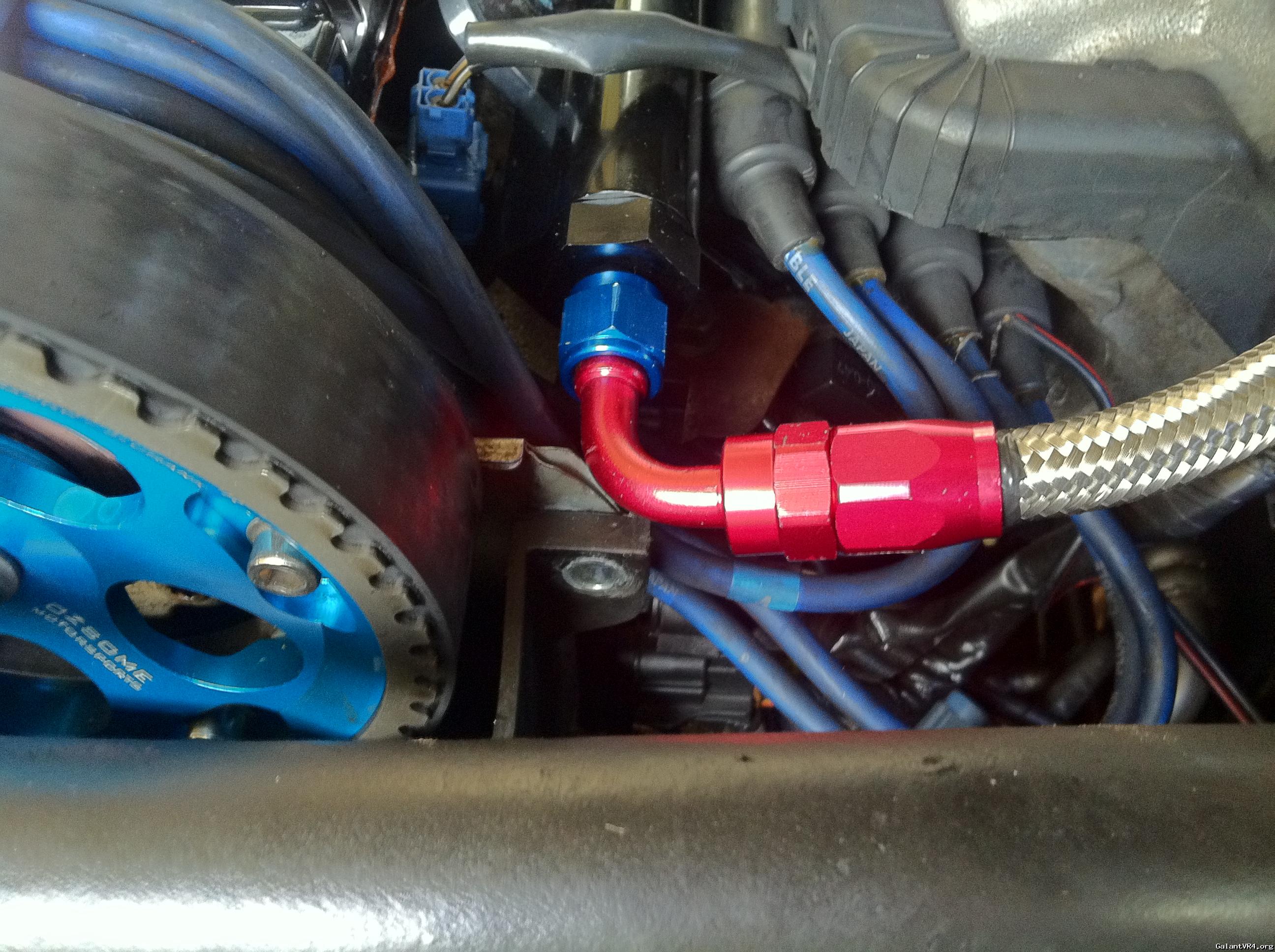

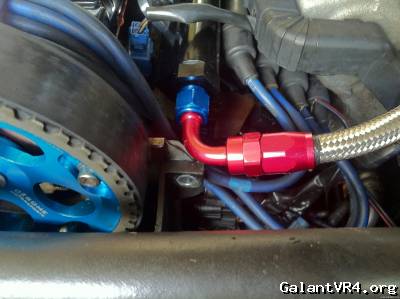

I'd ditch that fitting and get a smaller diameter fitting. That looks like the one from Extremepsi?
It's probably easier to just grab a couple of pushlok fittings and a bit of hose.
This is what mine fits like.
