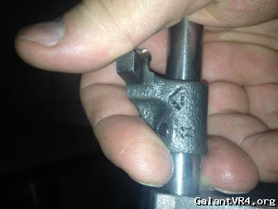

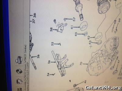

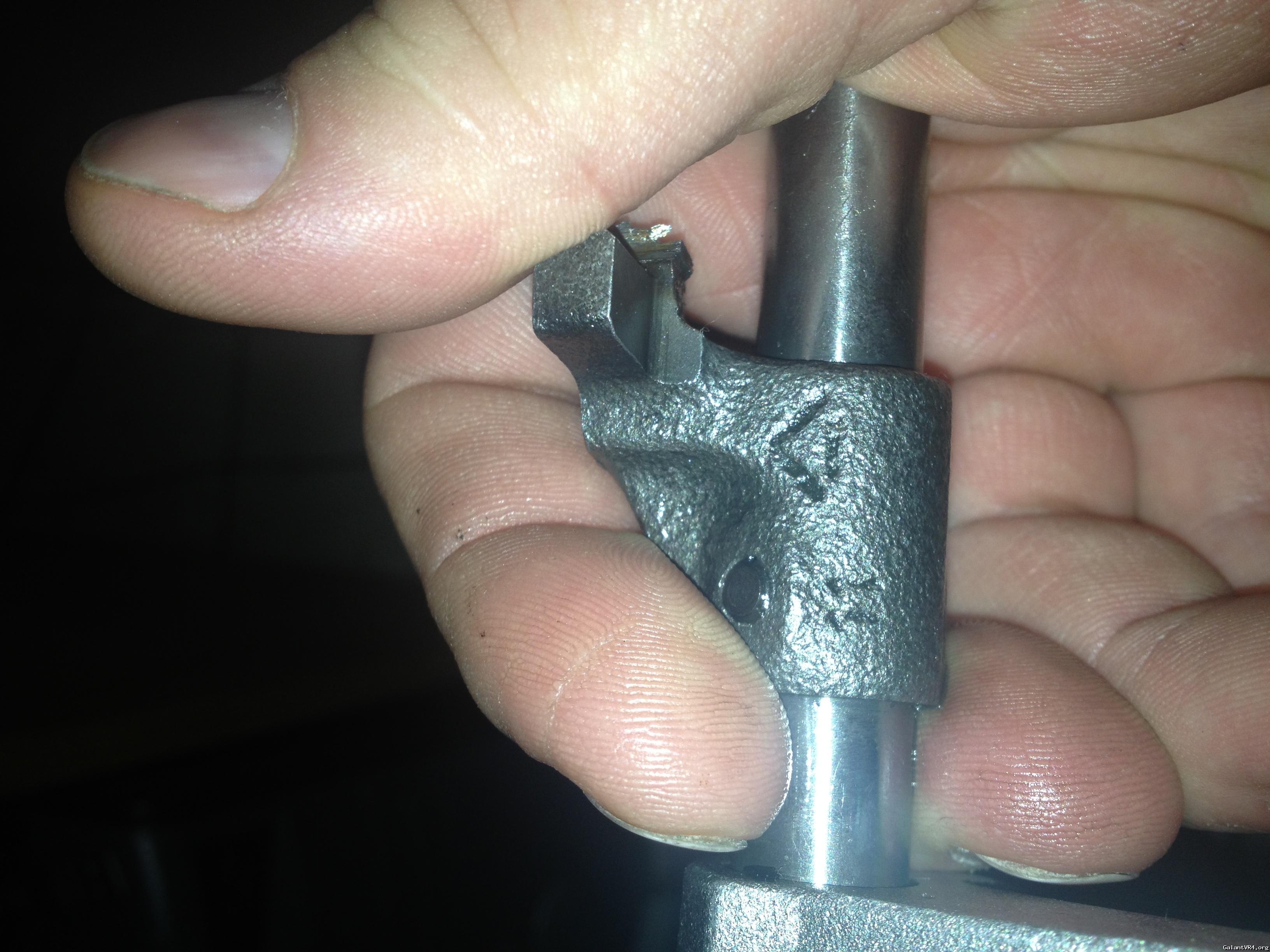

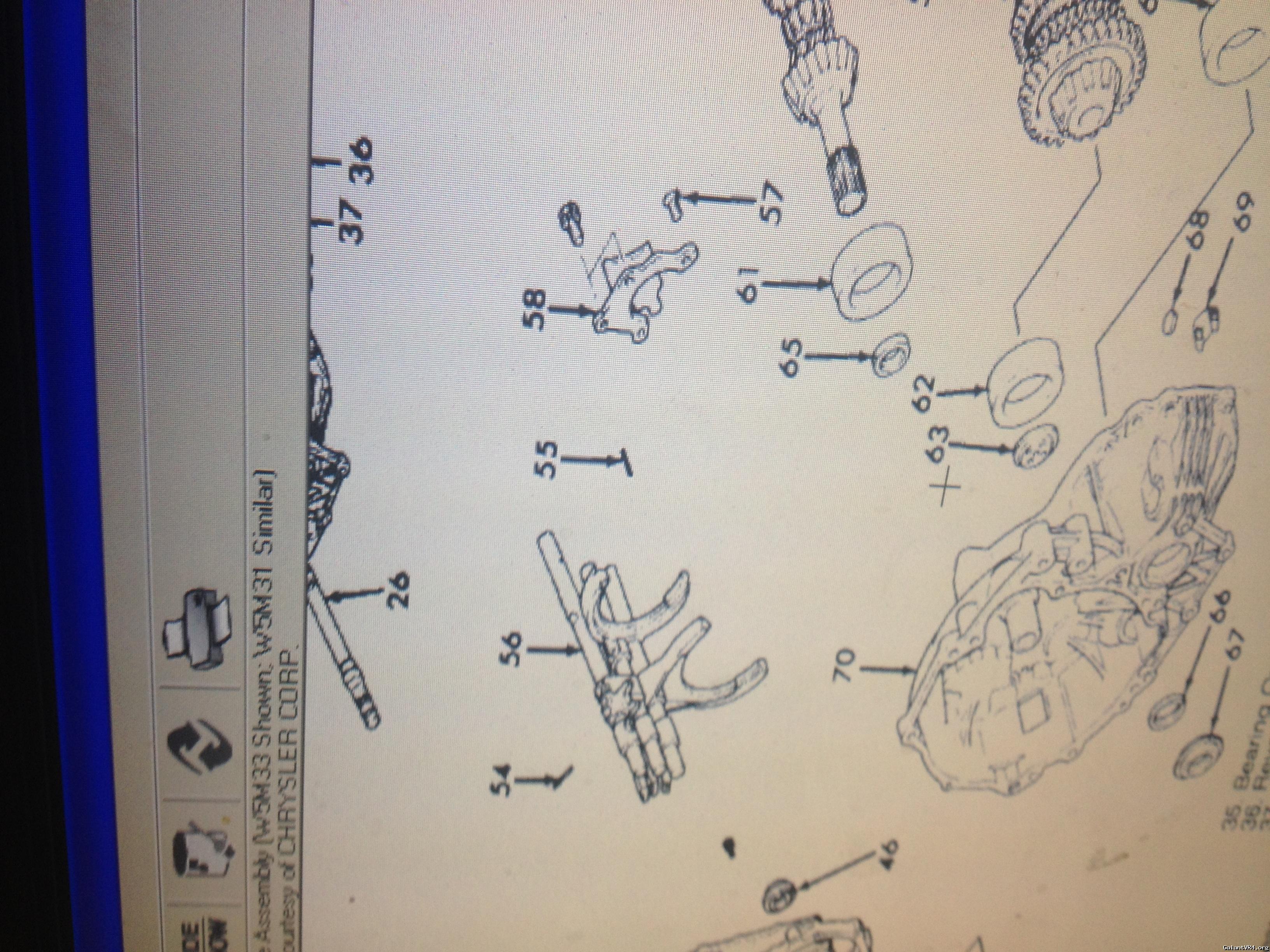

So the mechanic working on my trans can't locate a part for reverse. Here is a picture of it. Does anyone know where I can get it? It is the rod and littler real piece with the number 11 stamped on it.
It's number 56

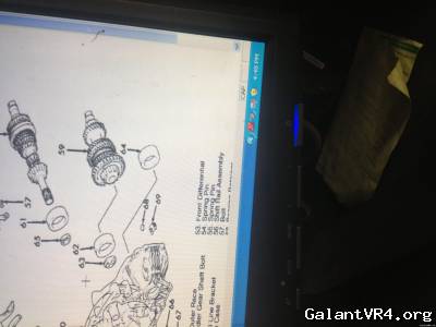

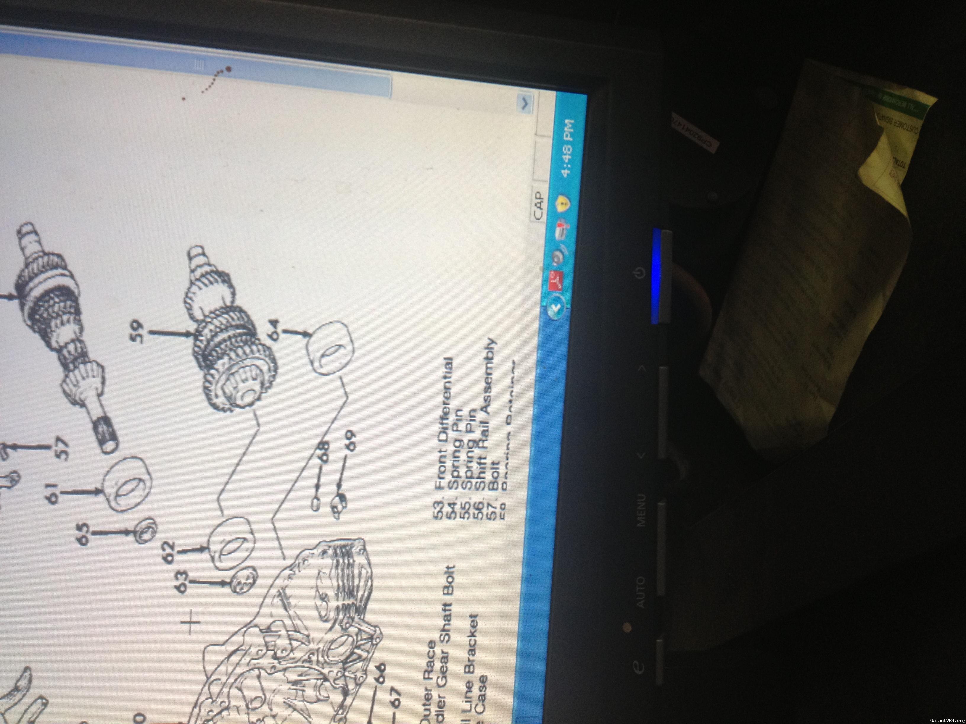

I just used caps to find part number. Will call dealer tomorow. Whn I punch in google search it appears to be available at multiple places on line.

Don't bother trying to replace just the little cast piece that is pinned to the shaft. Just buy the entire 5th/reverse shift rail. Just make sure you compare the new one, to the one you have. I don't remember specifically, but some shift rails have changed over the years.

Sorry if I was unclear, but you are correct. I am looking to replace the entire rail. Will have to wait till Monday to contact local dealer. I will let you know what they charge. When I order it, how will I know if its the correct one? If I am using caps and put my VIN in shouldn't that be the correct one?

Called the dealer and the response was " that part is obsolete and longer available". Thats what you really want to here!!

No. You'll need the shift rail assembly specific to your transmission.
