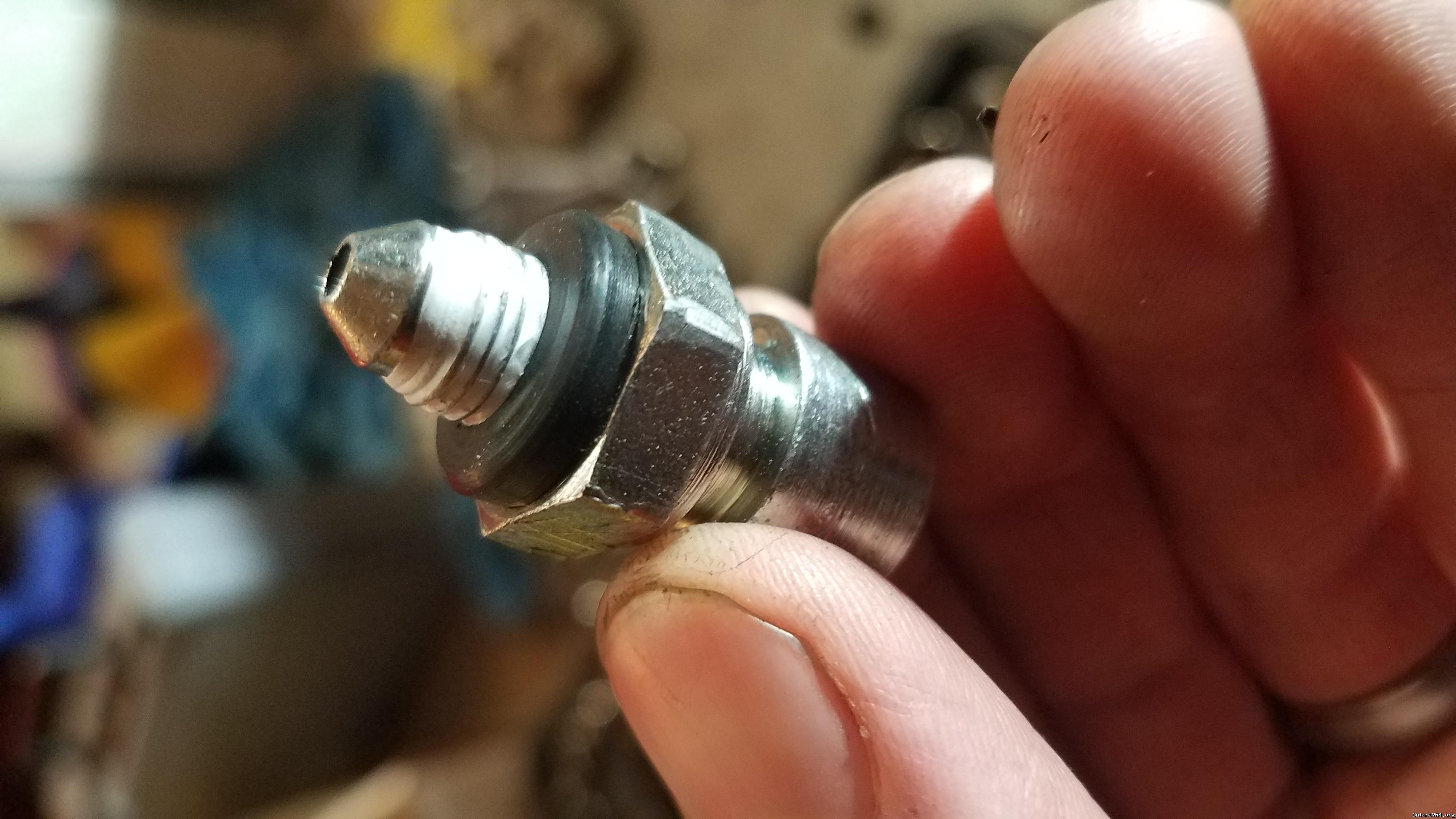

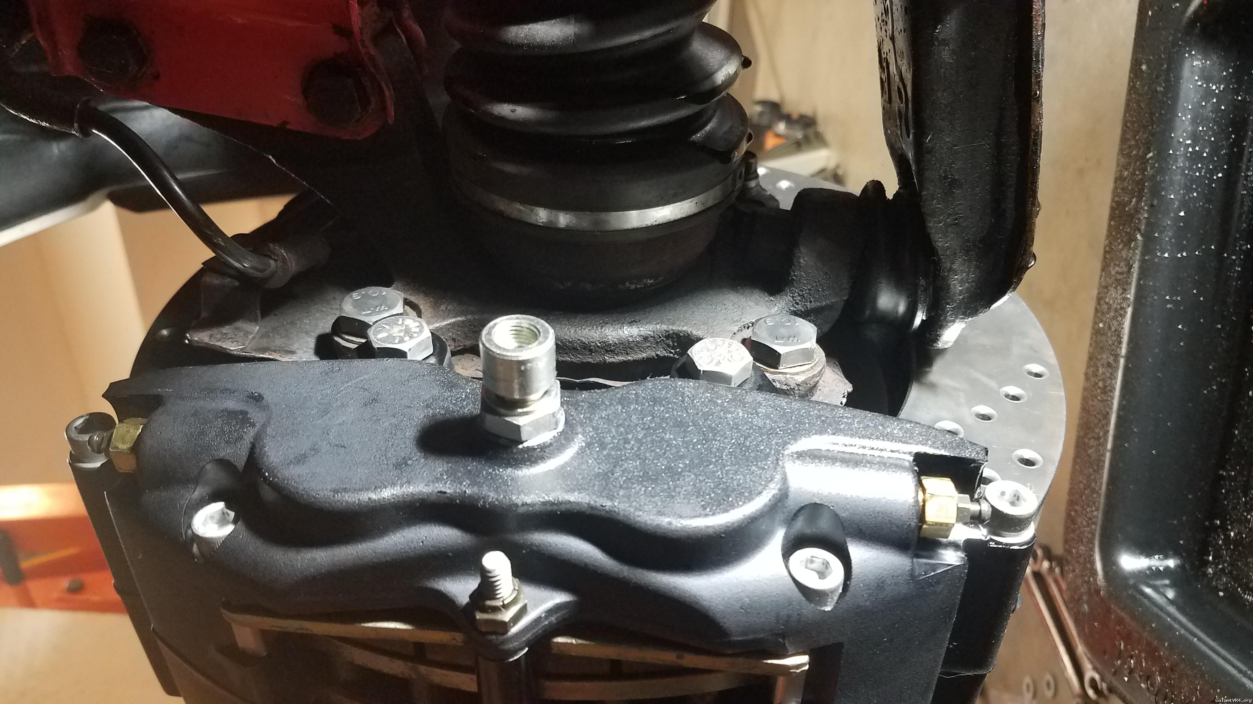

Hey guys, really bummed here. I'm installing a barely used Wilwood brake kit and the passenger side brake line will not tighten. On top of that the fitting won't back out now. It looks like the previous owner stripped it out.
Any advice on how to back the fitting out? Is the caliper trash now?

Used my serious level Channellocks and yanked while twisting counter-clockwise and the fitting finally bit. Unscrewed it by hand and got it off.
New game plan. Rubber gasket and Teflon tape and hopefully she can thread in.

I would strongly recommend you do NOT attempt to fix that with jb weld!
Do you have a better pic of the damage to the caliper threads?

You have to be careful with the fitting on the brake lines you are using. If the Wilwoods are anything like my old setup (currently in use but they are an old style), then the fitting is a pipe style fitting whereby the threads are tapered and get tighter as they thread in ... if you aren't using a brake line with the perfectly matched threads ... it will be disaster. Essentially we are all wondering if the brake caliper uses a tapered seat contact or if the threads are what is doing the sealing.
For example: 1/8-27 NPT

Yes, but only with good proper threads on both parts.
I hear what you are saying too Chris, but unless this is a last ditch effort to get the car one way home, I would never suggest welding parts that way on a hydraulic system.
My lines from Technafit were custom made to my spec, and they fit flawlessly into the threaded portions and lock up at the appropriate depth due to design. That is how it has to be.
Also, no rubber washer style parts can be used if actually attempting to seal fluid from coming out. The threads on a pipe style threaded fitting or the tapered seat (watch the angles there too) do all the sealing of fluid/pressure.
An O-ring/washer has no place on these two styles of systems.
10,992
On other alternative would be to tap the caliper for a larger size pipe thread fitting, then use what is called a bushing to adapt it back down to the original size.
I have never had Wilwood calipers, but I believe the other guys are correct and they use NPT pipe thread size connections, which seal on the threads as Tim the Flying Eagle said.

They do indeed use NPT thread connections. I'm not sure how it got stripped out. My guess is the guy who sold them to me just over-tightened the hell out of em and pushed the brake line connector through the point of when it should have stopped. Oh well, I got the pair for next to nothing. I ended up buying another matching caliper and will cautiously install that one. Thanks for all the info guys.
