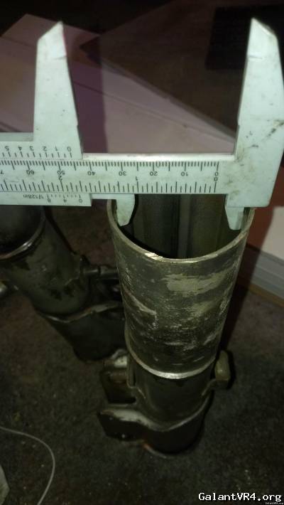

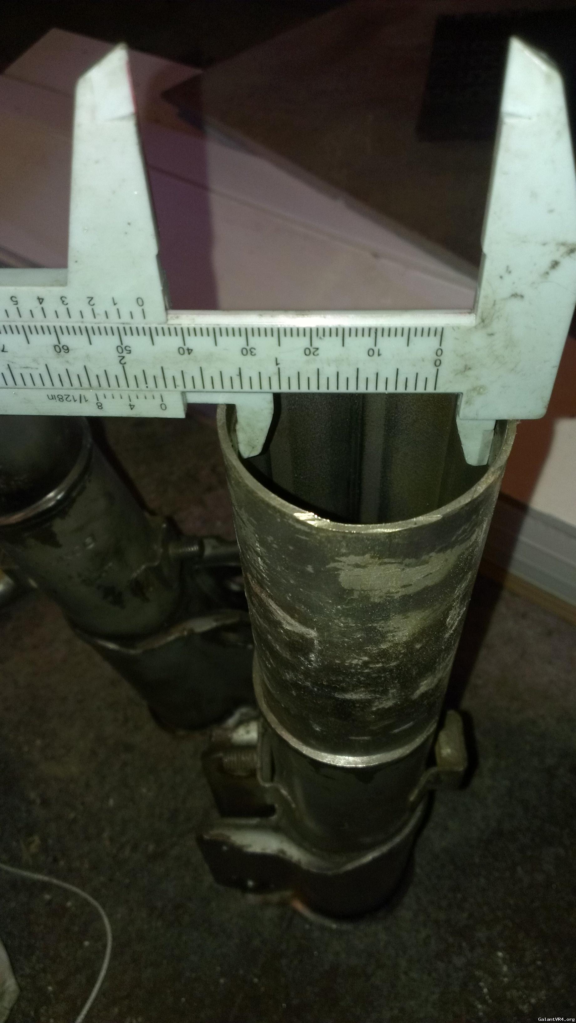

BC racing said that their lower spindle bracket is set up for a 54mm shock body.
So here is the shock for the 3000gt
scaled.php
And here is a KYB GR2 dissected:
Now with a little persuasion using a file or a brake cylinder hone what's the chance this bilstein will fit in here?
