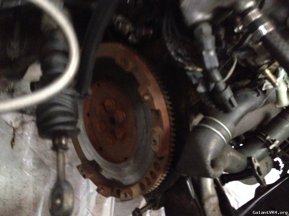

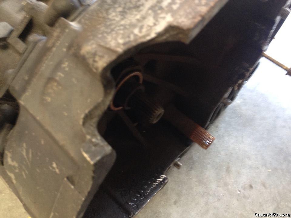

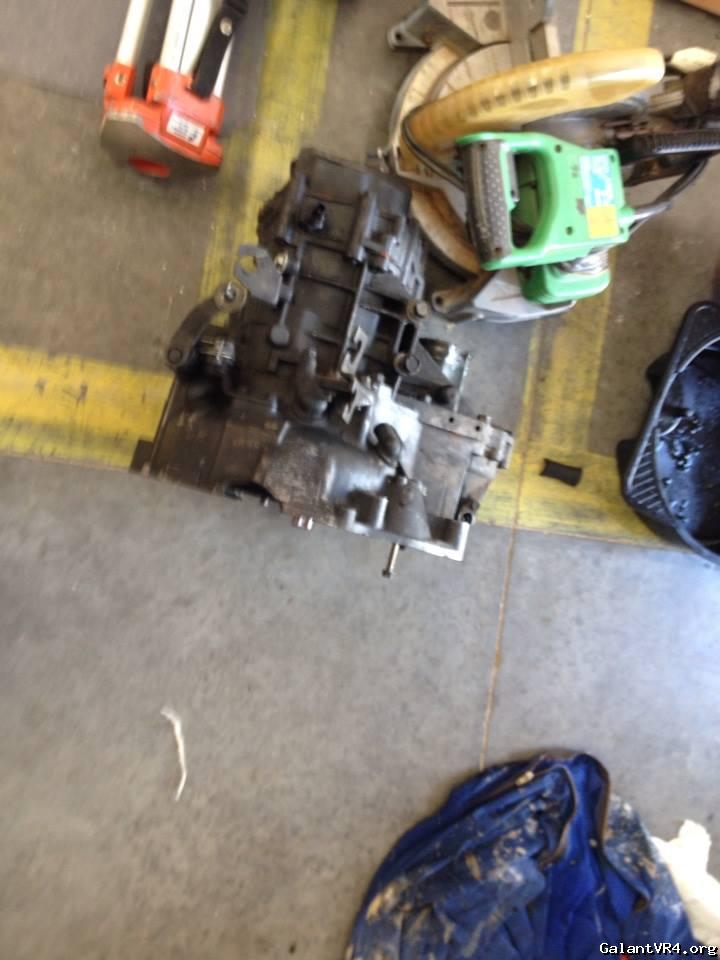

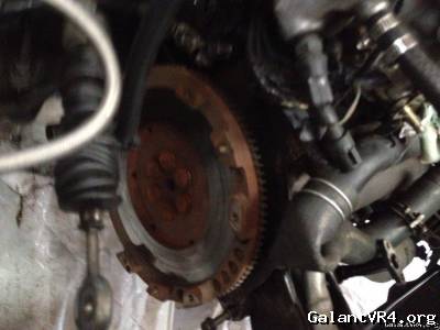

so i pulled the gearbox today one of the top bolts going into the block was missing along with that corner of the gearbox and some were even threaded YAY, look at the state of the fly wheel after having no inspection plate for god knows how long. i have decided to bite the bullet and get rid of all my money and buy the evo rs gearbox t-case and axles. does anyone know if you can use your standard vr4 axles with an evo 3 rs setup maybe i can knock off a couple hundred bucks. quite dissapointed with the previous owner especially after how well the car had been maintained to skimp out on one of the cars weaker points the driveline.
and i thought i was going to have a good day installing this, guess it will have to wait.

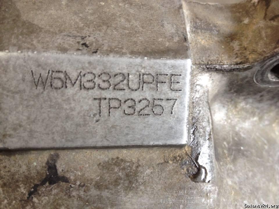

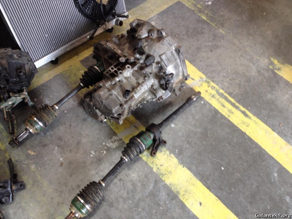

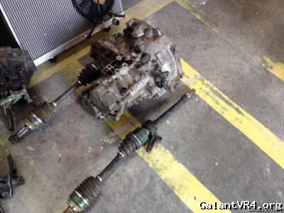

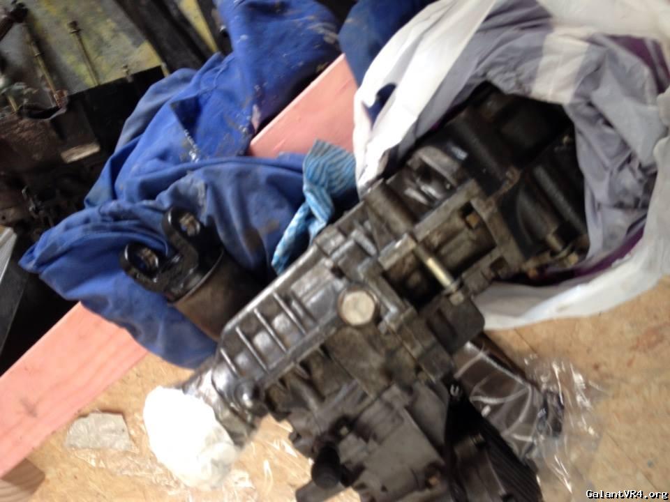

here it is my new (to me) EVO III RS gearbox, transfer case and axles
going to clean it up and paint it tommorow can you pressure wash a gearbox or am i better to scrub it and whats a good paint, hard wearing would like a standard alluminum look.
also the evos had three mounts on the gearbox and the one on the timing side of the engine, was told by the person i brought this of was because the bell housings weren't strong enough to take the loads created by having one mount on the gearbox and 3 on the block, can anyone confirm this and wether or not the evo cross member will bolt up, it looks similiar and comes with new polyurethane mounts so if it works ill buy it for cheap and free up some room under the turbo.

All of your mounts will stay the same. You will still use the 3 on the engine and one on the trans. Just remove all mounts and brackets from the evo trans and bolt on your vr4 parts.
You will be using the stock vr4 cross members as well. Only parts from the evo you will need is the trans itself and the transfer case. Also, you may need one of the axle cups from the evo axle for the front lsd. I'm sure someone else will chime in to confirm this.

yea understood that but was more looking at wether the evo crossmember will bolt up so i can use the evo mounts

It won't bolt up. You could use the front mount on the box but you would need to weld a new mount to the front crossmemeber to make it work.
It would free up a lot of space under the turbo though!
