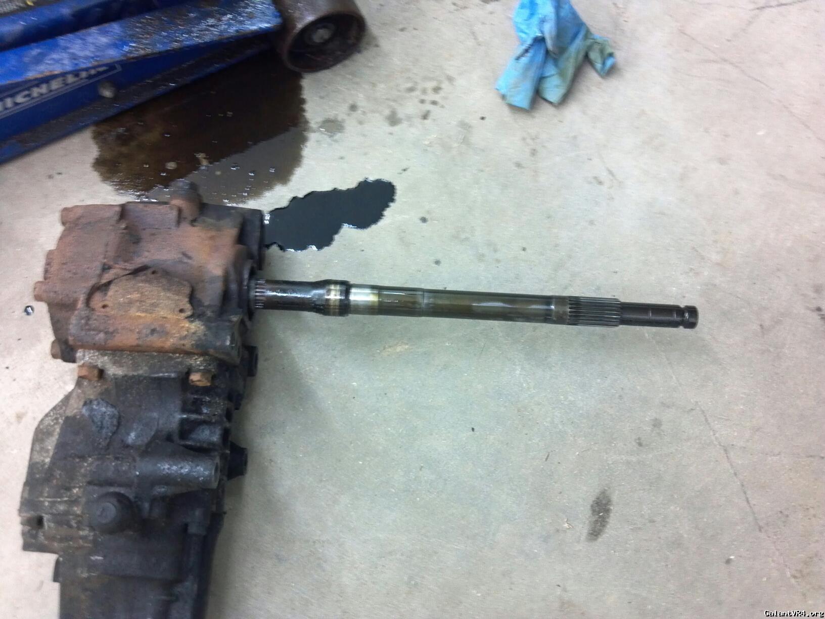

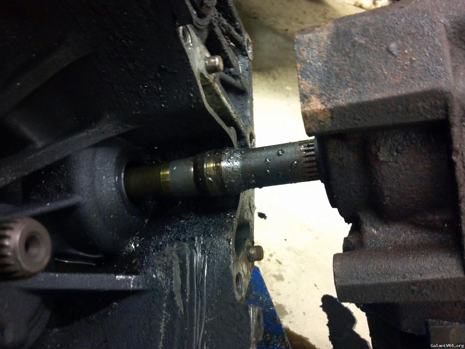

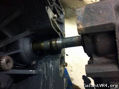

Started to tear things apart, and while tearing my Tcase off, the center diff came out with it.
So, parts had to be purchased.
