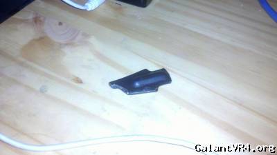

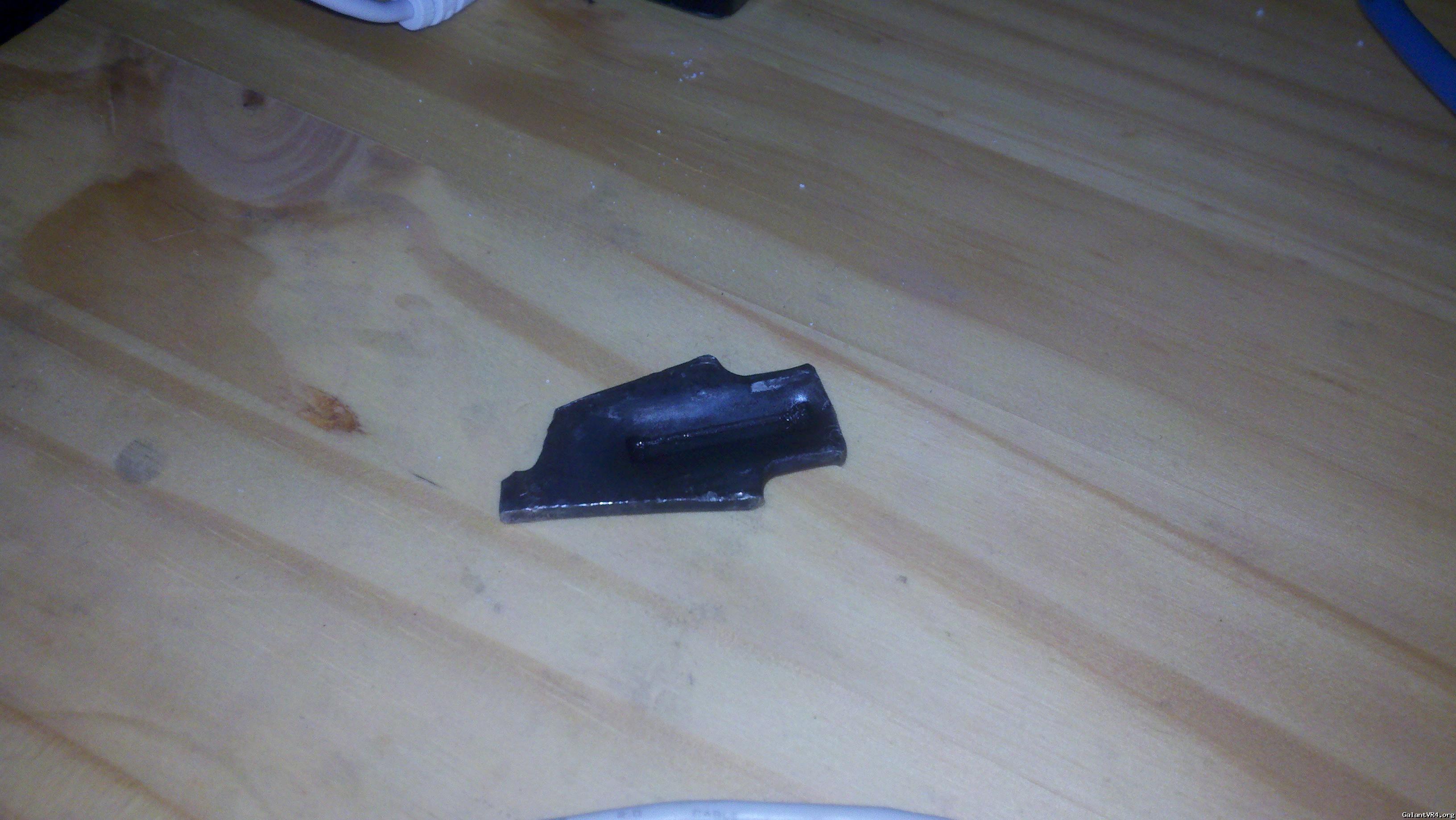

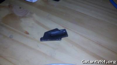

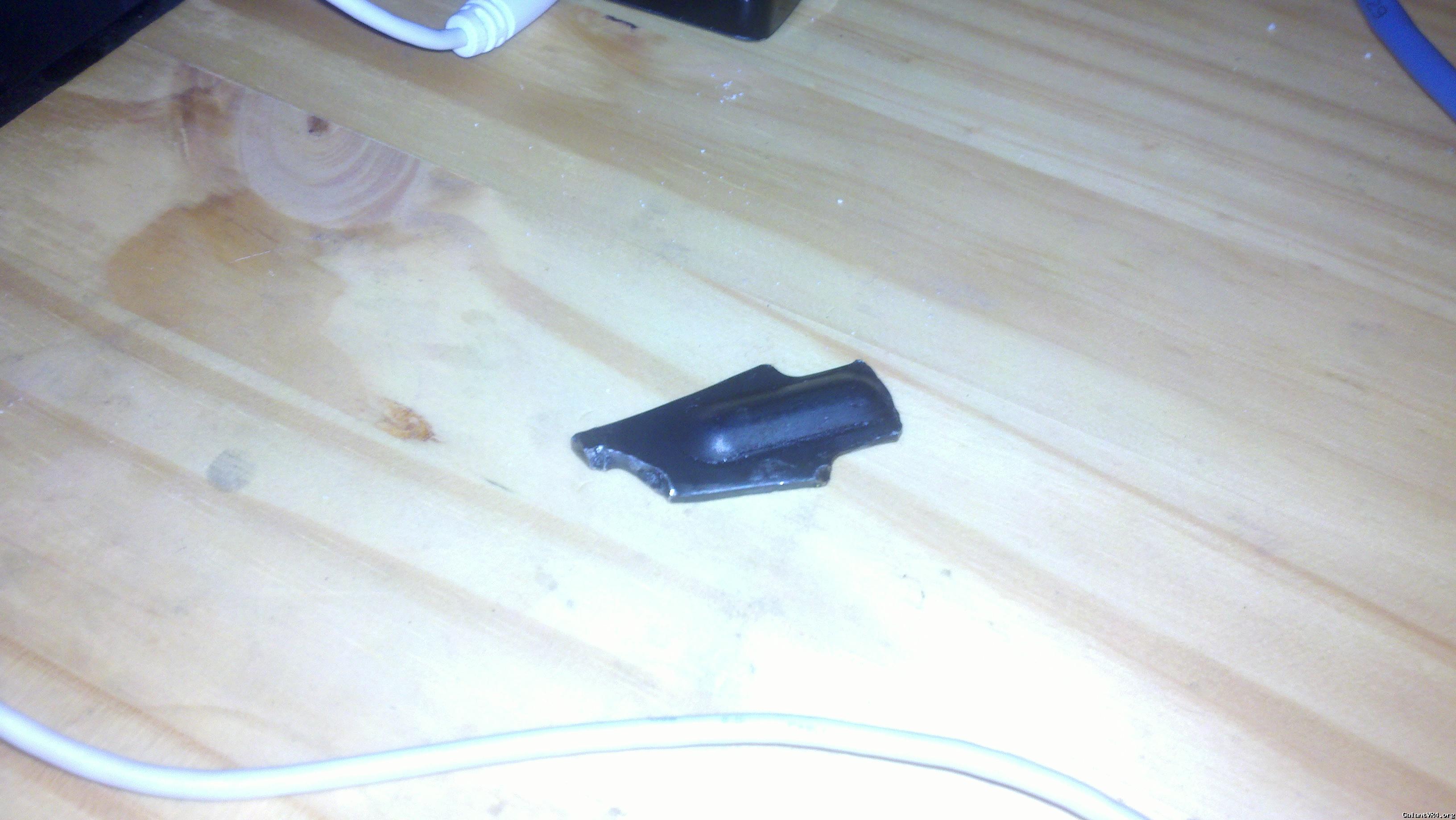

So I was helping my buddy with his 99 GSX and he was having a "can't get into gear with engine running" problem. First thought was bleed clutch/replace slave cylinder. Did that and adjusted the master cylinder. Still nothing. So I crawled under there and pulled the fork boot away from the tranny and this piece came falling out. Any ideas?

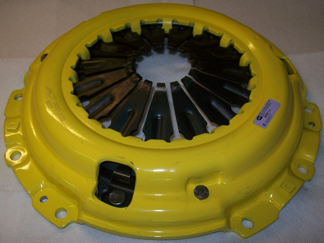

Piece of a pressure plate spring/tang?
What is it made of? It's really hard to tell in the pics.

Sorry for wasting space I thought this was going to be a lot harder to figure out.
To confirm what's wrong it definitely looks like part of the pressure plate.
