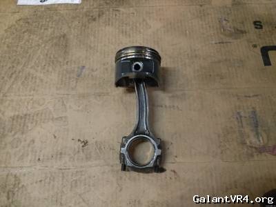

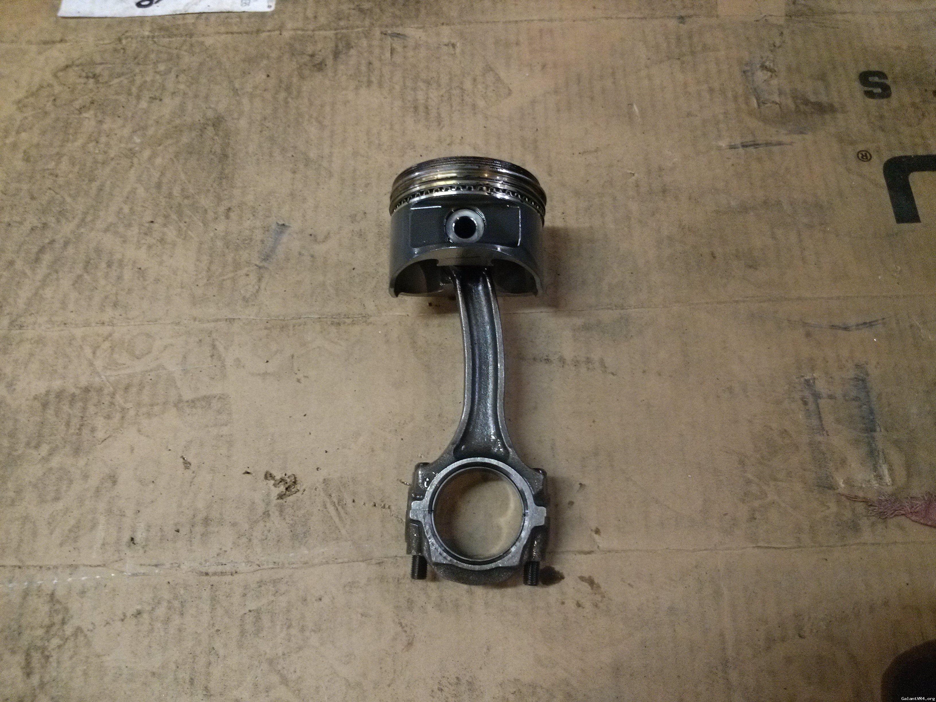

I've broken a lot of parts over the years but this is the first time I managed to do this. The power wire to the boost controller had a fuse with a spring and a bundle of wire all together thanks to whoever installed it and the spring has gotten weak enough that the wire pulling on it cuts power which allows as much boost as possible. I don't know how much but the gauge goes to 30psi and it went way past that on 93. It started to overheat so I thought headgasket. Apparently it was more.
I am on the fence with what I want to do. I'm thinking of a cheap set of eagle rods for now and building a stroker over the winter. Then I can use this motor in my daily and put a bigger turbo on the race car. I've already missed on race so I need to get it going before the next.

boost controller is a blitz dsbc. When it in actuator mode it goes to spring pressure without power but in external mode apparently thats not the case. I'm removing the fuse altogether and wiring it in straight to the radio power wire and use that fuse. Car doesn't have a radio. If I still have issues I'll buy a IR solenoid and use dsmlink to control boost. The blitz does an awesome job when it works. No spikes, no drop off just rock steady. I need to make sure its still set for external. I suppose the switch could have got bumped when my buddy was wire tying everything up out of the way but I doubt it.

The stock rods are supposed to be good for a decent amount of power but there is no cushion of safety for if something goes wrong, hence the banana I have now. I'm sure it could have been way worse so I decided to get better rods. I've built a few cars for people with eagle rods and had them be very happy but I've heard of a lot of people having them break and my machinist says there quality control isn't up to par with the more expensive rods. I trust his opinion based on the amount of engines he has built in his life. Drag racing is one thing were your making power for 10-12 seconds but I want to be on track making 500hp for 30 minutes at a time and not have to worry about flying parts from the block. I work on cars all day almost everyday and don't like working on mine anymore so the less time I spend taking it apart cause I'm not happy the better. A friend of mine last night told me he just recently removed a set of eagle rods from a motor just to get piece of mind and that was the deciding factor for me.
