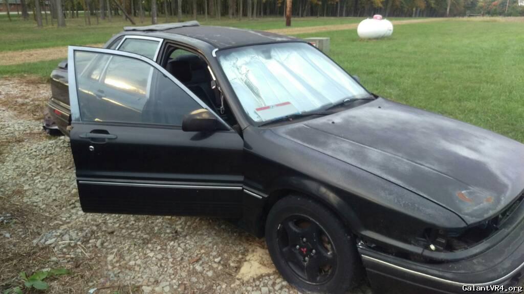

After a few years away from the 4g63 world, I found myself back in the depths of its grasp.

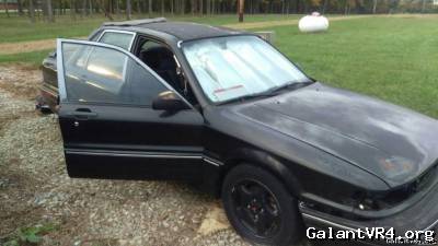

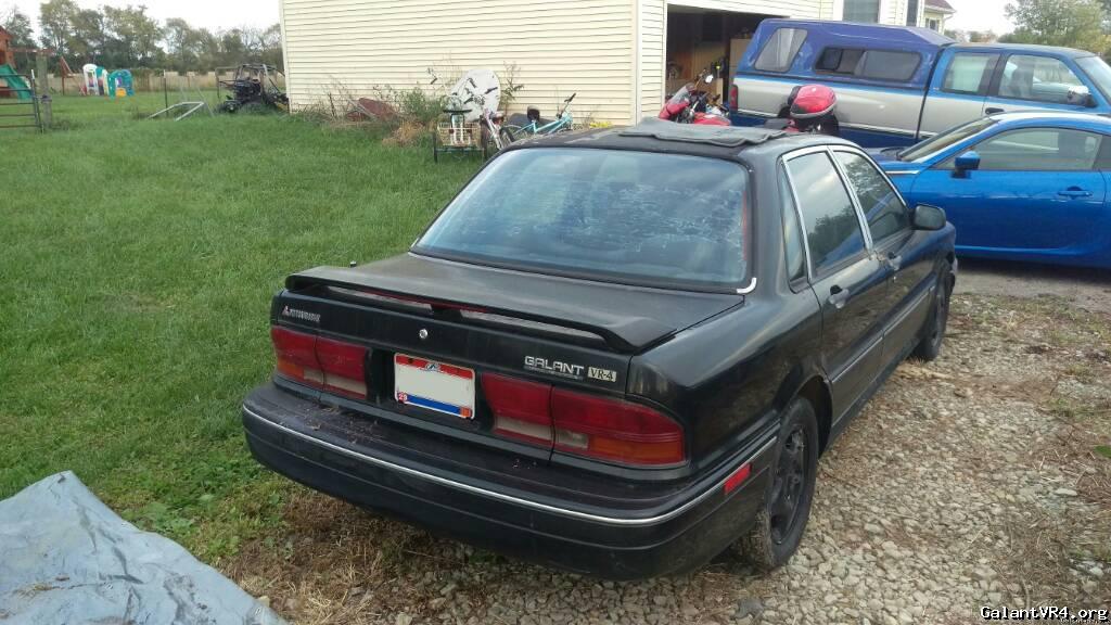

Last Saturday I took a trip South and picked up another gvr4. #1193/2000 to be exact. It's been sitting practically it's whole life, which is a good thing and a bad thing.
A little back story, it was purchased new by an elderly lady in 1991 and driven for a few years until a tree fell on it causing some damage to the roof. She decided to sell it and the second owner decided to half ass repair it. He then drove it for a couple years and sold it to the gentleman I bought it from, where it then sat from 2007 until last Saturday.
The car has some bad paint fade, roof needs work, and needs most rubber components replaced, but it's 100% rust free(minus the roof)

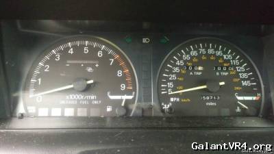

Here are some pics

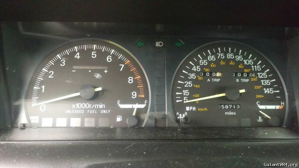

yes, 58k original miles
Now it definitely needs work, i plan on replacing the complete roof with a cut from a sunroof car, but for the price, and the fact it only has 58k miles on it, it's well worth it to me.

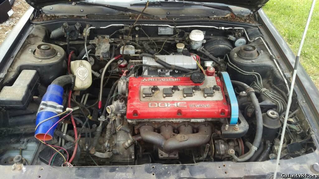

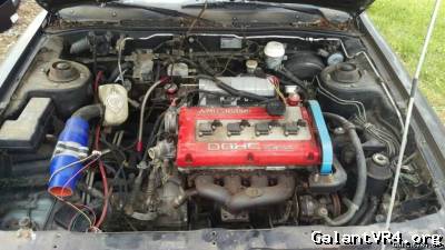

Looked over alot of things with the car yesterday, it has a lot of quality parts on it.
Current mod list:
ETS fmic
Walboro 255
fic 850's
Burshur 3" downpipe and catback
Evo3 16g
Ported and polished intake manifold
FP cast exhaust manifold
Dsm link v2.5
Stainless braided fuel line
Aeromotive fpr
Aeromotive fuel filter
May be more once I dig in further

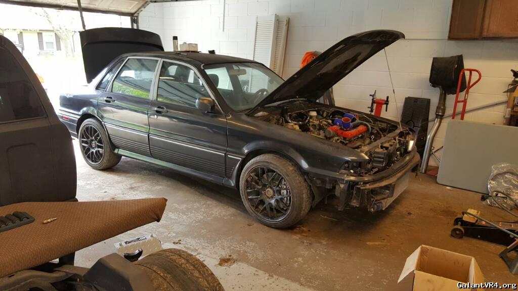

Finally got it in the garage. Cts-v brake swap and 5 lug will be underway next weekend. Should be running and driving in a month
ShaggyTE
Nov 6, 2003
421
Omaha, NE
Buy a kit for the brakes or something you're fabbing up yourself? Sounds good so far, good luck with it!
TurboDSM
Mar 7, 2012
58
Merica
no kit. I had some cts-v calipers already, used 1g knuckles since they bolt on, 94 cobra 330mm rotors, and a 5mm spacer and they fit perfect.
Pulled the valve cover expecting a mess, but the head is pretty clean, especially from sitting for 11 years

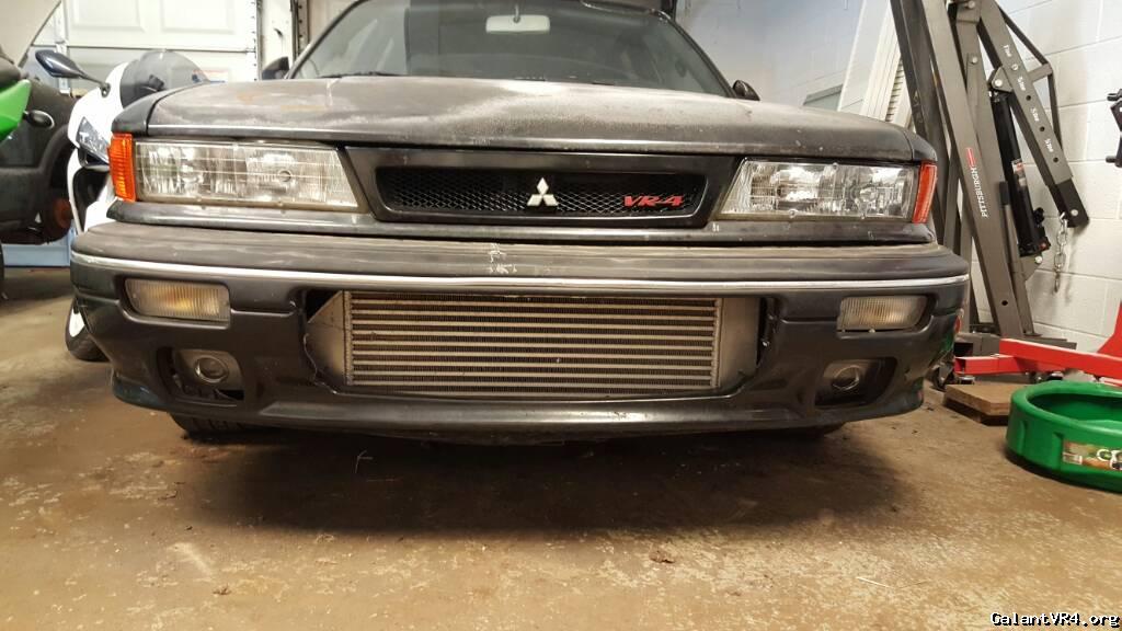

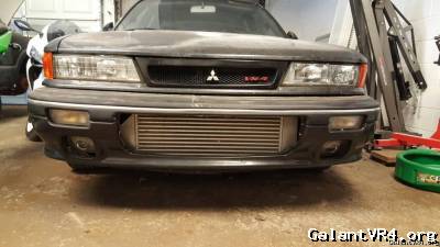

Kinda started to do some work to it. Got my 5lug swap complete and cts-v brembos on. The car is actually a lot cleaner than expected. Hopefully start getting the turbo stuff on it and possibly start it in the next month or so.
This front bumper is trash, but i dont really want to put much money into appearance right now, so it'll do.

98 cobra 330mm rotors and 5mm spacers. I'm gonna try milling the knuckles and caliper mounting holes a little so I can get away with not having the spacer. The wheels poke out way too much for my liking.
