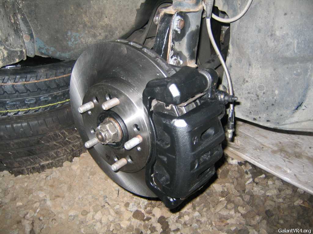

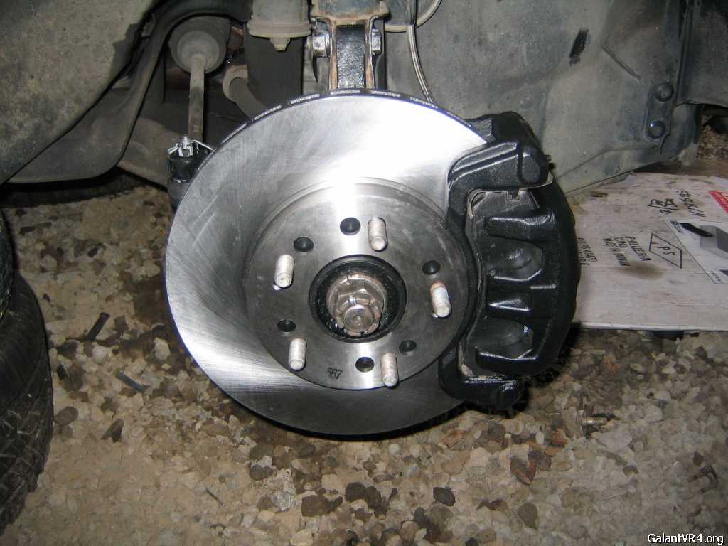

Calipers media blasted and painted w/ 500 degree duplicolor engine paint. Rotors are brembo blanks and the pads are axxis ultimate ceramic/kevlar pads. My friend bought this setup for his Si, and I was extremely impressed so I bought it up. I picked up evo8 wheels for a good price so I swapped in the 5 lug spindles (what fun). I bought all the brake parts from nopi - and the prices were pretty good I thought. It was $250 for everything shipped to PA.
5 lug rotors:
BREMBO Vented Rotor - L/R Front ALL 4WD Turbo Mdls. $43.38 - nopi part #437+0682
BREMBO Solid Rotor - L/R Rear - ALL Mdls. $33.78 - nopi part #437+0745
brake pads for 4-lug and 5-lug spindles:
AXXIS ULTIMATE Brake Pads - ALL AWD Turbo Mdls - FRONT $40.39 - nopi #655+0760
AXXIS ULTIMATE Brake Pads - ALL Turbo Mdls - REAR $40.88 - nopi #655+0763

looks a little better now than it did.
