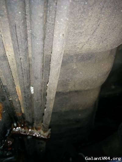

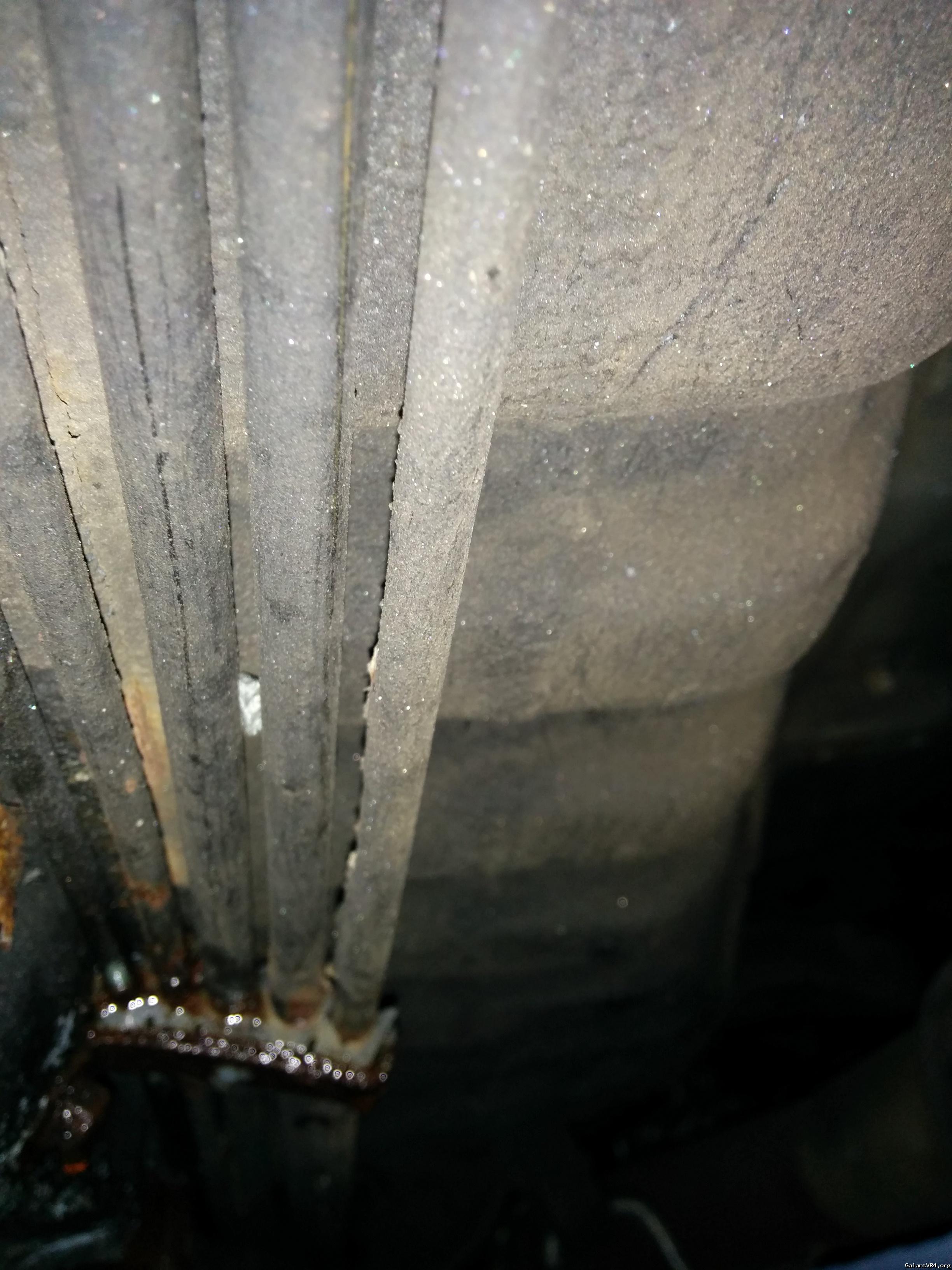

Well drove the car today everything is fine and great, I turn up the block to my house brake pedal goes all the way to the floor,
I look under the car and the 4 line on the driver side looks like they are leaking
Picture attached.
How do I fix this?

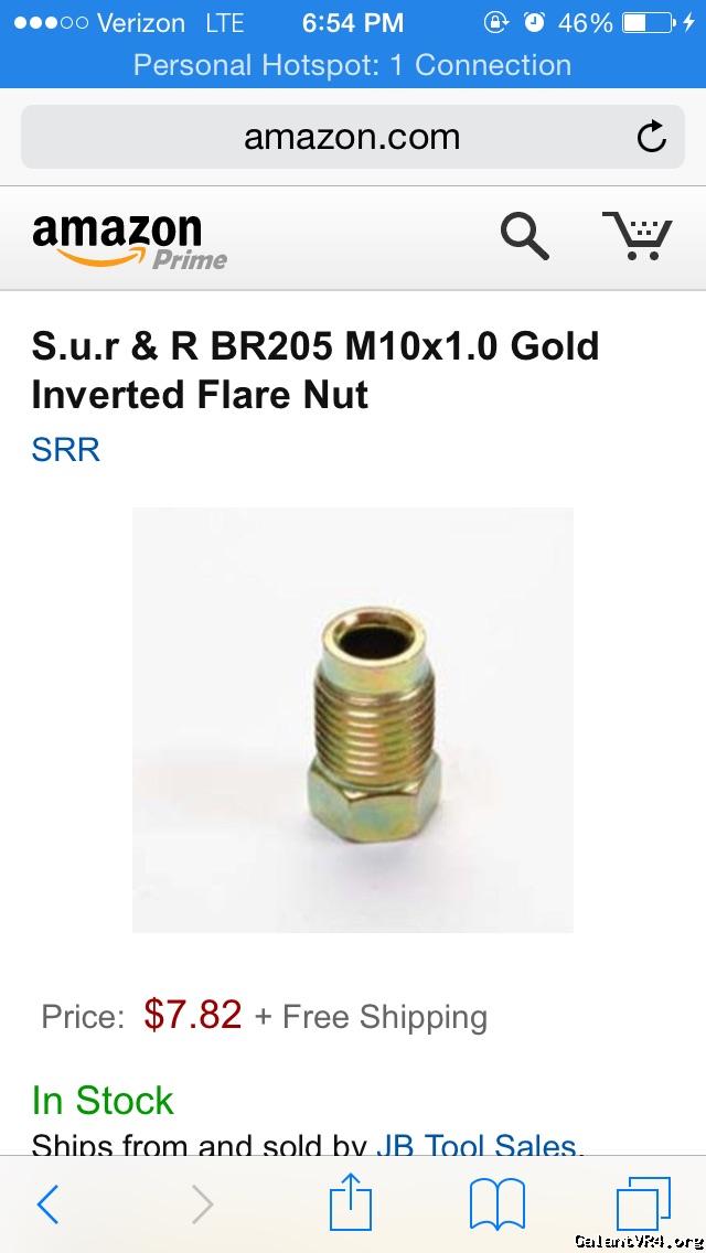

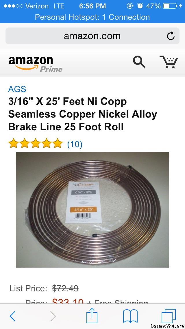

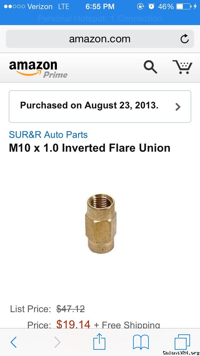

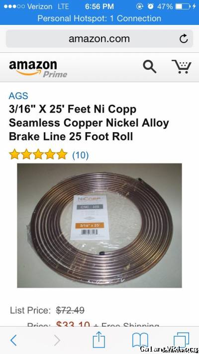

i used the following parts. you can fix it up to where the leak or to the brake bias splitter.
be careful too because the two other lines might be crusty and its for fuel.
you will also need an inverted flare tool.

I see you are in CA. When I was doing the mechanic thing in the midwest, it was very common to pop the rest of the lines after repairing a line. It didn't happen every time, but be prepared for this.. Fix line, pop another, fix that one, pop another... and so on.
