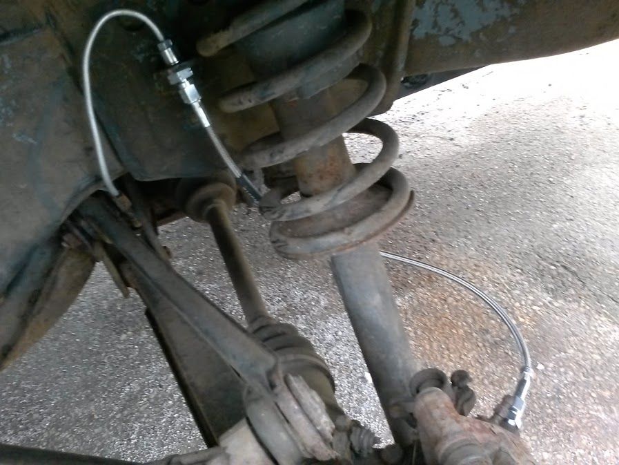

2 lines and 4 fittings, $60 shipped from summit racing. ill look up the part numbers if you are interested.

Very interested, thanks for the Picture also!!

here u go
this goes in between the two fittings and have -3 an ends. if you have a lowered car u want less line
they have 8" and up ss lines, click on the Product Line in the overview then narrow down your search.
this goes between the caliper and the ss line
Male -3 AN to Male 10mm x 1.0
this mounts on the body inside the wheel well and goes between the stock hard line and the ss line
Male -3 AN to Female 10mm x 1.0
everything above is 53.80 before shipping from summit racing dot com
