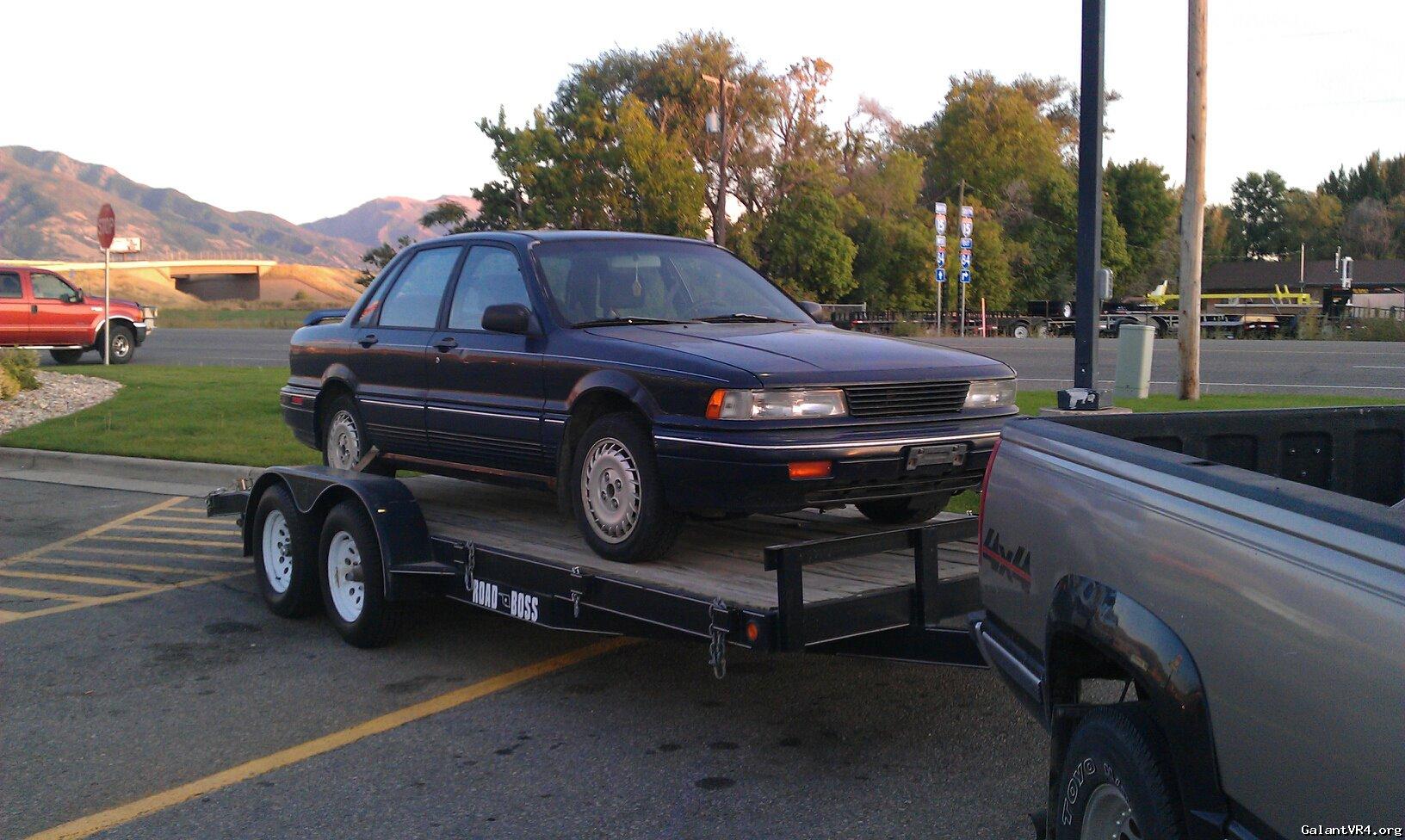

Bought a '90 Galant GSX
I have enough experience with DSMs to be dangerous, but rather unfamaliar with this oddity. Bought a 1990 Galant GSX for 400 bucks. Lots of hear-say with this one, so im here to get the truth on interchange. Its staying non turbo, but needs more LSD... (open light rally car in the works).
my question is what are the differences? Im assuming that a 1g dsm transmission and rear end can direct swap, at least from how it LOOKS. Im hoping someone has had one before. The transmission numbers did not match some other normal transmissions, but its looks the same. So im hoping its just internal differences, and transmission to transfer case spline oddities.
