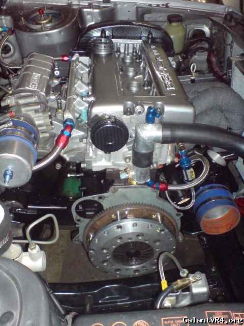

Boost leak tester
Is this a good place to test the throttle body for leaks and if so how much psi can be entered without damaging
the seals in the TB. I figured on putting it over the turbo inlet and running 10-15psi there instead what do you think
Engine pics courtesy of bazeng pics lol
Im not terribly experienced with boost leak testing, but it would seem to me that you could test it up to the boost level you will be running on the car. If that blows the seals then you would have had a problem later anyway...... /ubbthreads/images/graemlins/dunno.gif
The turbo is the "normal" place to do it, but I don't see any problems with the placement there.
10,992
Put it where you need to to test what you want to test. If you are just testing the intake manifold and tb, then that location is fine. If you are testing the whole turbo tract, then do it at the turbo intake.
Thanks for clearing that would you run the same amount of pressure
at the tb as you would at the turbo inlet though was what i was asking?
I dont want to blow out any seals in the tb plan to do 15-20 psi test
at the turbo inlet.
