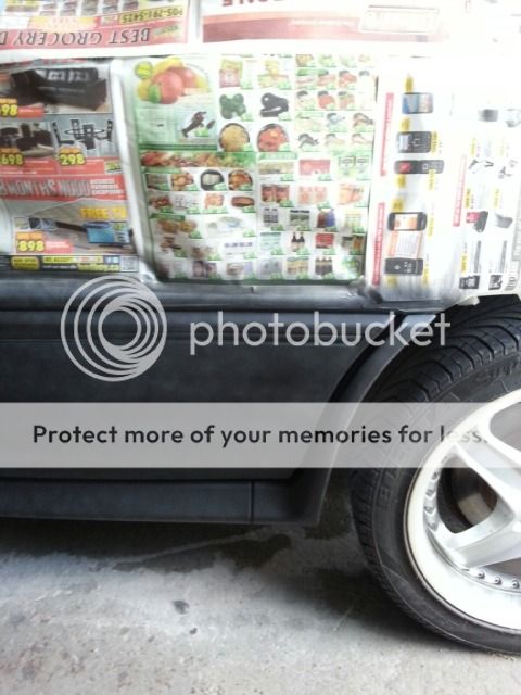

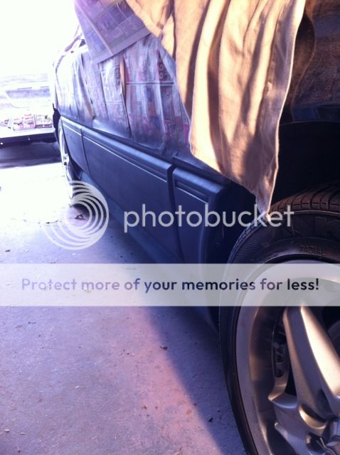

Finally got around to doing this.
Here are some pics for your viewing pleasure.
Keep in mind this was my very first body work attempt.
This one was between coats
Almost done
The only thing I had issues with was when I sanded the cladding itself it's fibrous. So here's always pieces sticking out. You can see it in some if the pics
Random plasti dip pic. My bro's lancer. We welded the spoiler holes and emptied 2 rattle cans on it.

Looks good man. I was thinking about doing that to mine. How much bondo did you use? How much do you think they weigh now and do you think there might be issues with the clips holding them on due to the added weight of the bondo?
mr.mitsu
Apr 28, 2003
798
canada
I used about one and a half of the small tins. In total, I'd say about 2-3lbs each door. I don't think there's too much weight on those clips /ubbthreads/images/graemlins/smile.gif
