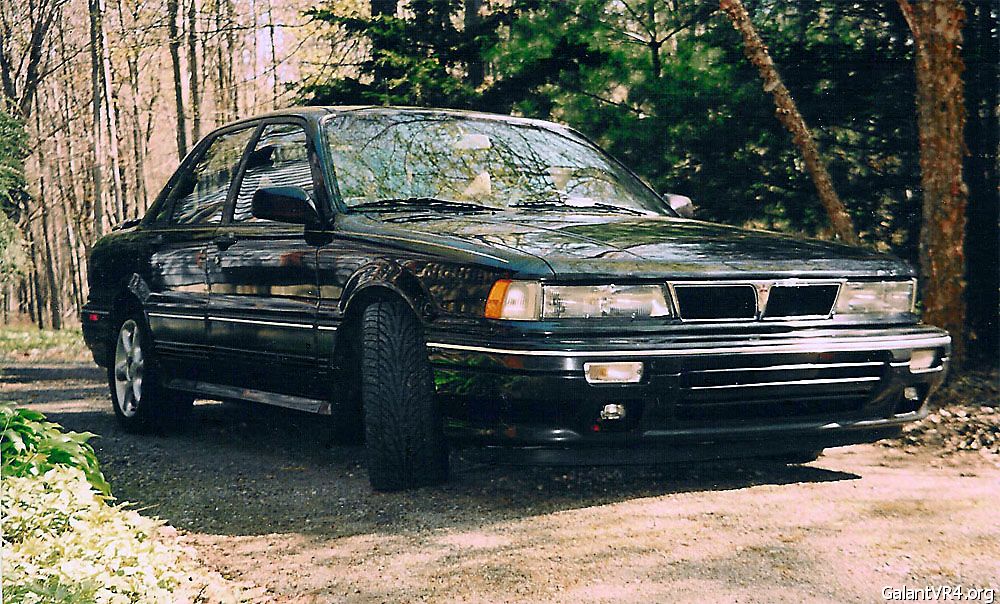

Bob in Chicago's GVR4 with Beige Interior SOLD
Bob in Chicago's 1991 Galant VR4 was SOLD 12/1/07
#1072 of 2000 with unique beige leather interior.
Purchased 1994 with 47,000 miles, driven daily now at 204,000 miles.

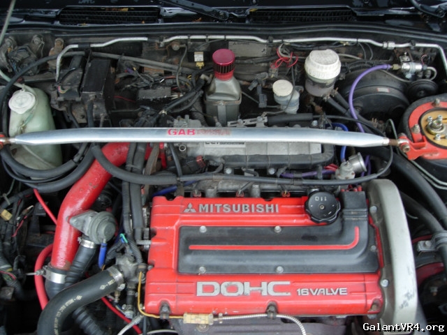

Engine:
2.3 liter stroker done by AMS at 177,770 miles
Dyno: 338hp and 342ft-lb torque at wheels, 18psi pump gas 3/27/06
Head rebuilt and ported by Forrester; intake manifold port matched
HKS 264 cams; NGK BPR7ES plugs
8.5:1 Ross pistons & Eagle forged rods
Precision SCM-5031RE turbo, ball-bearing 50trim, 34mm internal W/G (March '06)
2G Exh. manifold porting by AMS; stainless studs, BMW nuts
2G MAS with custom Keydiver chip
680cc PTE injectors
Greddy Profec B boost control set to 18 psi
Apexi SAFC piggy-back fuel adjuster
Dejon 3" intake; K&N filter in custom cold-air box
Easily removable right front corner lens, modified as a fresh air inlet
RRE Front-mount Griffin intercooler and piping; Crushed BOV
C&R custom radiator
Underdrive pulleys; blocked EGR
'90 oil filter housing and remote oil cooler
255lph Walbro fuel pump
Hahn 3" stainless O2 housing eliminator down pipe
3” test pipe, resonator or Random hi-flow cat. convertor
3" cat-back stainless steel Certified exh. system with Magnaflow muffler

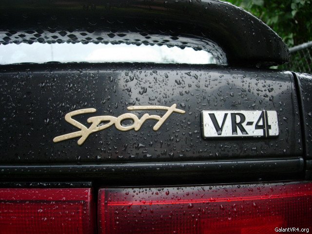

Galant badge removed from right side of trunk lid, replaced with "Sport"

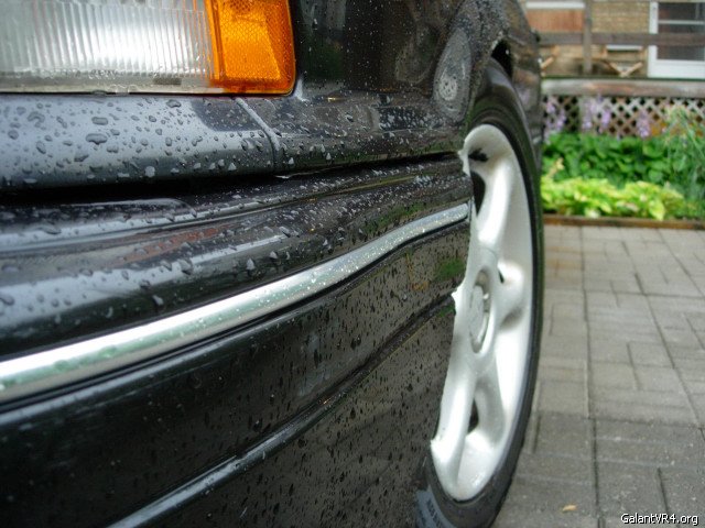

Custom 2" chin spoiler made from landscapers brick edging
