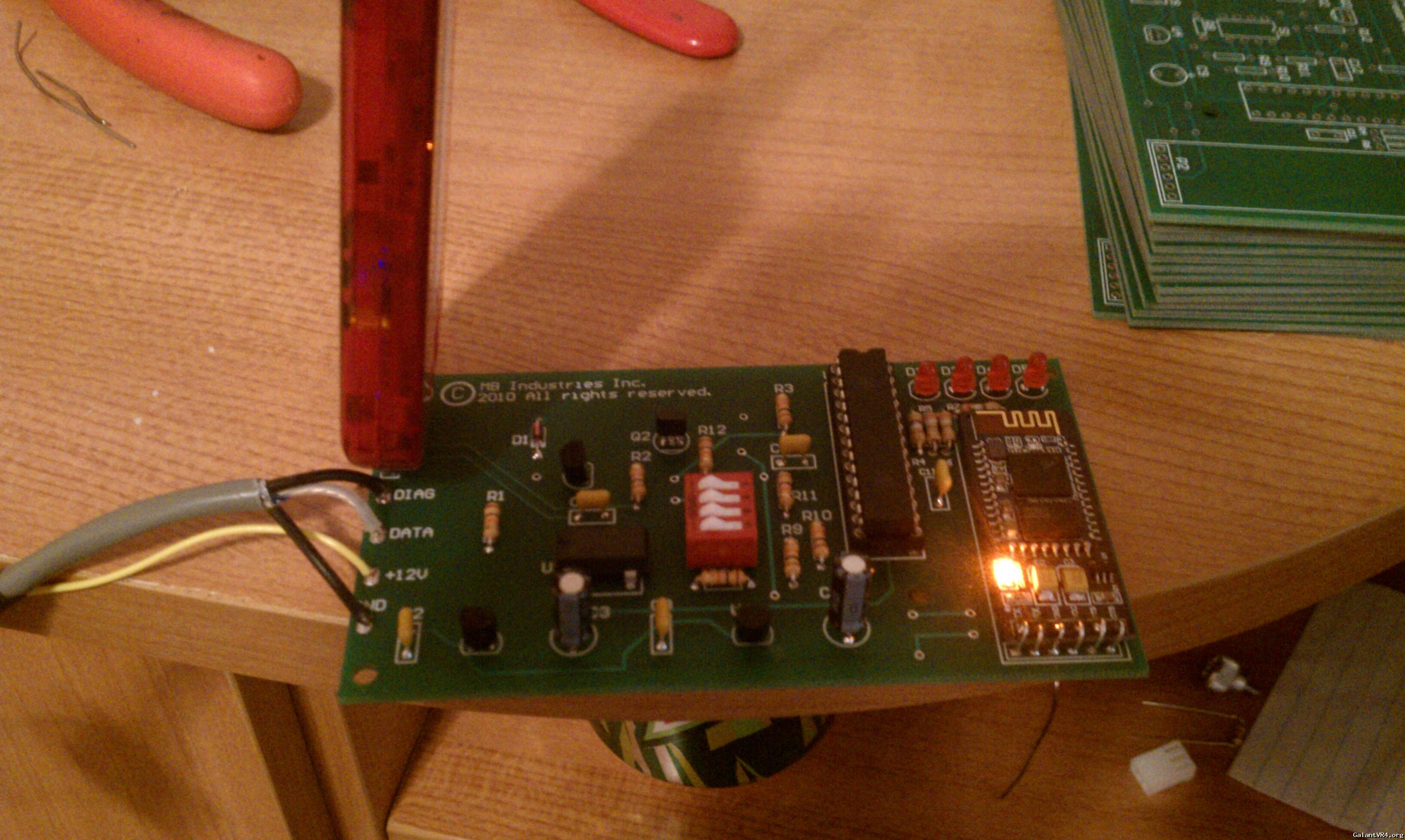

Hardware is finally ready! It'll be a few weeks before a few parts come from overseas but it shouldn't be long!
Final price will be $125 shipped, it came in higher than we wanted (two of us working on this project),
many hours have went into this, built here by us, but you won't be disappointed!
Adapter will come with connecting wires and female spade connectors attached, three go to the standard OBD1
pins, the other to a 12V source.
I will also be providing a test program and source for a .NET application. It's very simple and allows you to check out how it all
works, if you get ambitious make your own PC logger. The application is not polished and should be considered a simple
testing program as it sits. The adapter can be used with any application on the PC side that connects at 9600 baud, car side
can be configured for multiple rates (including OC'd ECU's).
Once everything arrives I will begin building the remaining 14 boards I have. You are # on the pre-order list, and I will
contact the first 14 on the list accordingly, and work my way down if people back out etc..
Attached is a picture of the board for those that have not been following the progress closely!
Thanks for your interest!
Nick
