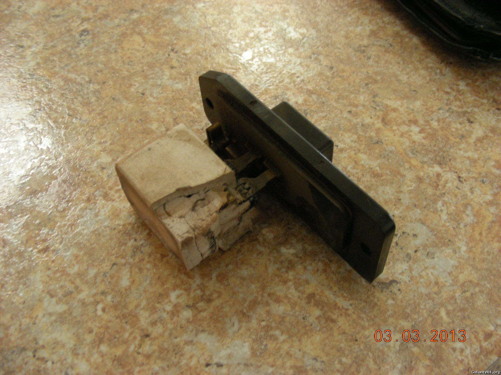

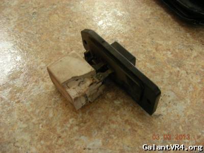

Here's the highly likely culprit on mine ( no low speed and high current draw ):
Here is the thread that shows blower resistor location: click
Heading out now to find a replacement, will report back shortly.

Got a new unit at Vatozone, $25. Woulda been at least $10 at UPI between the part and entrance fee, no brainer once I found the new one.
Cleaned out a limbs worth of leaves from the squirrel cage. Installed the resistor unit and tested, all speed present and accounted for.
Everything reinstalled, tested in the driveway and on a 10 mile jaunt. Previous high load/RPM drop is now gone.
