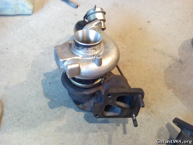

That's an Evo4-9 twin reverse scroll turbo. The engines in the Evo4-9 sit 180deg to the engines in our GVR-4s. What you can do however is use that exhaust manifold and fit an Evo X turbo, then the intake and exhaust are now on the correct sides.
An Evo1-3 16G turbo and manifold will bolt on in place of the 14B.

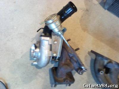

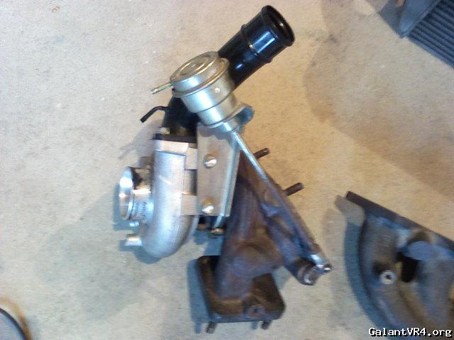

whoops I think I perhaps recalled the details just a little incorrectly, but anyway the Evo X TD06SL2-20G is the correct orientation as shown here (mounted to an Evo1-3 4G63 engine)
but it appears the flange is not quite the same as per the Evo4-9 flange, so a custom manifold will need to be made or the correct flange adapted to an existing manifold.

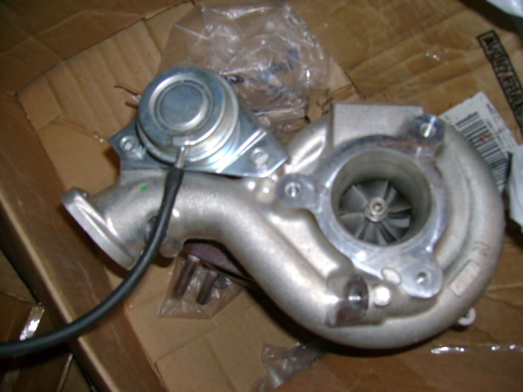

Nice manifold, but that isn't the Evo X turbo. The Evo X turbo is a i393.photobucket.com/albums/pp20/Fitzpadj/DSC00946.jpg[/img] . That turbo in the picture is a TD06SL2-20G.
This is an E10 turbo.
So far it looks like the the EvoX turbo is pretty sweet, twin-scroll means fast spool, more low end torque, but the expensive part is the manifold. I suppose if you have the fab skills or know someone who does then you're set. I think when the time comes rather than the FP manifold and the E316G I will try to make this happen. But that is quite a ways down the road.

It will work...... Paul and I have been talking forever about this project long before he picked up his second car. Seems like the physical dims are the same, angle of flange offset to one side etc so our plan has been to just get a sch40 header and cut off the head flange and weld on a 4G63 flange and be done. At first the headers were big money but slowly the price has been dropping. No reason to spend 20 to 30 an elbow and all the fab time to build one when a cheaper one can be bought and just adapted to a 4G63 with a simple flat flange or with one of the cast ams units.
