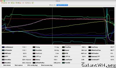

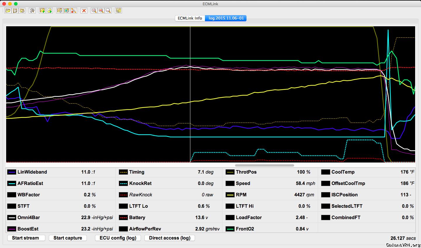

I've noticed in my last pull that as my RPM's go up, my battery voltage goes down. Not a ton, mind you, but it is at 13.9v as I'm putting my foot down, and it slowly works its way down to 13.5v by the time I take my foot off the gas. During this time, I also see the FrontO2 voltage drop at about the same rate (relative). The O2 voltage starts at 0.88v, and by the end of the pull, it's at 0.80v. During this time, i don't see major fluctuations in the AFR's, although a few bounces between 11:1 and 11.3:1 could cause lean knock I suppose... In anycase, seeing this drop doesn't surprise me given what the car is doing, but I am curious how one compensates for it. I'm also curious if this could be the cause of the few counts of knock I'm seeing.
here's a still, link to the log file after the photo. Thanks in advance to anyone that takes a peak. If I end up with less boost, I don't really mind, but if I can leave it alone, well of course that's better.
FrontO2 is the thick, green line, 12v is the thick dotted red line just underneath...

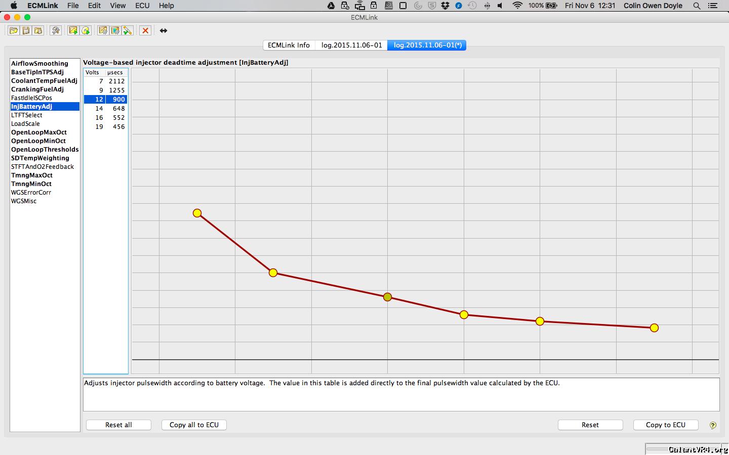

You adjust the battery fuel adjust in the DA table. Can't think of name right off hand, but basically you adjust the deadtime per said voltage to tweak the injectors to deliver a bit more fuel as voltage drops. As battery voltage drops, voltage drops at the injectors and the fuel is no longer being delivered the same. So a deadtime adjust gives the injector more pulse as voltage drops which keeps the air fuel ratio the same.
This is what the Easy tune box works around. It supplies a constant 14v to the injectors no matter the load or rpm or charging system activity.

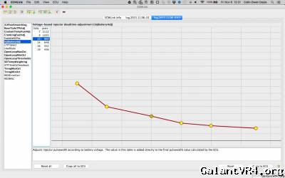

Yup, I know it well. Saved me from an idle-drop issue I was having on a combination of cold/stopping/fans-on/headlights-on/other-stuff. The InjBatteryAdj isn't granular (and you can't add additional voltage plots), though, so I didn't consider it for this issue. That being said, i suppose I could increase the 12v value and leave the 14v value along to see if that got me anywhere...
i'll give it a shot and see what it gets me. thanks!
