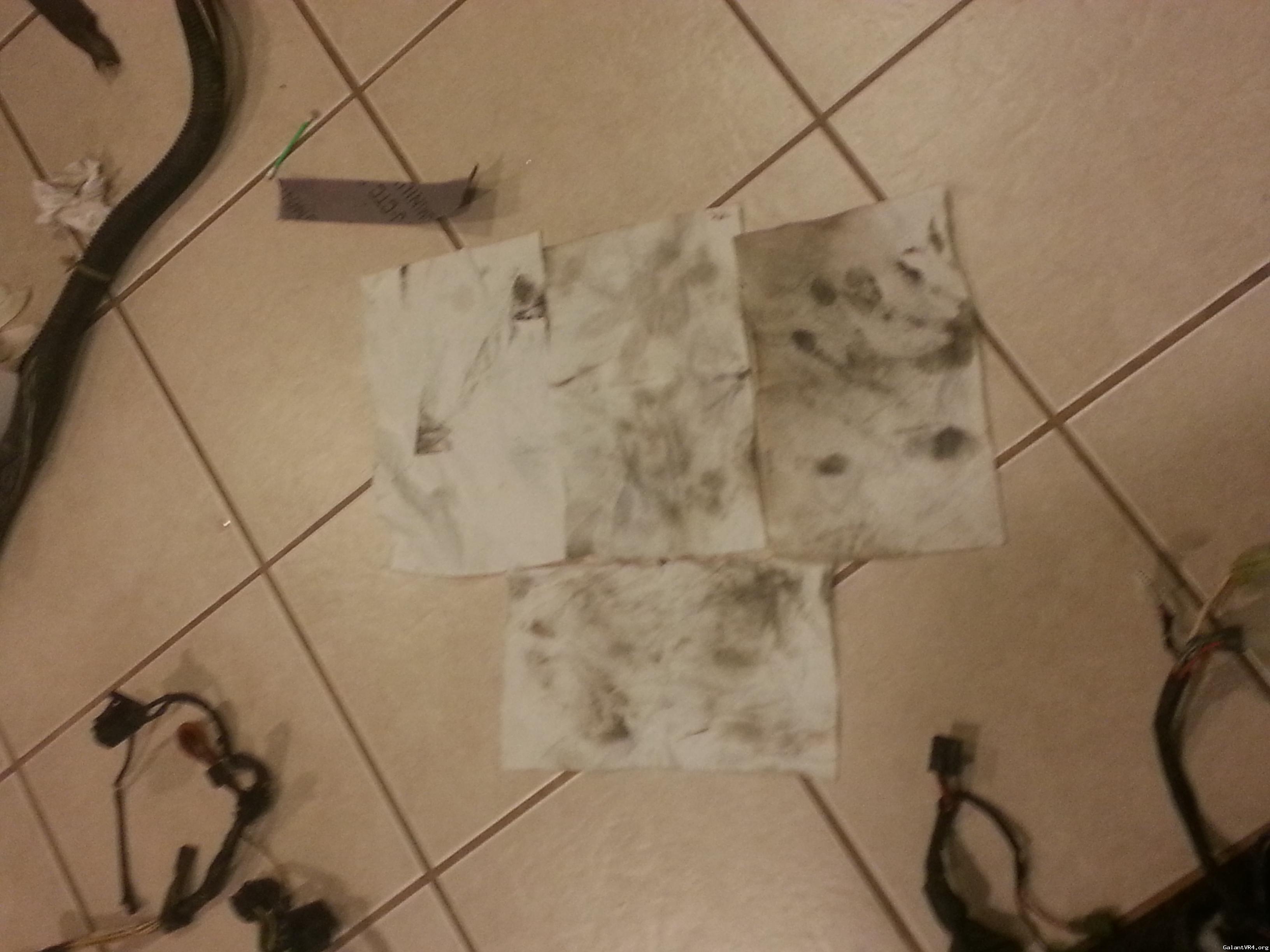

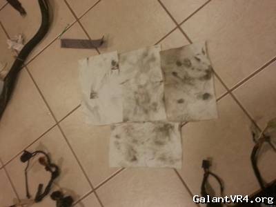

Dash done. Now I need to remove the blower motor, one more bolt then disconnect the ecu. Then its snakin everything back in. Ill be using high temp tape and conductor grease at every connection. To give you an idea of how dirty the connectors are heres a pic. Every connector for the chasis harness was scrubbed with a tooth brush and fined cleaned only at the connectors: this is the replacement one. Sprayed electrical cleaner. Nasty.
