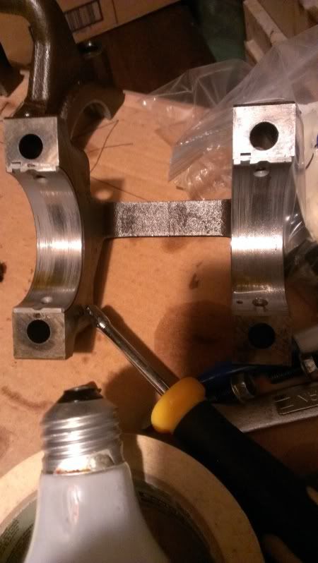

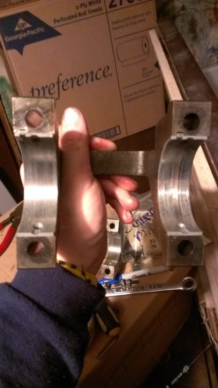

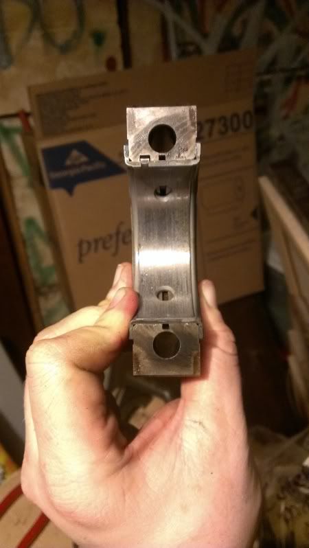

Im going to be replacing my bearings in my GVR4. I took off the Mains and they seem to look ok except for the rear which i noticed some copper starting to show, Front and Center seem ok. no copper showing. Im pretty un-expierenced when coming to stuff like this. Im not sure what to look for as of bearing wear and proper replacement and specs.

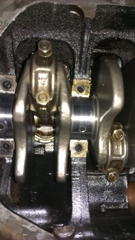

I got a few pics from my phone, i also grabbed some of the crankshaft to maybe someone on here can tell me if it looks to be in good shape.
Front Main
Center Main.
Rear Main

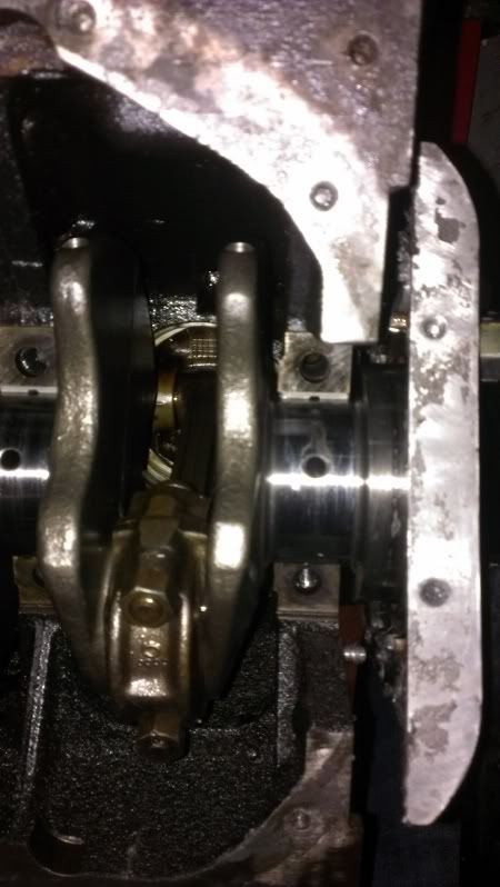

I noticed this little marking on the crank at the rear also right above the oil gally not sure if this is normal or not.
And the rest of the crankshaft look like this.
I plan to do some research on the size of the Crank to make sure it hasnt been cut so i know to get the proper size bearings, I think im going to repolish the crank if it needs it but other than that i just want to put some matching bearings in and go.

What is the background on the engine? No failure, just rebuild time? From what I can tell, everything looks fairly normal. You should mic the crank as you said.
If you are referring to the groove on the rear main, that gets caused by the seal. Sometimes on a rebuild I try to get the seal in a slightly different place to make sure it does not ride in the same spot.

To test for cracks, most shops will magnaflux. I will say it is pretty rare (at least imo) to get cracks in a cast iron block. Also your crank/caps looks fine.

I like to run the ACL race series bearings with the ".001 extra oil clearance and rotella 15w-40 oil. Works great! I'd say measure the crank, I'm sure it's good though. Be sure to check for out of round and taper, don't just measure one spot on each journal and call it good. It looks like you can get the crank polished and throw some bearings in it and your good. Getting the crank balanced won't hurt either, but it's not necessary.
