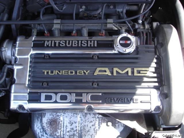

Engine:
Stock 170hp engine
Standard AMG Galant Engine
Polished Rocker Cover
Drivetrain:
Standard
Intake:
K&N Filter
Cold Air Intake

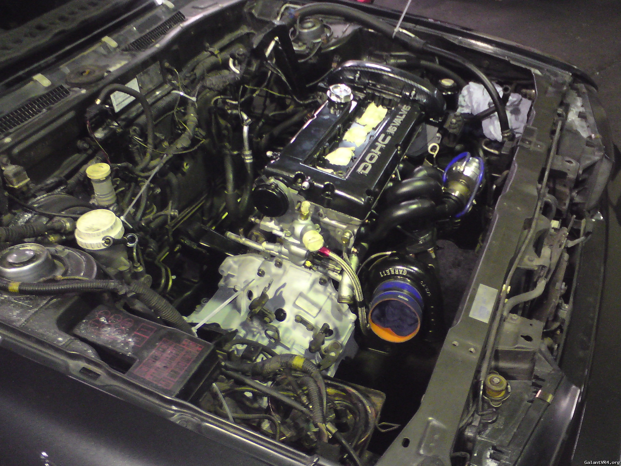

Guys,
My brother now owns this car. We have decided to build the car while keeping it completely reversable.
The new specs are:
Owner: P.Eng
Location: Melbourne, Australia
Message Board Name: n/a
Year: 1989
Number:
Best 1/4 mile time: n/a
Comment: build in progress
Engine:
VR4 2.3L stroker
Wiseco / Eagle combo
OEM crank - grubbed screwed, balanced and crack tested
Comp 100-101 camshafts
Crower valve springs
Crower titanium retainers

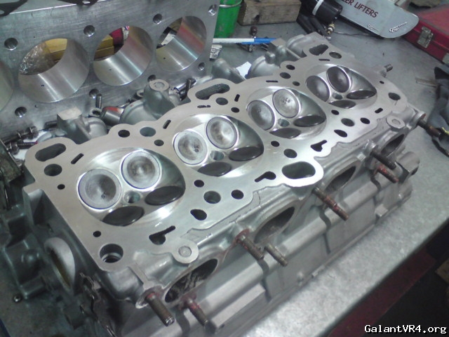

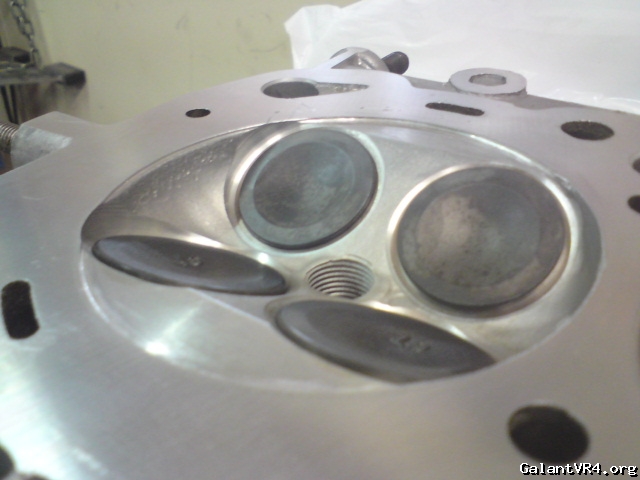

CNC'd combustion chamber in the head (previously had some damage in the chambers, about 2cc extra)
GT3082 (My old turbo) + Stainless steel exhaust manifold + Tial V40 gate
Tomei MLS headgasket

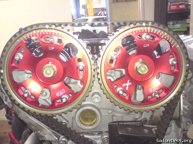

X cam sprockets from an Evo8
Hyundai rocker cover
1/2 Grout filled block
Single runner intake manifold (extrude honed + ceramic coated)
Drivetrain:
VR4 RS rebuilt box. 3.909 ratio
Kaaz 1.5way front LSD
CVAP Viscous Locker
Intake:
4" Stainless steel intake
HKS Pod Filter
Fuel:
Walbro 255 HP pump (rewired)
1000cc Power Enterprise Injectors
Aeromotive FPR
-8 line from filter to rail
-6 line from rail to fpr
Exhaust:
Custom 3" Stainless steel exhaust
Varex Muffler
Ignition:
Coil on plug ignition coils + Stock waste spark ignitor
Brakes:
Standard with DBA slotted / drilled rotors + EBC Green Pads
Braided goodridge lines
Suspension:
Hotbits DT1 coilovers
Ultraracing Front and Rear strut brace
Engine Manangement:
Motec M400 with Plugin loom made by Springy Motors
Appearance:
Show - 19" Dolce wheels (black / polished lip)
Drag - 15" Enkei RPO1 (gold / polished lip)
Track - 17" Volk CT-Pro (grey / polished lip)

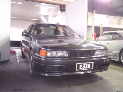

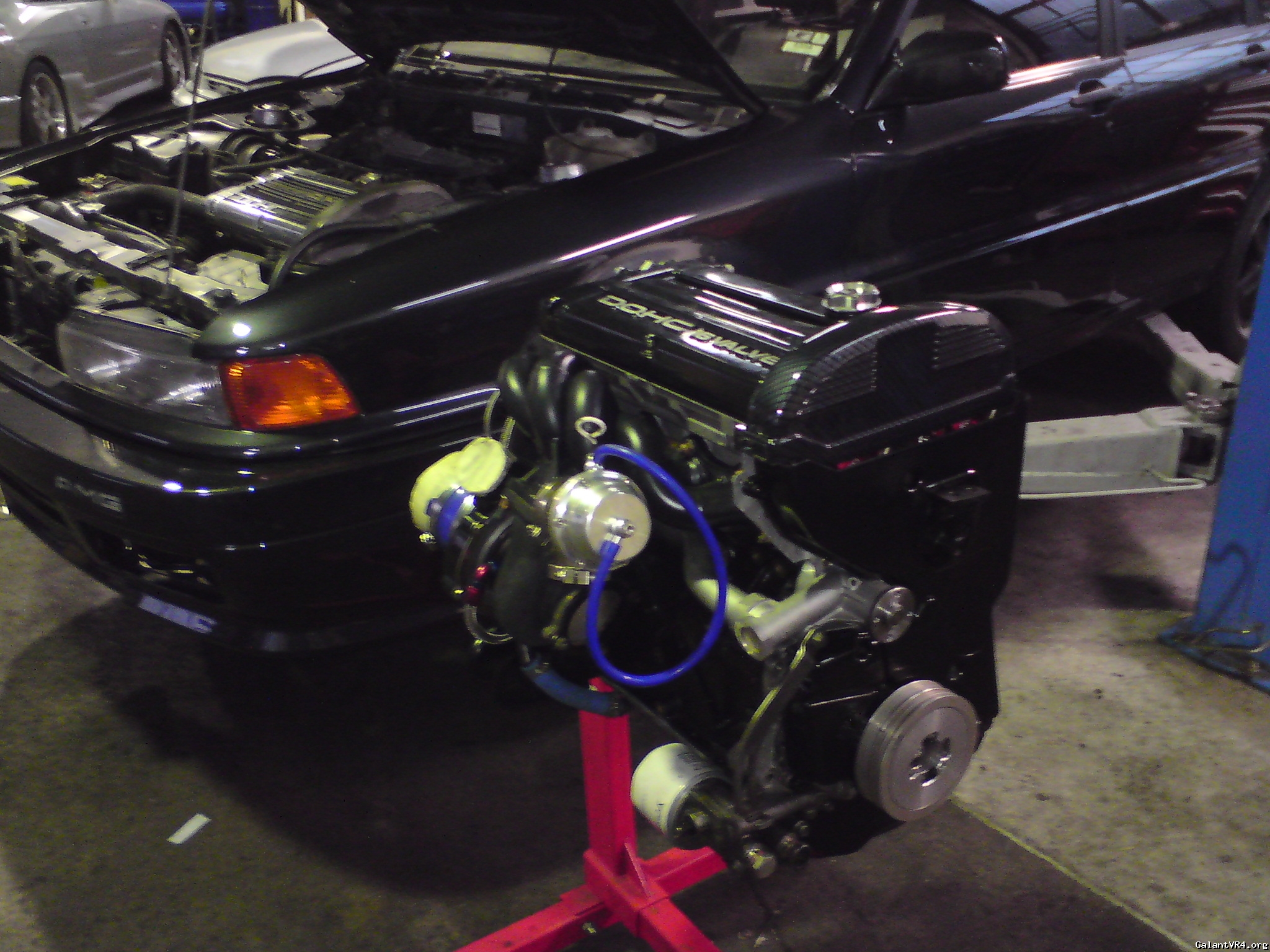

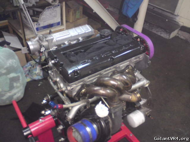

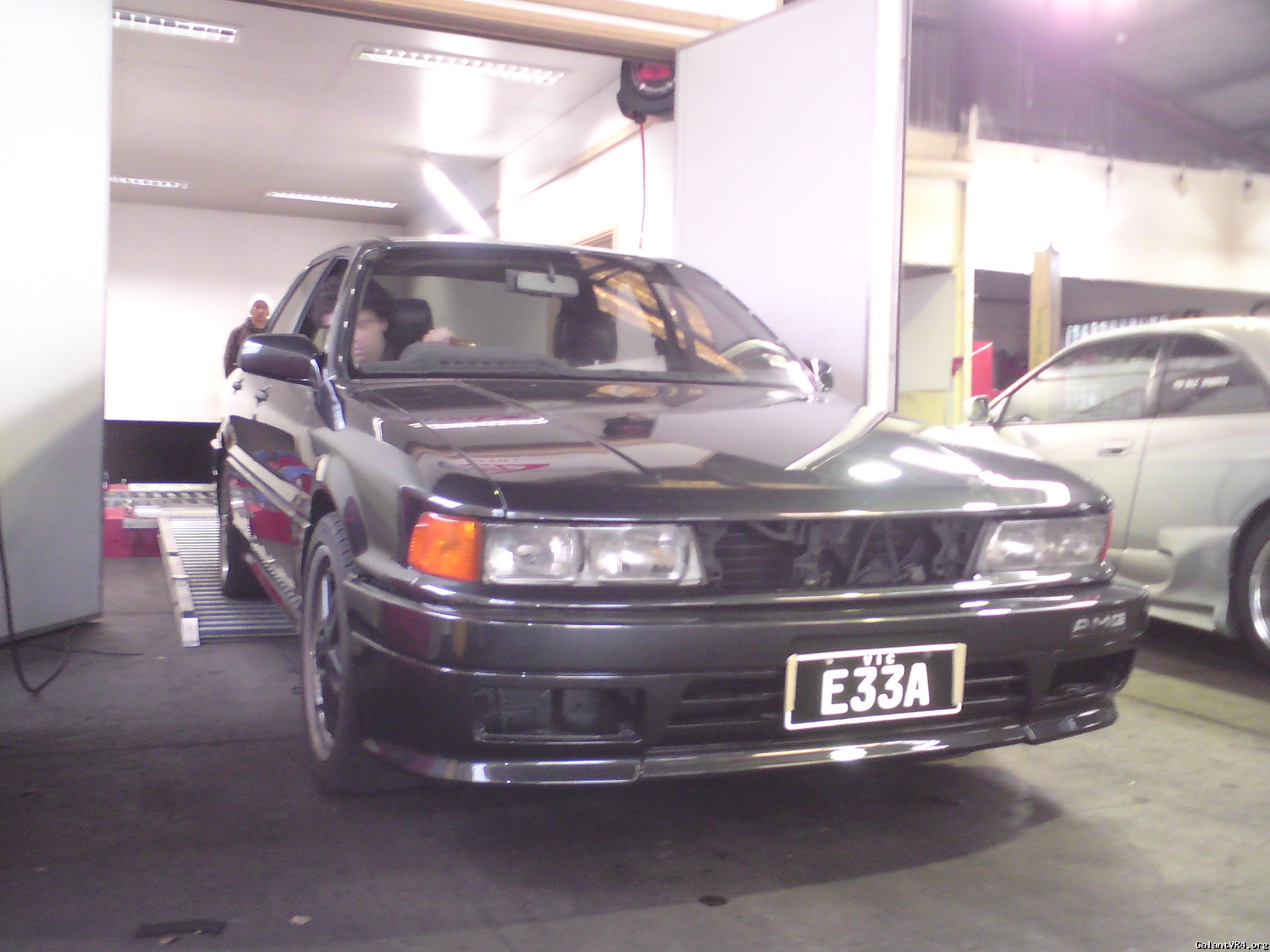

Prior to the ENGINE swap - we ran it on the DYNO.
It made 86kw's at the front wheels in 4th gear while speedcutting at 180kph.

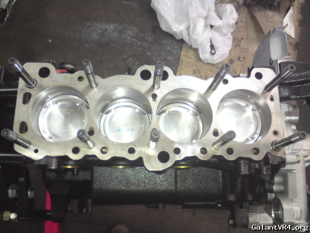

The new engine next to the old

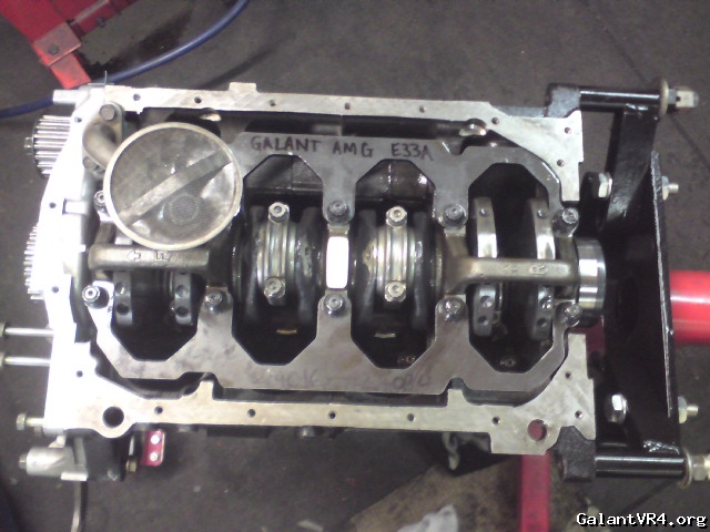

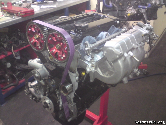

Updated specs:
SPECIFICATIONS
ENGINE
2.3L 4g63
Custom wiseco forged pistons
Eagle forged rods
ARP head bolts
ARP main studs
Kiggle mains girdle
Springy Motors oil pickup
Evo8 squirters and valves
Hyundai G4CS crank - race prepped by Springy Motors
Tomei MLS head gasket
Stock VR4 head
Crower Ti retainers
HKS 272/272 cams
3Xe cam gears
AMG intake manifold
AMG stock tb with FIAV blocked off
VR4 fuel rail with welded -6 feed
1000cc power enterprise injectors
aeromotive fpr
walbro 255 intank pump
bosch fuel filter
-6 fuel lines in engine bay
Custom gt30 power ported turbo
ceramic coated custom exhaust manifold
turbo beanie
3" dump pipe with wastegate plumback (rob evo spec)
tial v44 external gate
4" cat back custom Springy Motors exhaust
AES system
Custom intercooler piping (plazmaman / springy motors / bjp spec / x3e)
ARE front mount intercooler
HKS SSQV plumback bov
K&N air filter
BJP Custom 4" intake pipe
