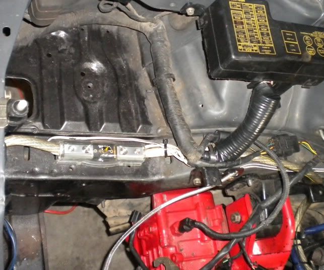

I just finished up doing this.
You can see the fuse holder, the wire that heads to the left goes straight to the alternator. The smaller wire that also comes out of that side runs to the "60A FUSE (+B)" on the fuse box, and the large wire that heads to the right goes straight to the starter. The smaller wire coming out of the right side powers the other fusible links in the fuse box. I relocated the 30A fusible link from the battery fuse box to the spot that reads (ECS) on the bigger fuse box. Does anyone see any problems with this setup?

haha it was like that when I bought the car I sourced it from. Red trans with a powdercoated blue stock intake mani with a stripped down valve cover, and blue wire looming on EVERYTHING on a red car, along with some Taz floormats. I wasn't ambitious enough to clean it off or repaint it, because I will be swapping it up later on.

As long as you routed each wire to an appropriate amp fuse everything should be fine. When I moved my battery, I grabbed a multi spade fuse holder from Advance and screwed it into the side of the battery box in the back. I had two wires running to the front then, one main 0 gauge for the starting/charging system, with the charging system branched to an inline 100 amp fuse, and another twisted 3 wire which was the original block on the terminal, just extended, from the fuse block. I ran a single 8 gauge from the battery to the fuse block.

I reused the fusible link for the 30A relocation, and on the FUSE +B location I left the 60A, because it appeared that the fuse was not in line with the other ones in that row, just parallel to them. I also used a 100A ANL fuse for the main power wire, as that was the size of the original fusable link for the alternator wire.
