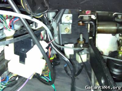

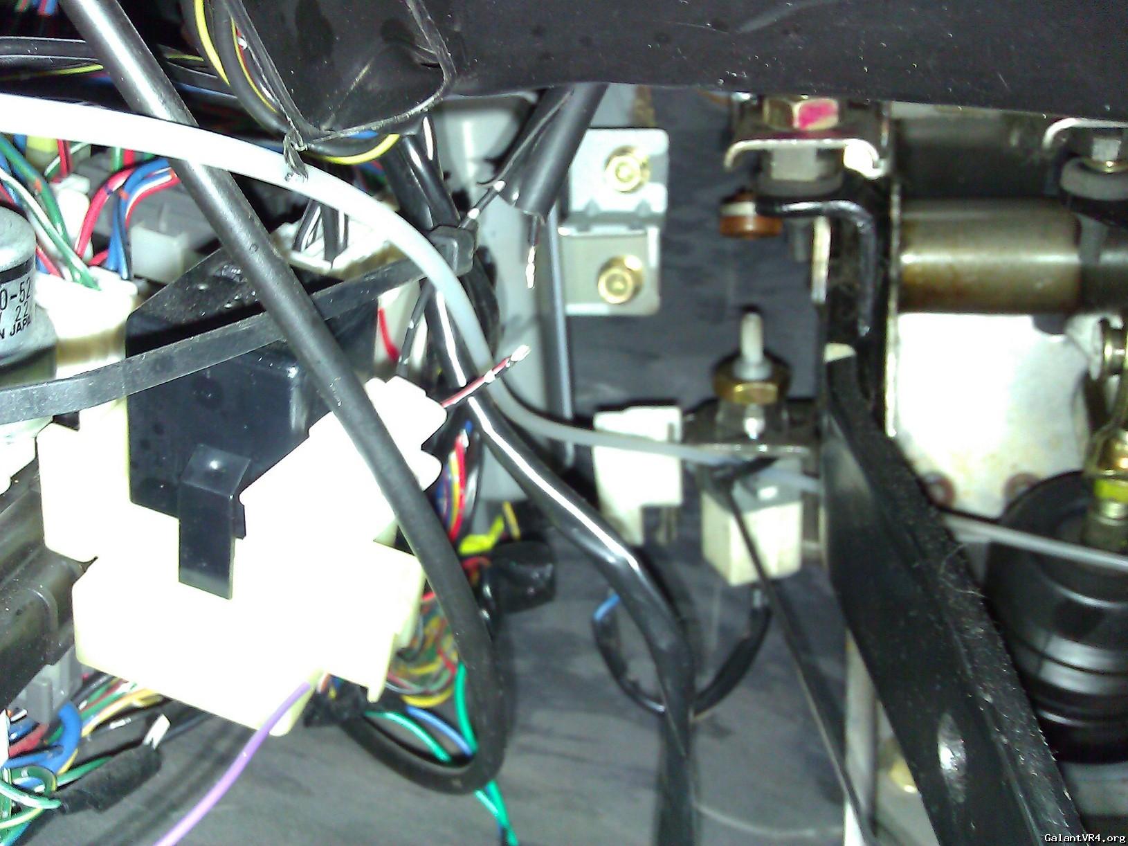

As far as this issue goes, I did confirm that a keydiver is in use. A quick look under the dash by the clutch pedal...
Maybe found the problem, eh?

it looks like that wire cut is going to the upper switch? the keydiver uses the lower switch so check that...i believe Link uses the upper switch. more knowledgeable people please correct me if i am wrong.

you can use either switch with the invert signal option, if yours was wired one way or another

I believe it's the lower switch, just looks like the upper because it's upside down and the plug is actually ziptied to a wire in the foreground (so not even close to where it actually plugs in).
