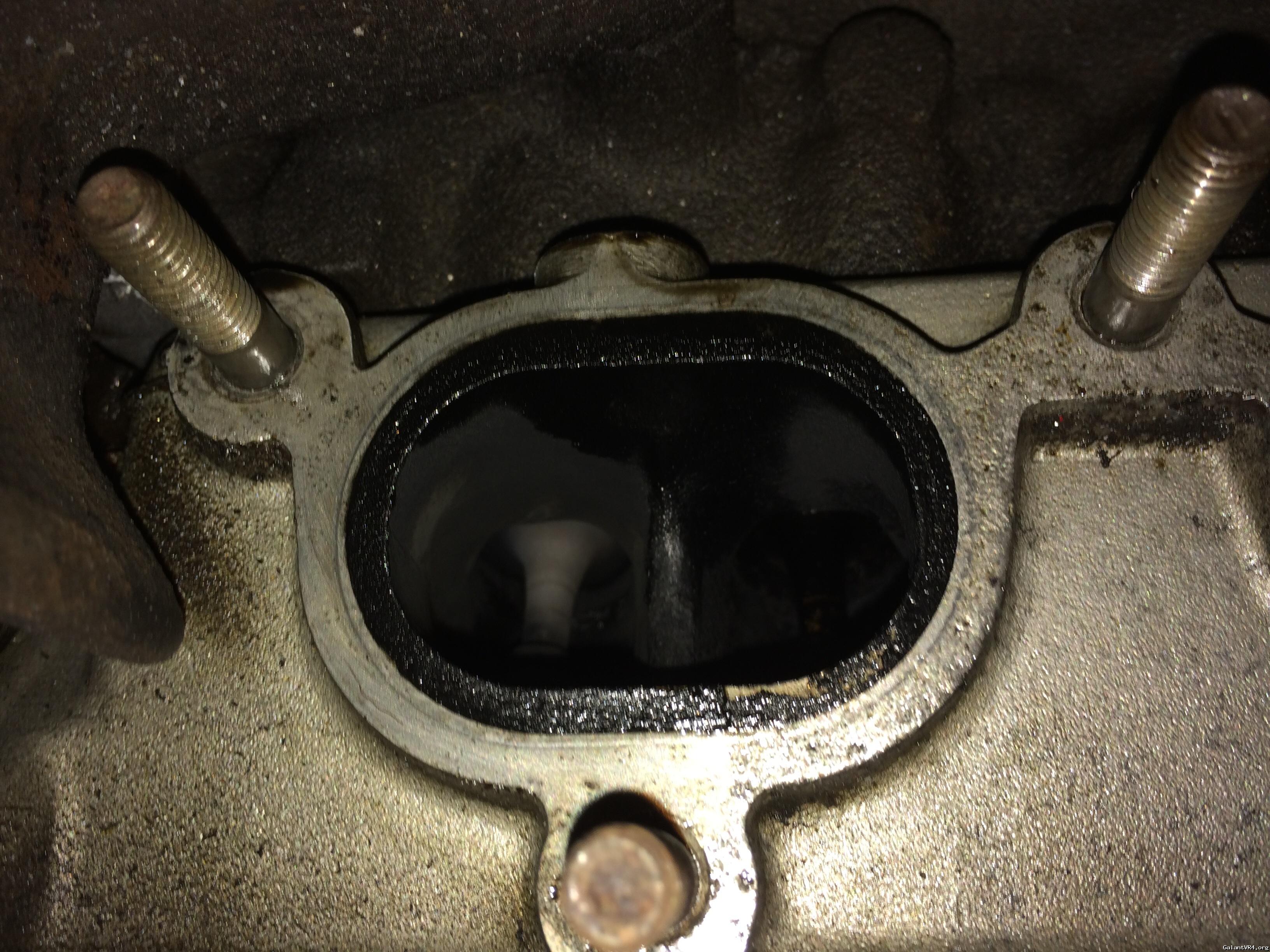

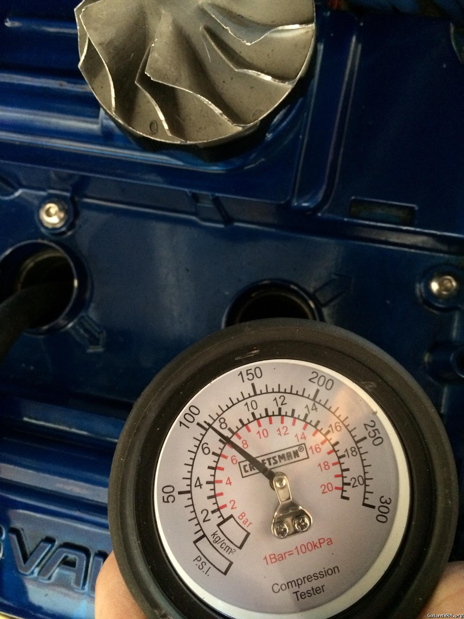

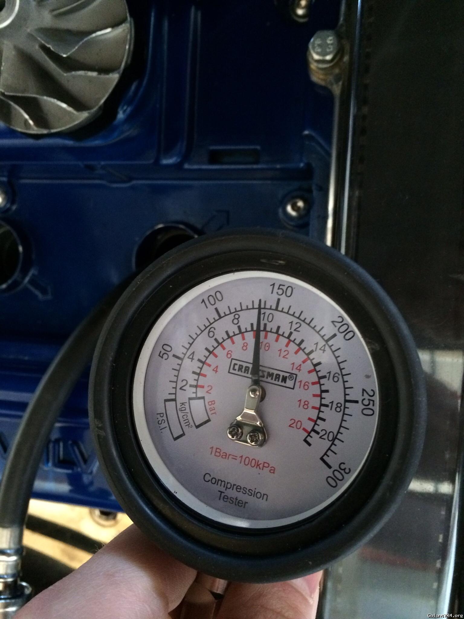

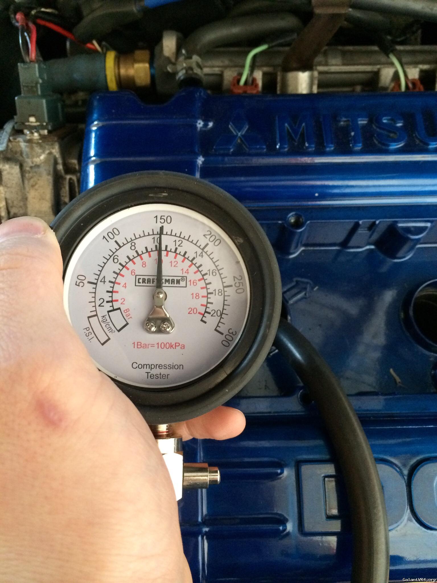

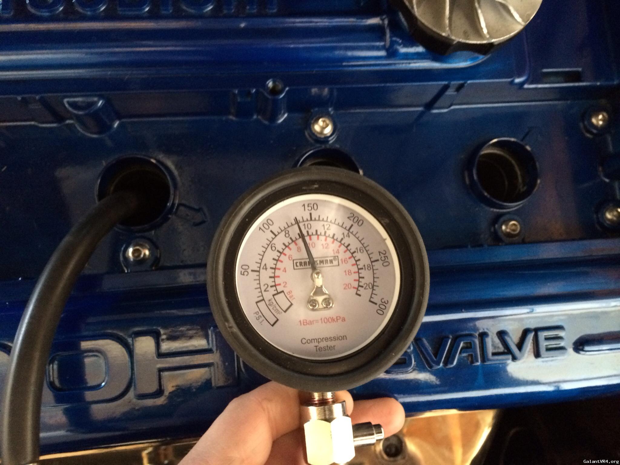

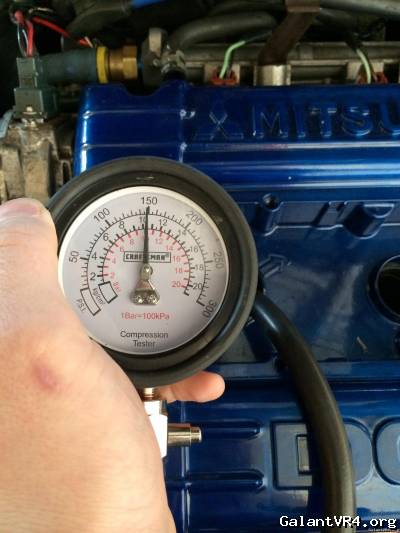

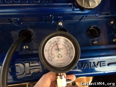

So trying to figure our exactly what's going on with my car. When I drive my car and get into boost, I let off the gas a puff of smoke comes out of the exhaust for about 2 to 5 seconds then goes away. If I drive it and don't boost it, it does not smoke at all. I did a compression test and the numbers were 150 139 105 130 so kinda all over the place.

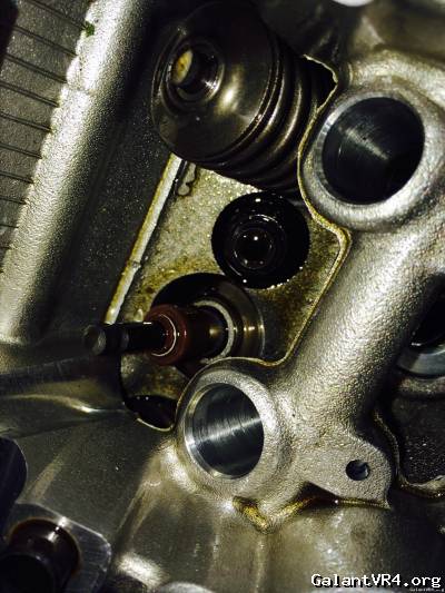

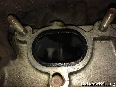

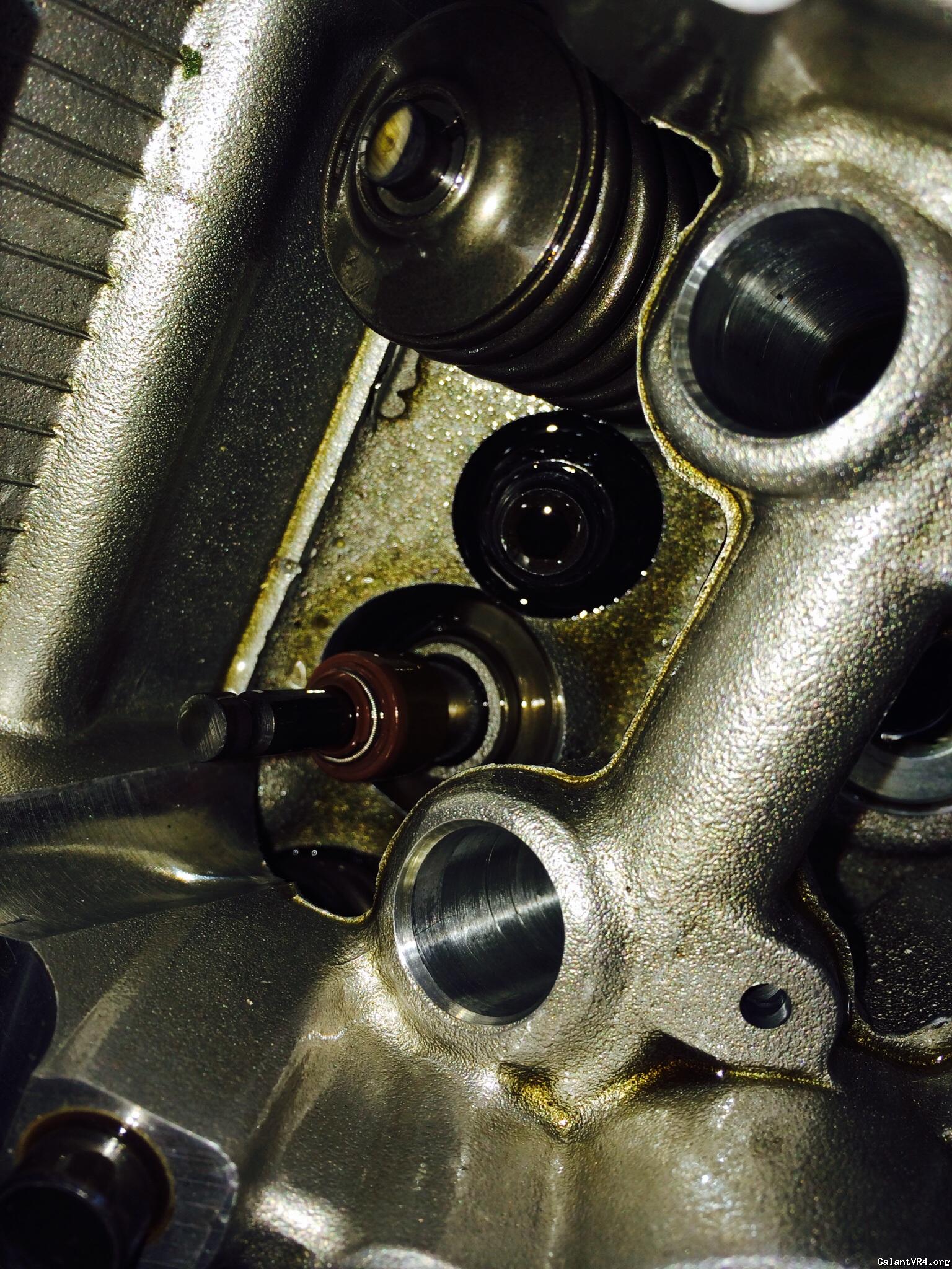

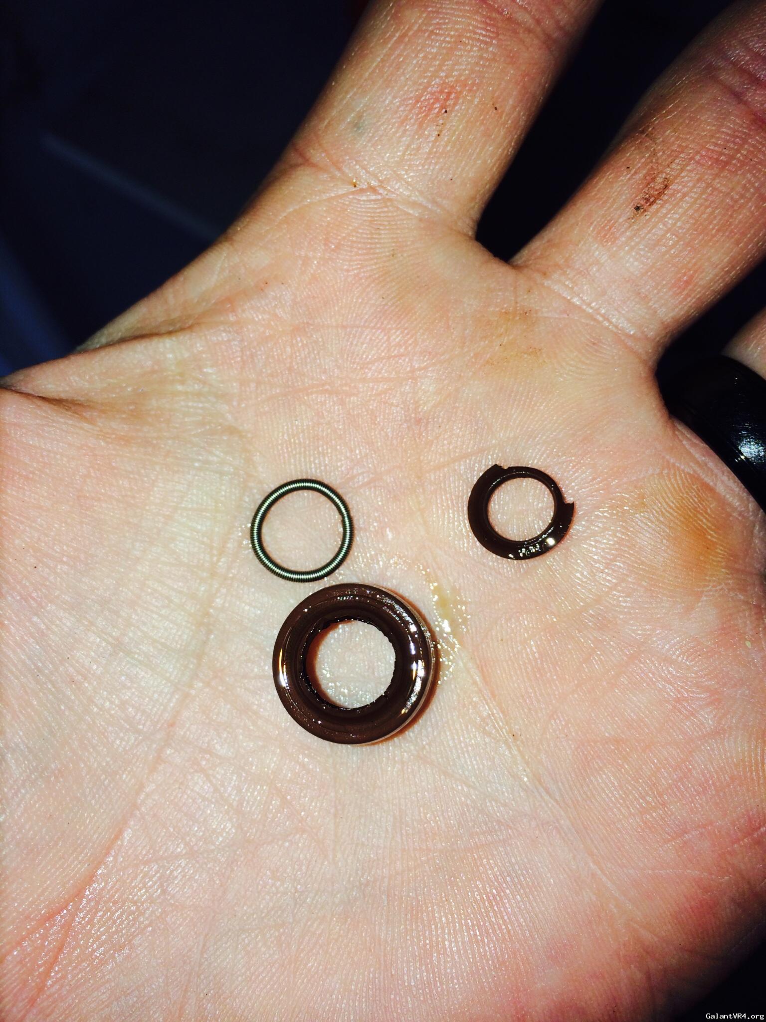

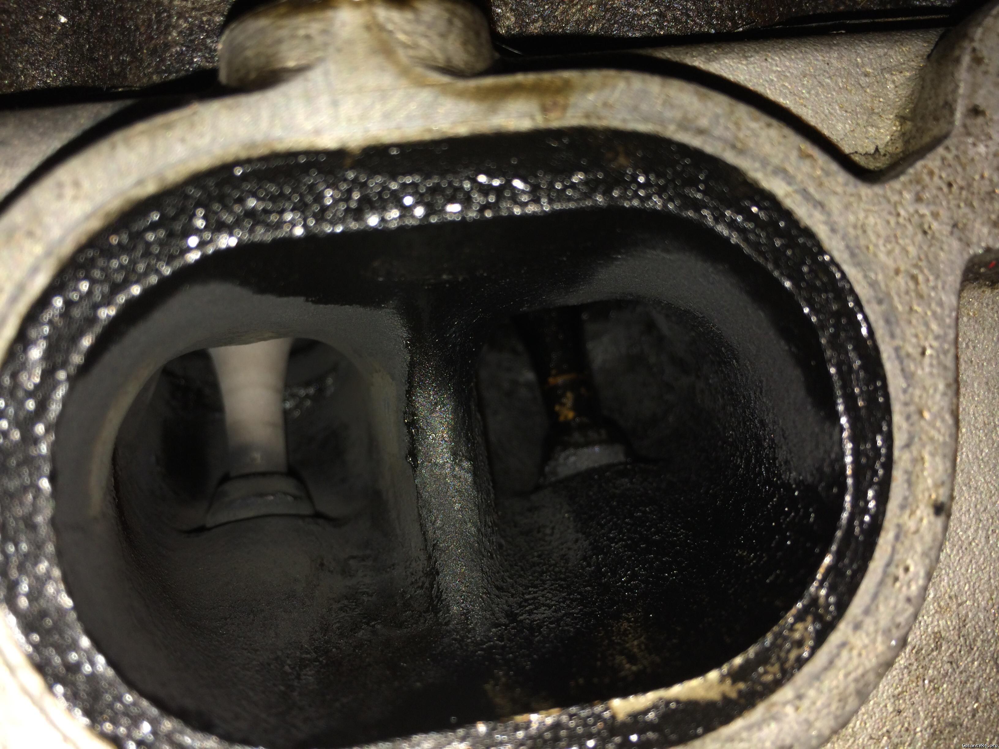

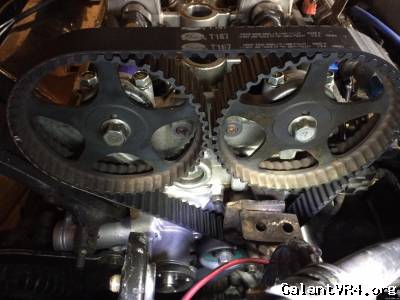

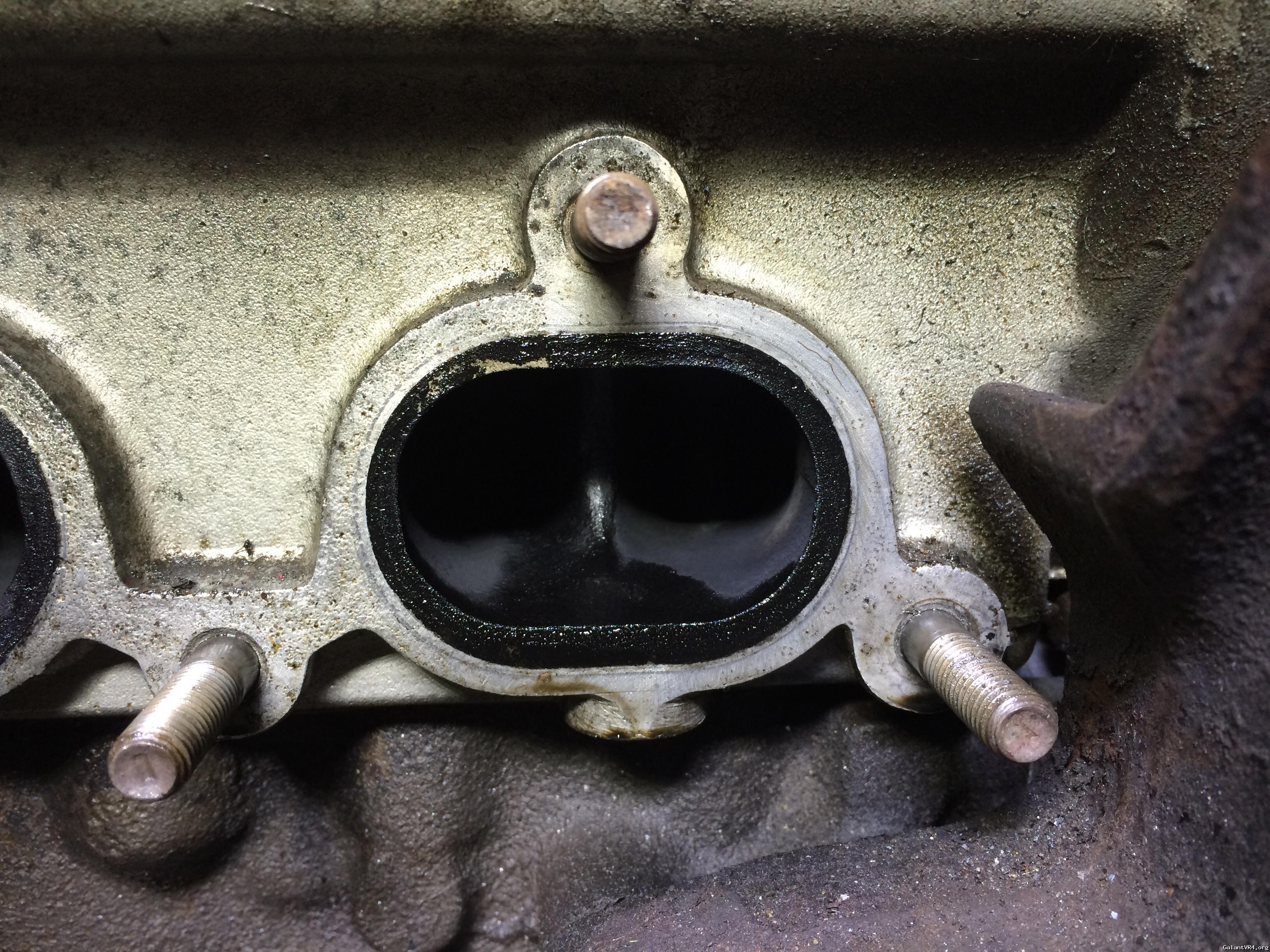

I pulled my turbo and exhaust manifold and I found oil leaking from the #1 exhaust port, it looks to me like it's coming from the valve up top. So I could be valve stem seals. However that would not make my compression numbers what they are. I also did a leak down test on cylinder 1 and air is coming out of the valve cover. I have also checked timing and it's dead on. There is zero oil in my exhaust housing as well, so I don't think the smoke is coming from that. Any other ideas on what you think it might be? I'm stumped at this point.

throw some oil into the cylinders and redo the test.
I did that and added a good amount, it didn't raise it. Then for the hell of it I put more in and it bumped it up 20 psi. Haha Ryan, I knew you were gonna say something like that! That might be my only option right now, IF it's the bottom end.

Yup...the variance alone is enough to do a minor rebuild. Depending on your power goals you could do a simple re-ring with new rings and a top gasket set or build something more serious. Be cautious. It's easy to get carried away and overbuild while spending tons of money.

i would perform a leak down test to check the valves. I would put money on the valves not sealing
