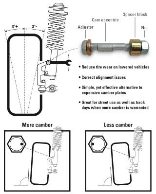

So you say the top of the tire sticks out a lot, which would indicate to me your camber is grossly positive. Is this what you mean? Usually, in the case of a car that's been lowered, negative camber usually suffers greatly, not positive. Extremely positive camber would suggest to me that something is definitely wrong with either the parts currently installed, or something else strange causing this. Pictures of whats going on here would definitely help. Aslo, do you know if there are aftermarket camber adjuster bolts installed in the front (2 eccentric bolts where the strut assembly bolts to the steering knuckle)? If so, a loose or mis-adjusted eccentric camber bolt could possibly cause this.

There are no eccentric bolts that were or are installed. The holes in the knuckle have a 12mm diameter and the holes in the struts have a 14mm diameter. So I put the bolts in and pushed on the top of the rotor to get it the camber as far negative as possible and tightened the bolts. Still positive. These have stock MR springs as well.
