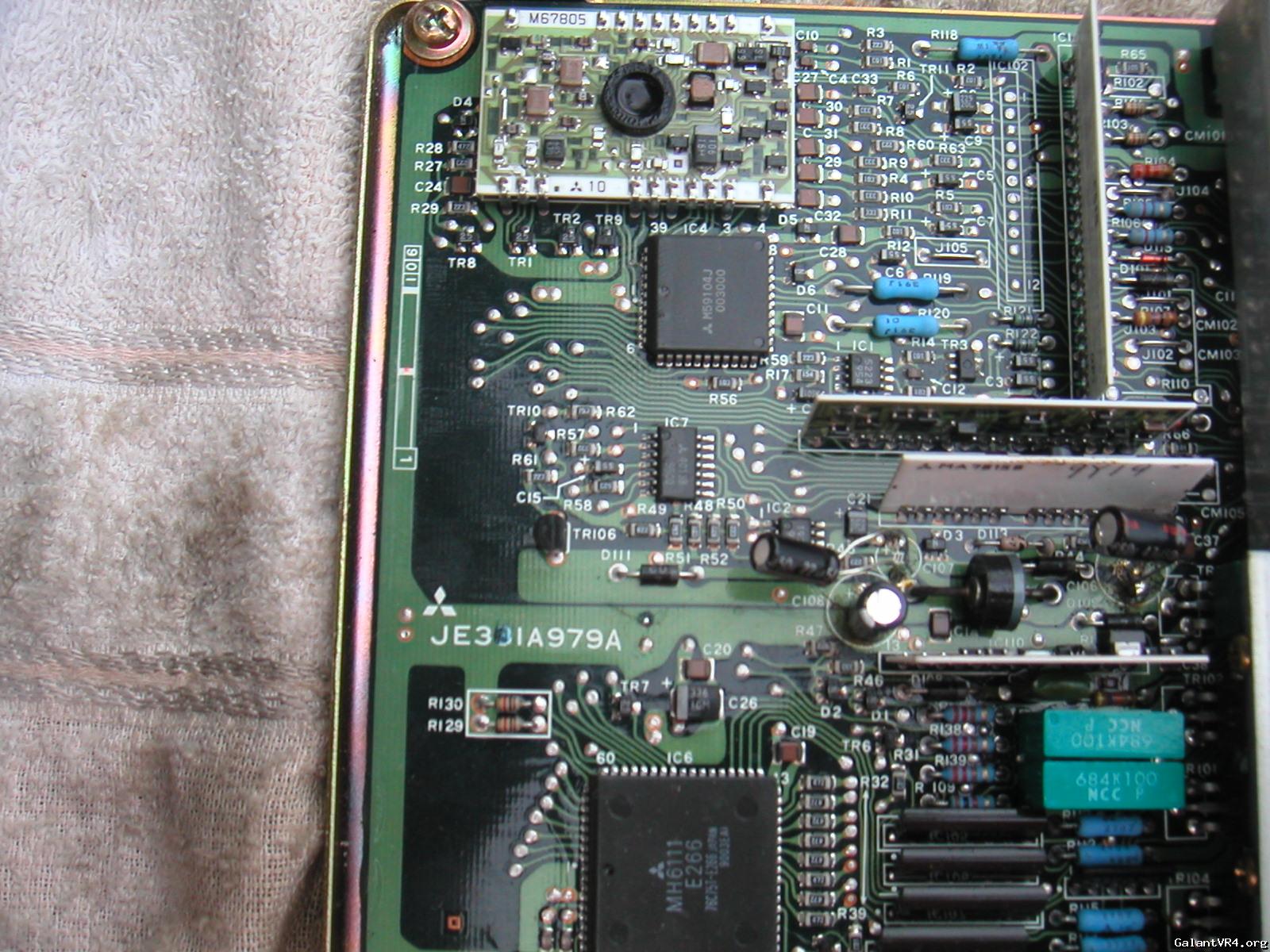

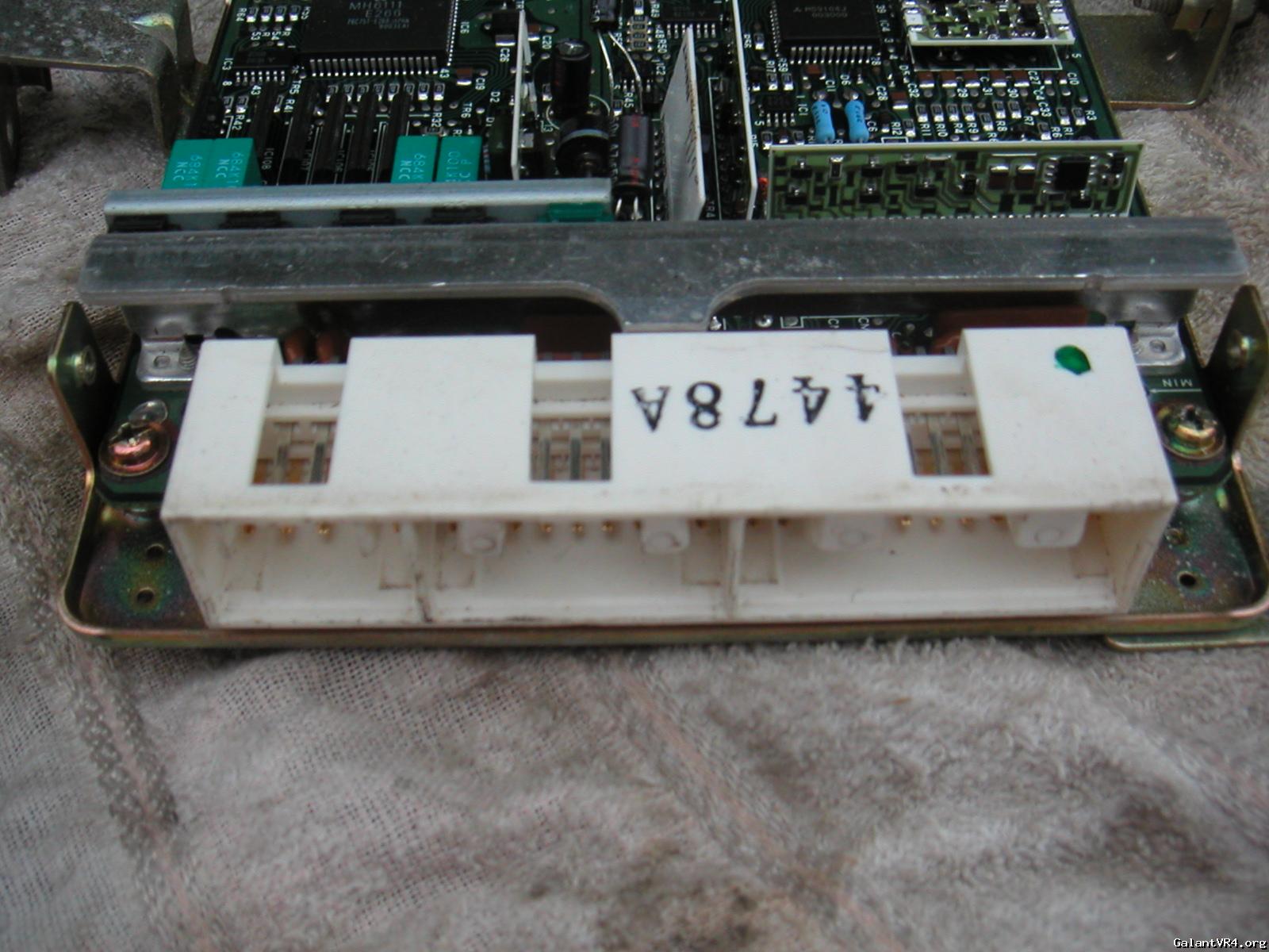

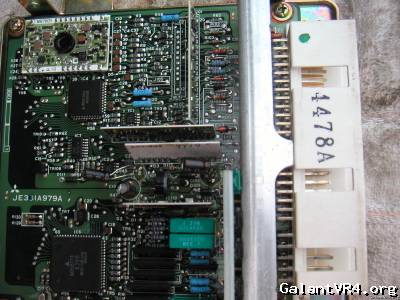

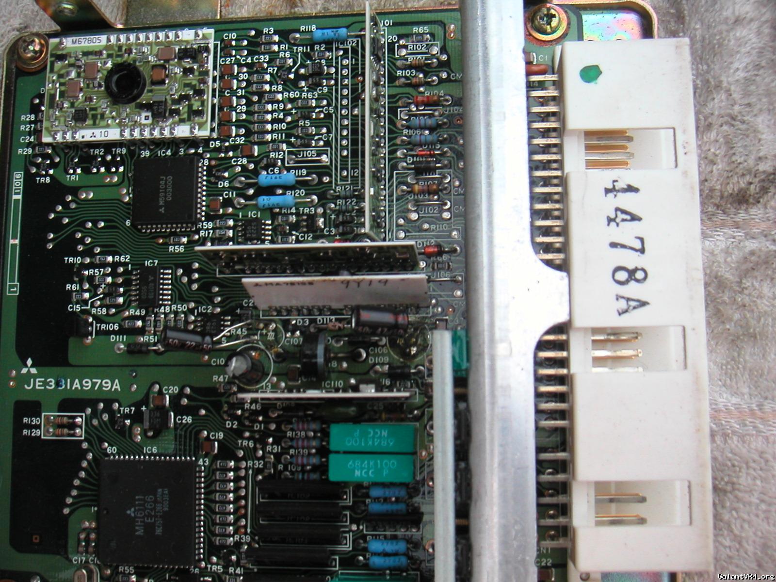

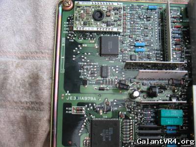

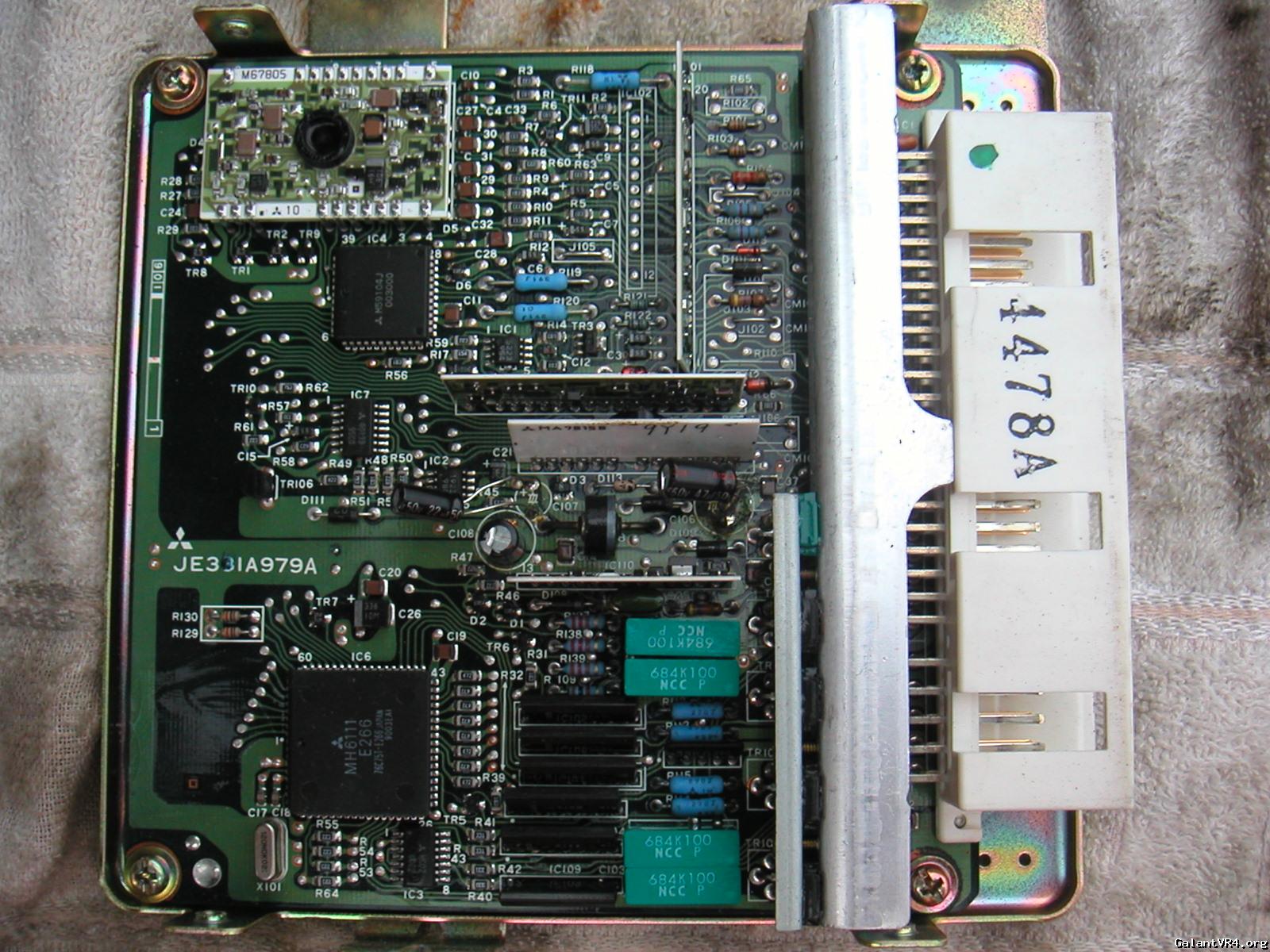

-Monday I ran codes, and one of the two codes was 44 and thought it was odd because i thought my ignition system was operating ok. Opened her up and snapped some pics for you geniuses in hopes someone can shed some advice or observations as it looks ok to me:

Looks like one or more capacitors has been leaking, and thatll do it.
When ECUs go bad in these cars it smells like burnt rotten fish, its nasty.

^^^ those are replacement caps.
It is of paramount importance that the board is thoroughly cleaned to remove all traces of electrolyte before new caps are installed.
... otherwise the residual boric acid and ammonia salts will continue to eat the traces, causing troubles years down the road.
