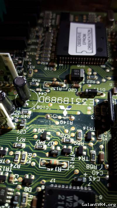

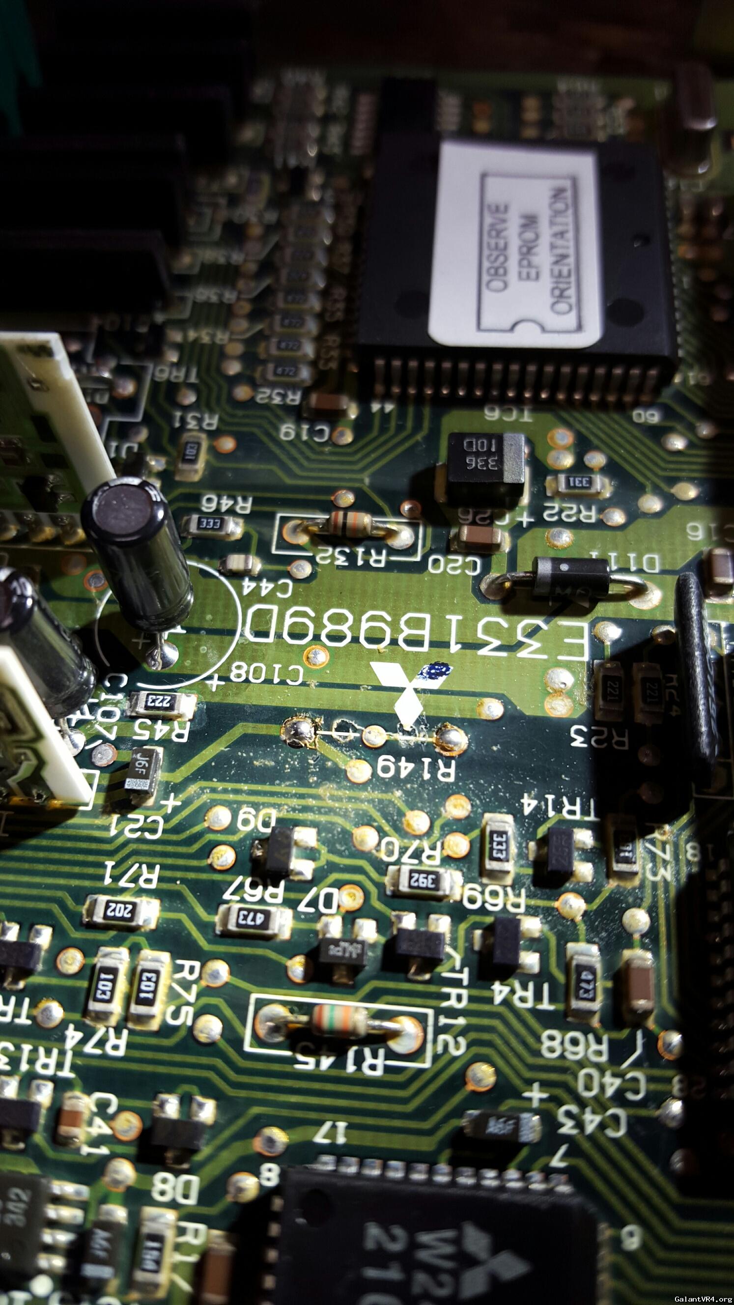

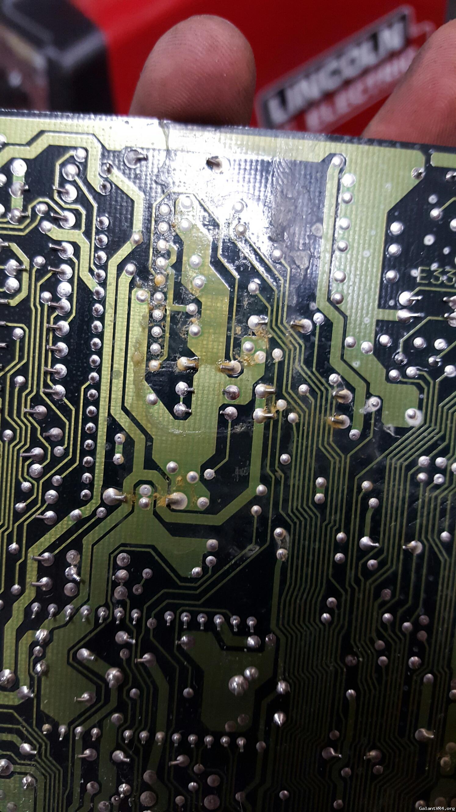

been having some issues with the galant recently, started off running rough. few days later I can crank and crank and the engine won't even fire. I'm getting air, fuel and spark, and compression is good. pulled the computer out and found this, thoughts?

Caps have been replaced already by the looks of things. I would find another ECU to swap in to eliminate the possibility anyway.

swapped the temp sensor with a known working one and nothing changed. I think I'm going to try to send the ECU to ecmlink and see if everything is working. Thanks for your input guys, and if you have any other idea's let me know.
