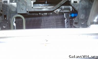

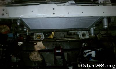

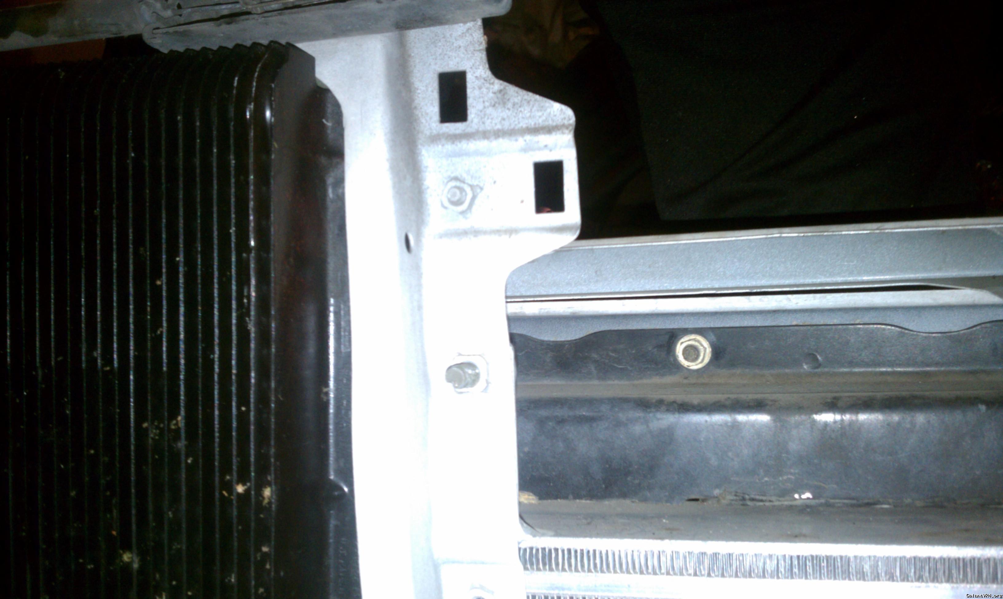

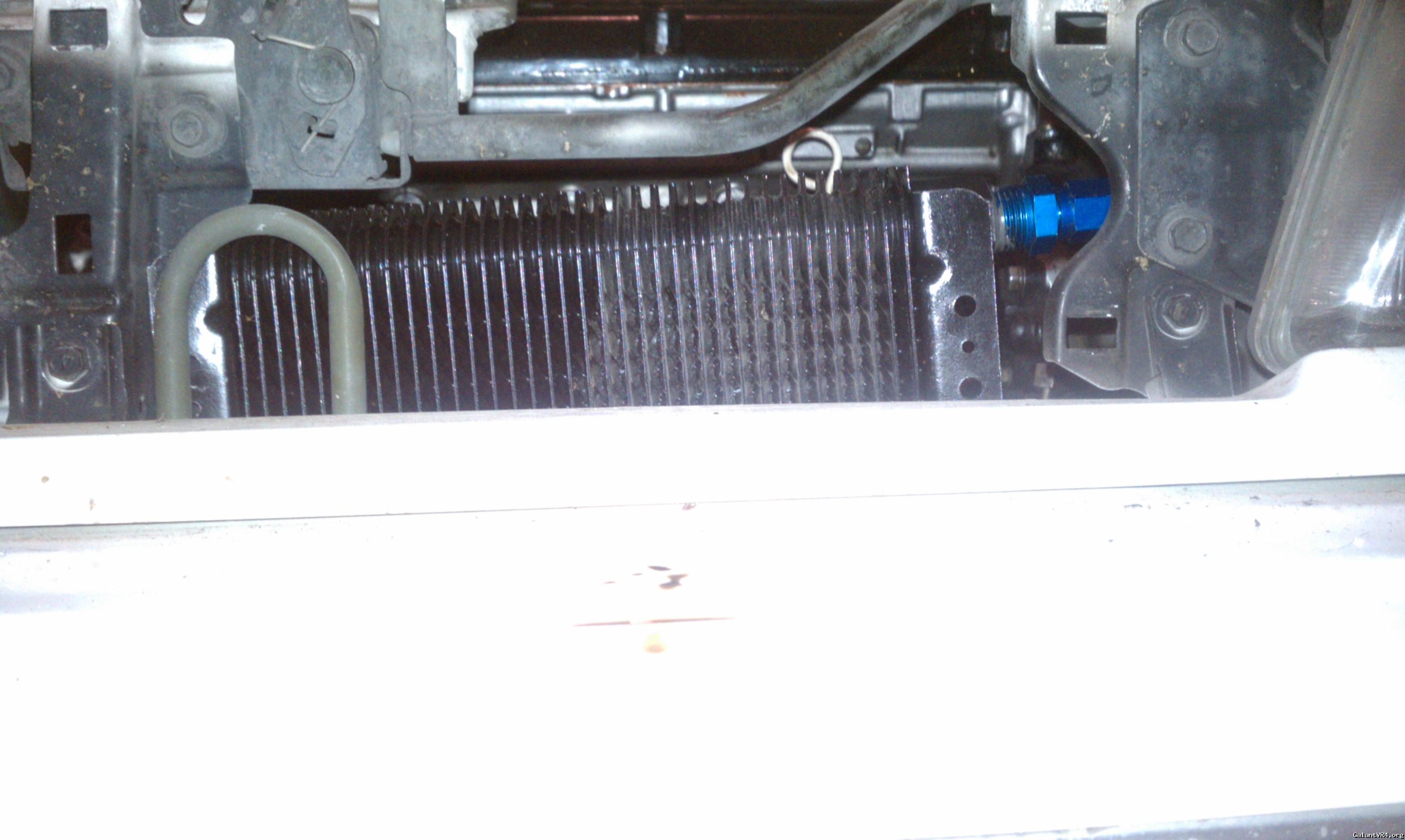

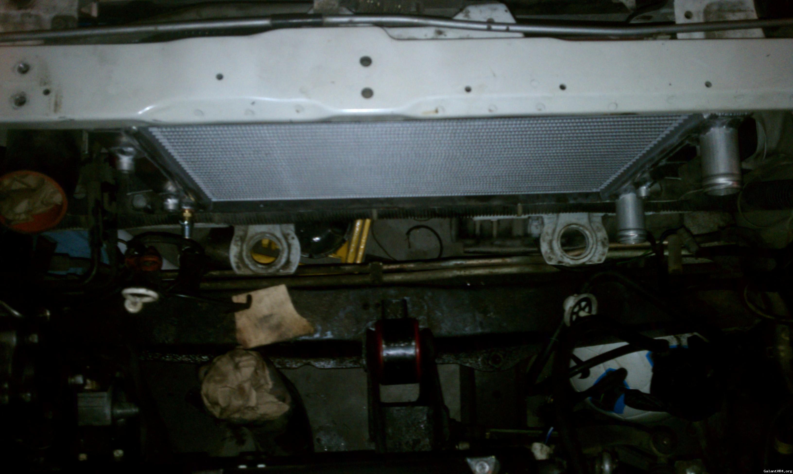

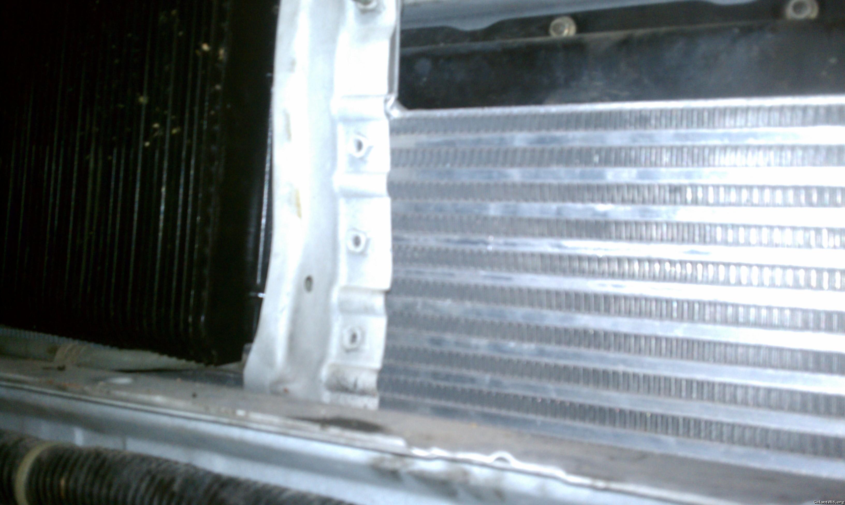

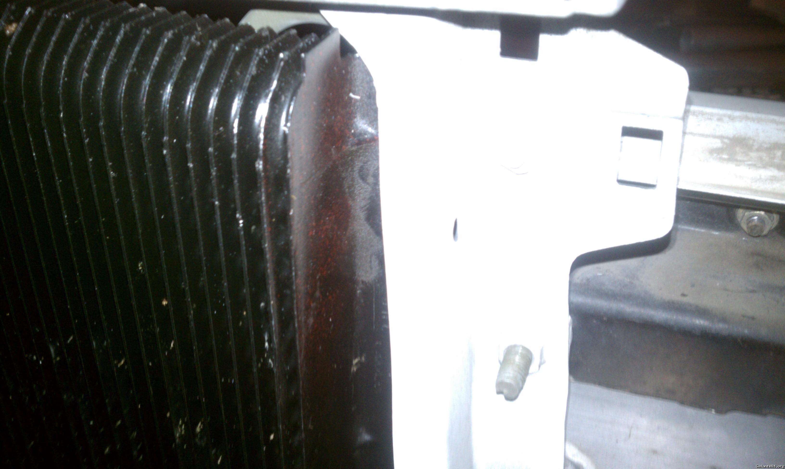

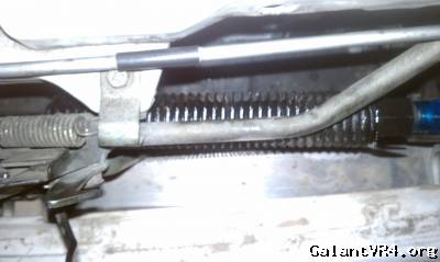

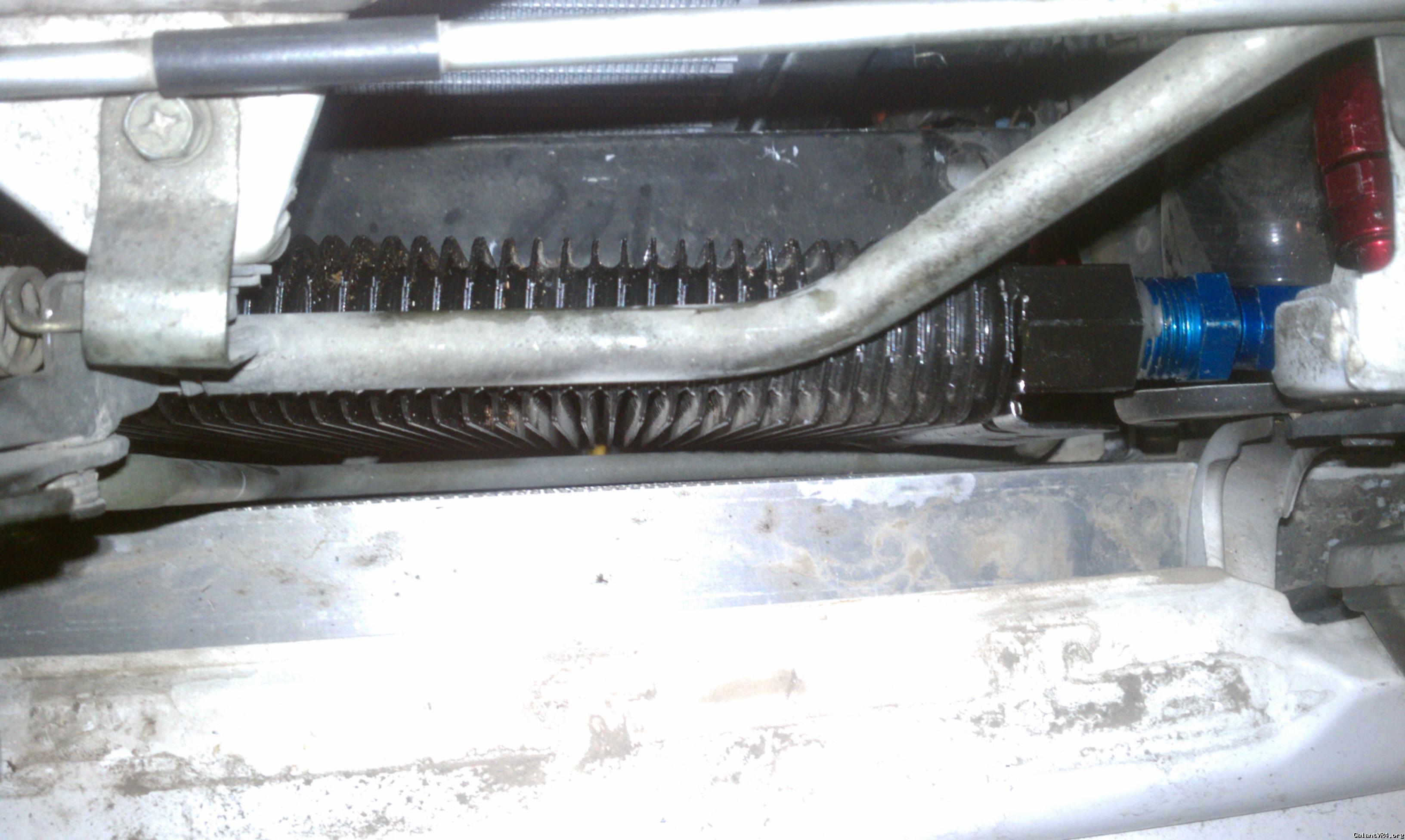

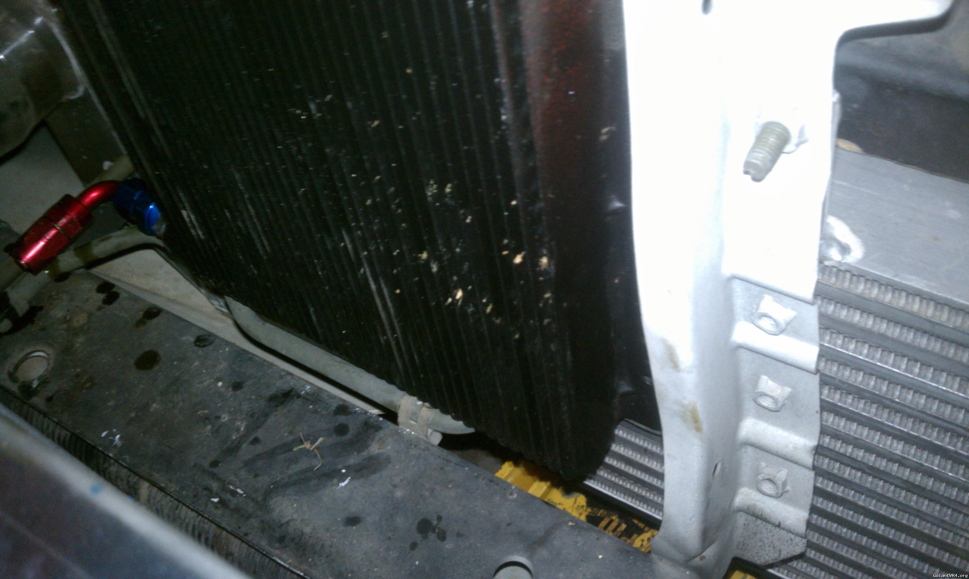

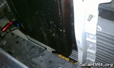

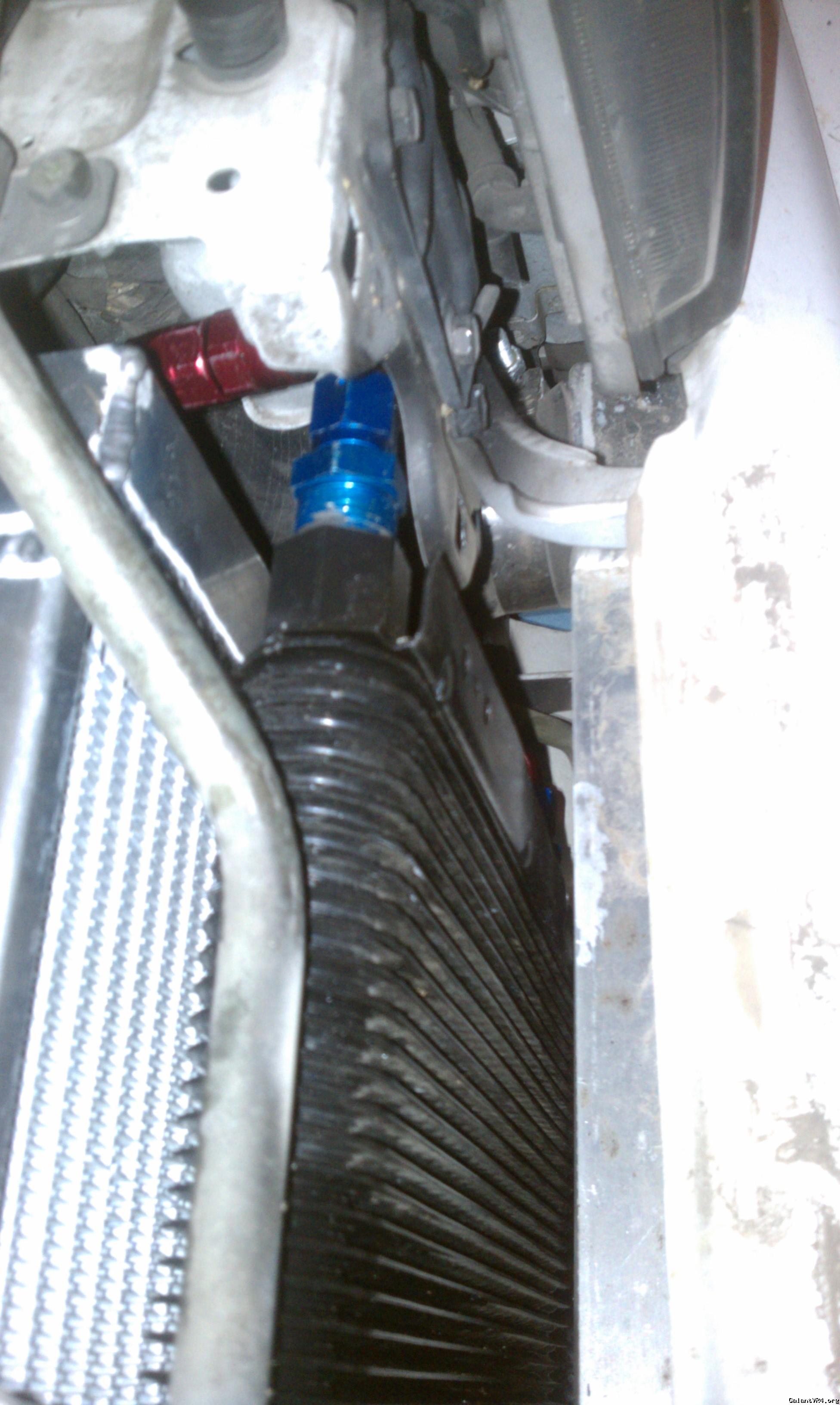

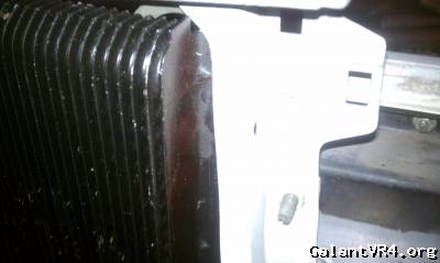

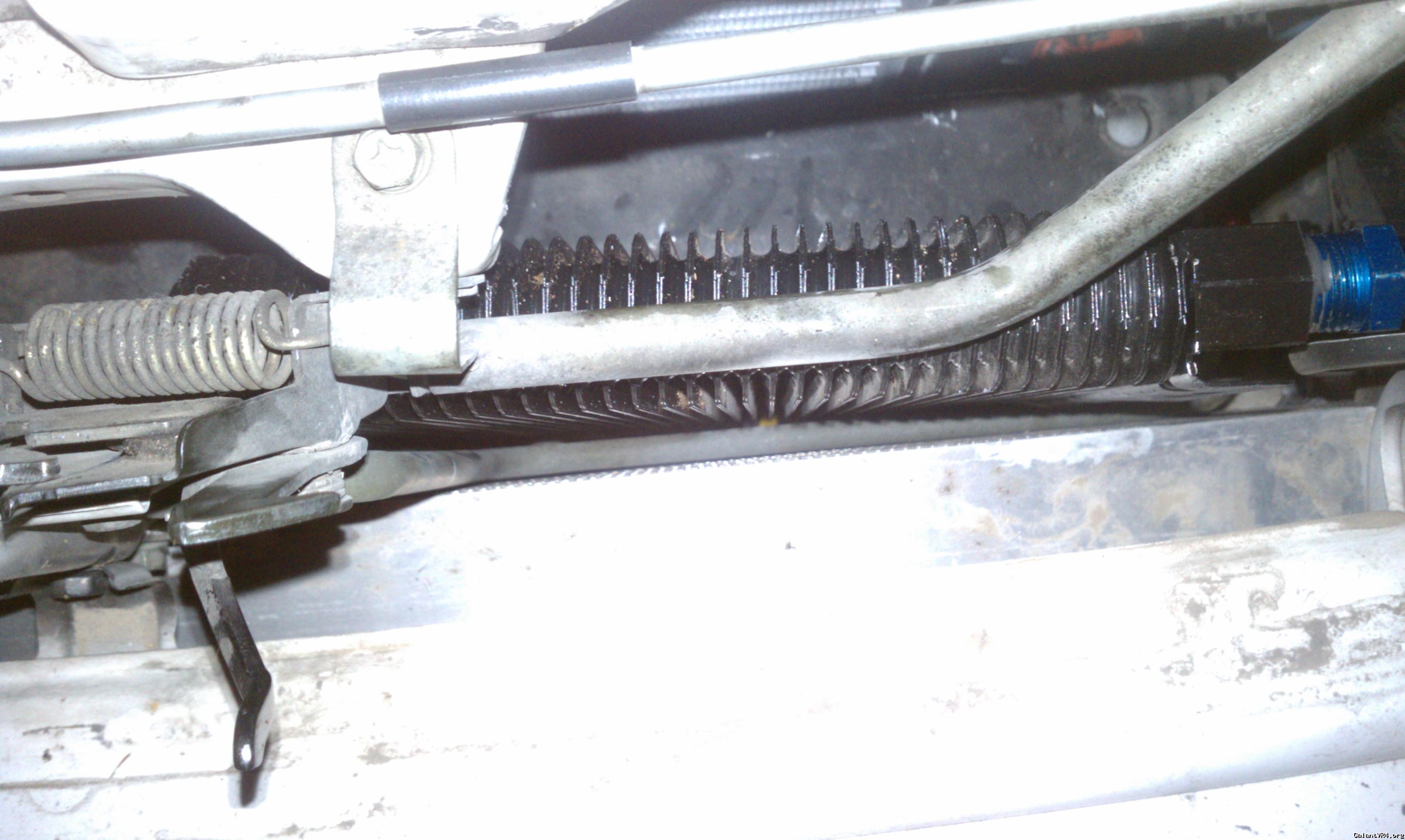

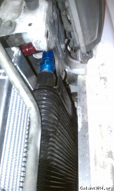

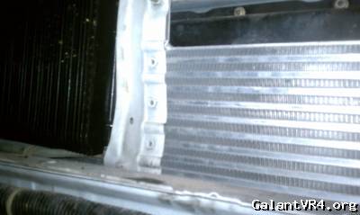

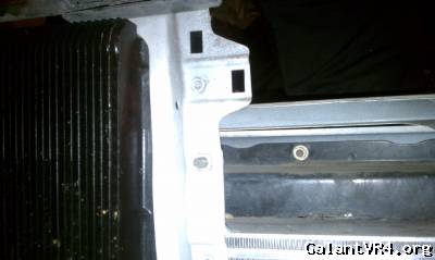

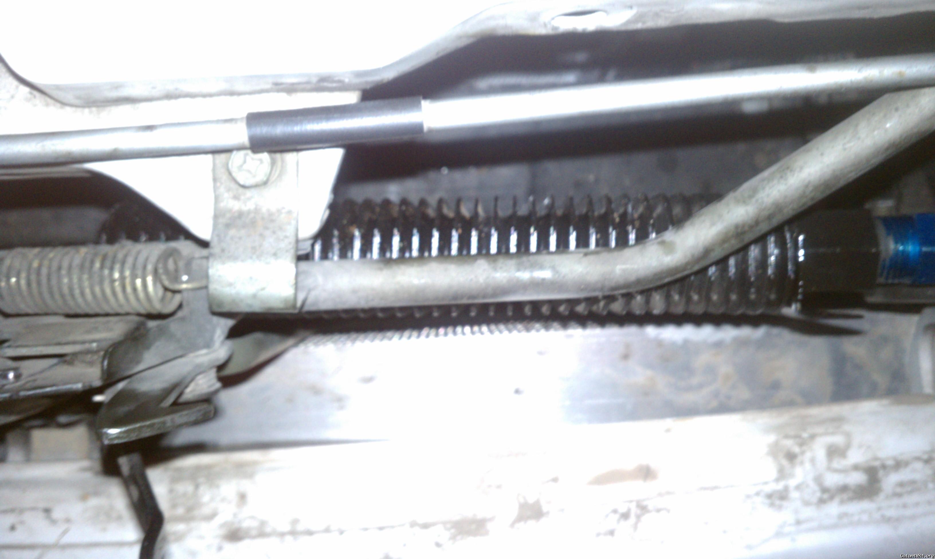

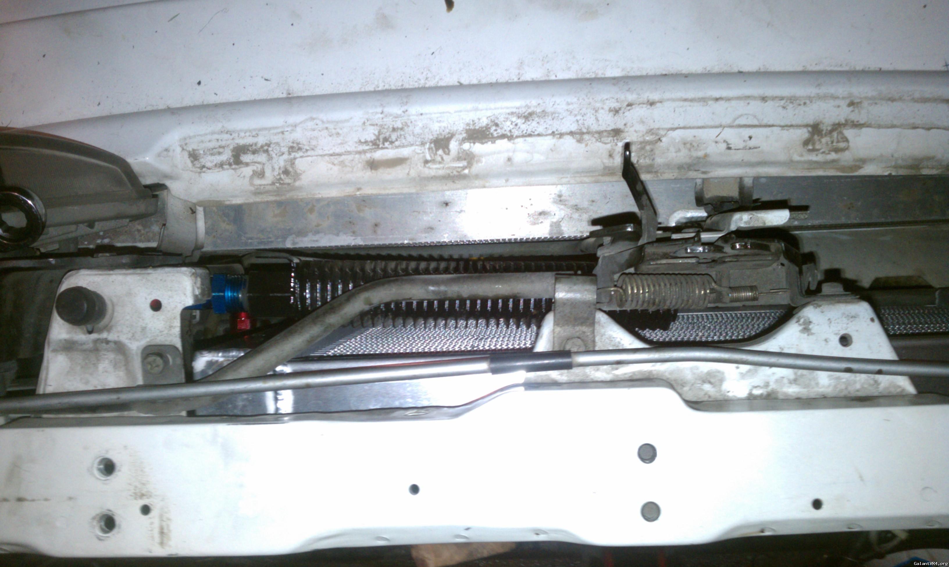

Hey I'm trying to figure out where to put my oil cooler at. The core measures 11"x8.25". I'm trying to put it between my intercooler and my unmounted scirocco radiator. My concern is that at that location it's going to harm airflow through the intercooler because of how the oil cooler is designed. If I put it there, there would not be much space between the intercooler, oil cooler, and radiator. Main issue I'm seeing is that the B&M oil cooler's fins aren't straight through, the air has passages in two different directions, approximately 45* angles off of straight through.
Also, 4"x8.25"(just over 1/3 of surface area) of the cooler would not get straight air due to the bumper.
Will this location work? Any advice is appreciated. At this point, this seems like the only location I can use.
That is a huge core for an oil cooler. The fact that 1/3 of that would be covered by the bumper is not at all a concern.

Just remember that you will need to fill the engine up with more oil now, since the cooler is above the oil pan and it will drain back down in. Decent spot though.

Alright sounds good. Thank for the help, I'll leave it there then.
