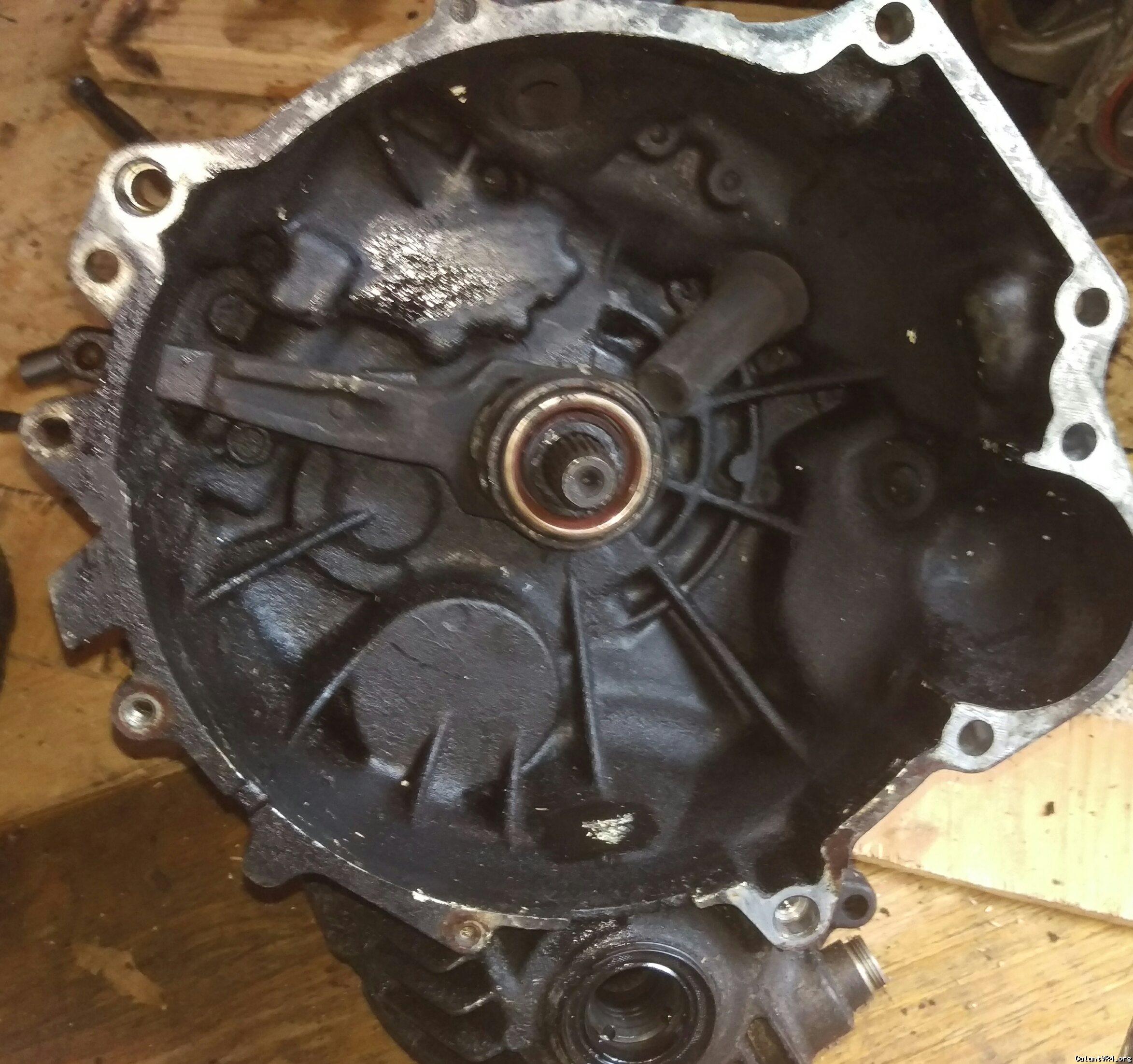

So close yet:
When bolted together the clutch hits this hump where the little white triangle is in the picture.
Going to open my gst trans to inspect that and will add an awd 5th gear while I'm in there. Hope the gearing doesn't feel too slow in nt form.
