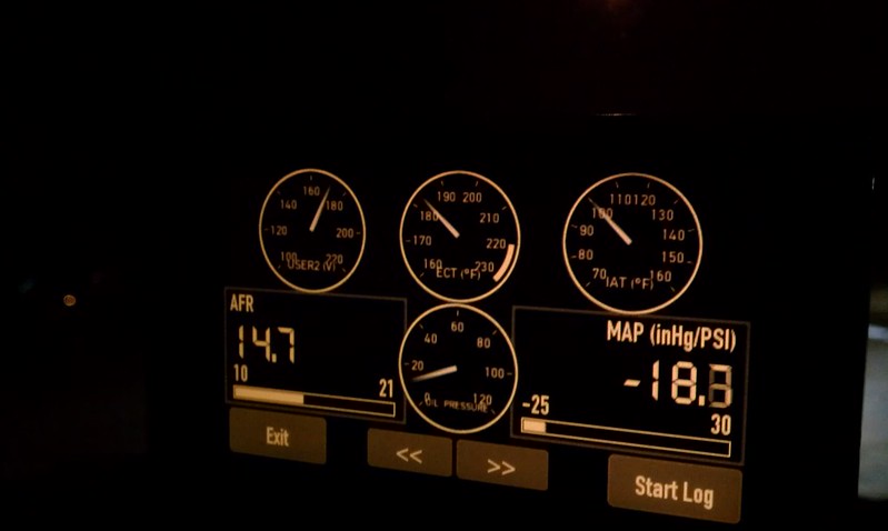

^Sounds about right to me. If you are worried about the integrity of the gauge i suppose you could hook it up to a compressor with a regulator/gauge to get a rough idea of its health.
I've got the display for my MAP sensor setup to read to the tenth. It has pretty good resolution, and as a result, it's never sitting still.
